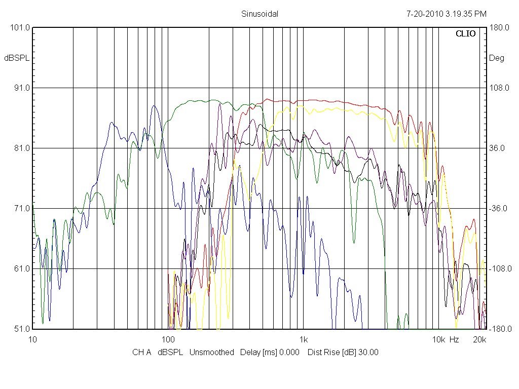

Looking at the Satori MW19TX-8 vs. Visaton B200 pdfs
Wow. This gives clues as to the test set-up and preferences, and how well it might compare to my/your own "use cases".
The Satori obviously falls into the niche "we've given you jumbo Xmax at great cost so use it!"
While the B200 is the complete opposite, and looks like an underhung unicorn with its 4mm coil vs 8mm magnet gap.
That's not to doubt the Satori. We're just not dealing with compact 7" bookshelf speakers delivering 8mm of slamming bass. And FWIW, the analysis of the physics seems pretty accurate at a glance. The Satori has multiple opportunities for reflections to bounce around between the cone, the dome glued on top, and the soft-yet-low-damping rubber surround. Whereas the Visaton seems to do things in a more classical manner, but with other likely costs (large box for soft cushioning, low power, low max bass capability, etc.)

This raw response of a 70-90 years old midhorn + driver combo (in red) is hard to beat:
