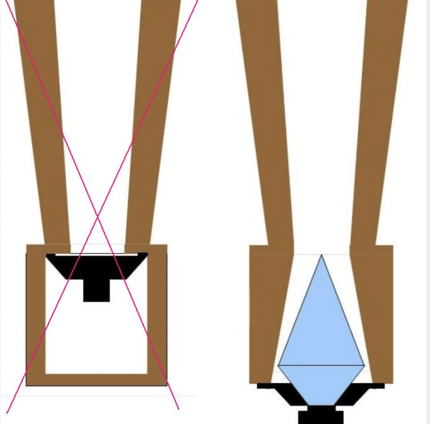

Removing the dust cap and attaching a cork is an ok idea as it would reduce the mass of the cone further assuming it isn't causing friction during playback. In addition, if horn loading a driver, in the interest of producing a more "laminar" "directive" "non-turbulent" signal, such a phase plug could be optimized like this:

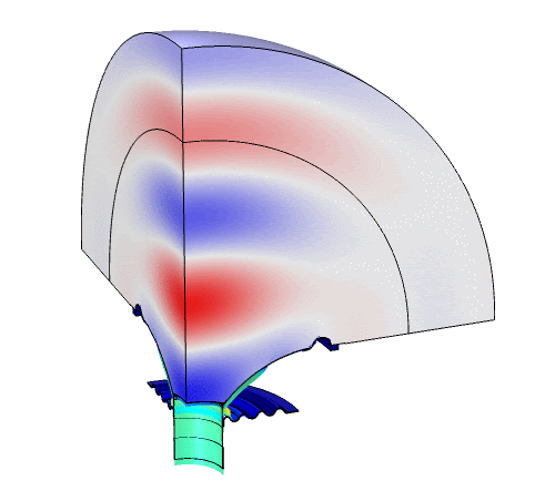

FWIW, the bending surface of soft cones is very unlikely to be well-matched to the speed of sound in air, leading to odd propagation patterns, such as a virtual sound source that is smeared out in the z-axis in front of or behind the speaker. This effect may be desireable, as it may make echoes (and psychoacoustic localisation effects) less 'sharp'. This also may give a hint as to the source of the "paper cone sound" vs "metal cone cound", going beyond just EQ settings.
