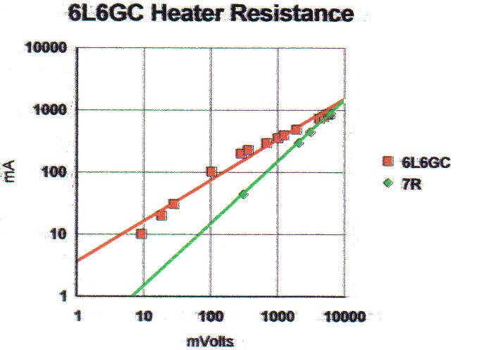

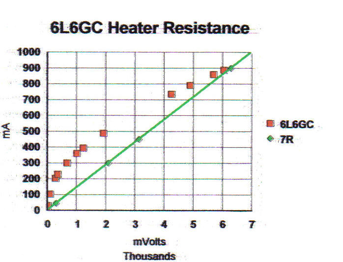

And here it is compared to a 7R resister, done on a much earlier spreadsheet,There is also the issue of the positive temperature coefficient of the resistance of the heater.
not MS Excel. Think I was curious enough 20 yrs ago to run this. In general tube
heater resistance of several different types seemed to vary about 10X from cold to hot.

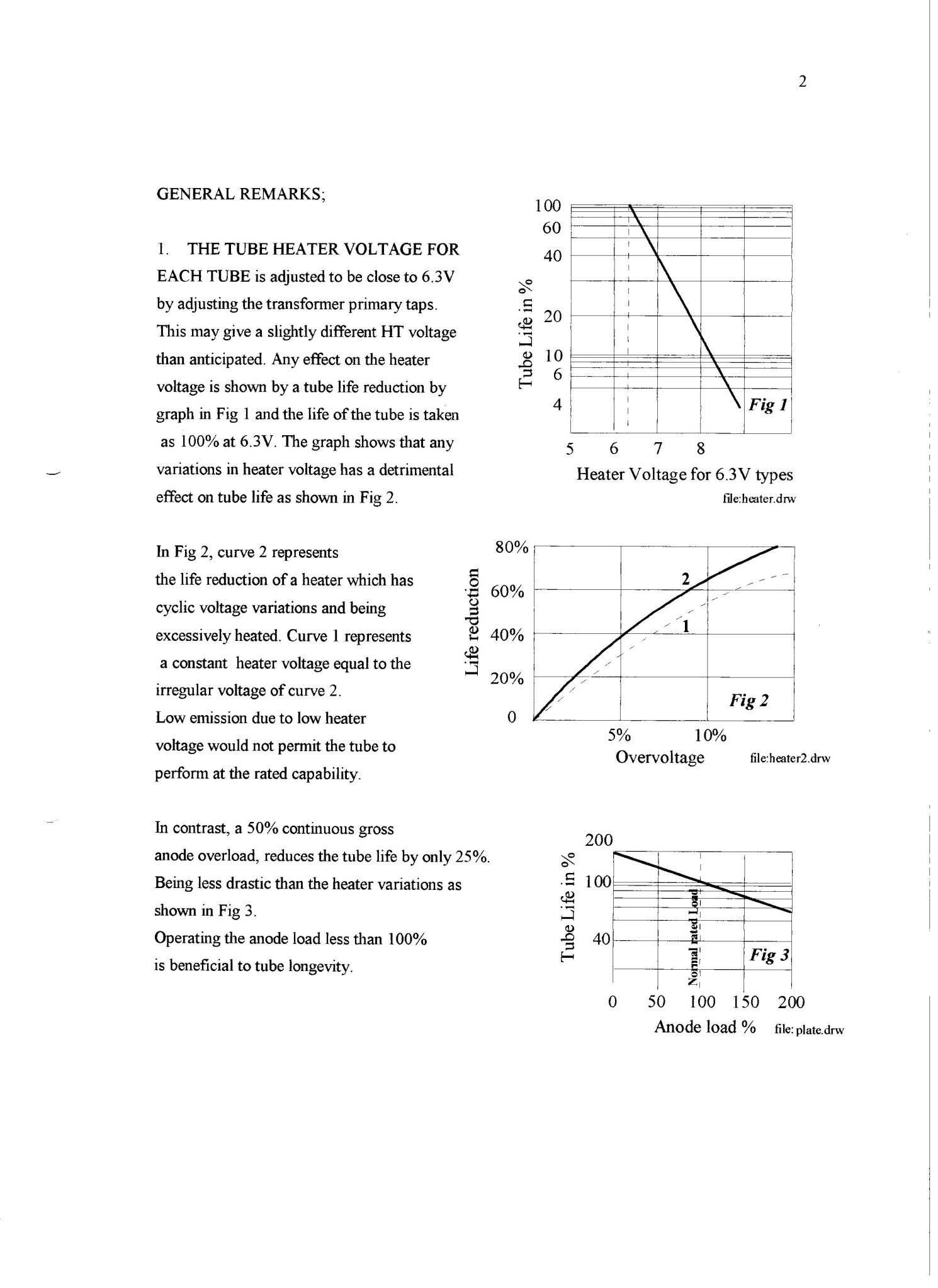

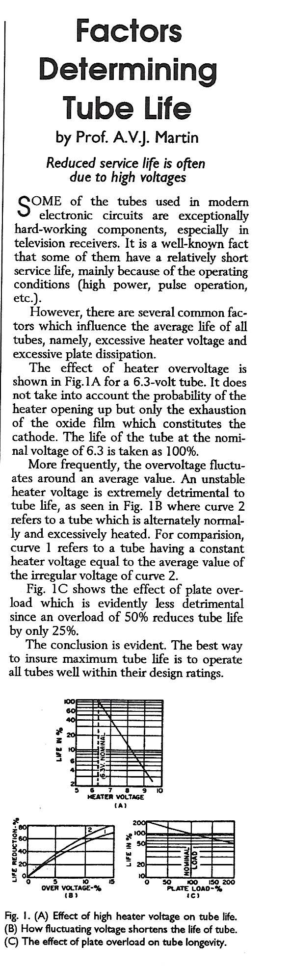

Although the Radiotron Hd/Bk 4th ed does mention near the beginning a description on voltage variations on tube life, it doesn´t provide any graphs. The graphic model I dug out nearly 30 yrs ago highlights the varying heater voltage on tube life, but the variation of anode load is not nearly so damaging .My approach with AC transformers is to have multiple incremental taps on the primary to deal with this.

very good advice - thank you very much. This is from page 111 of this magazine:
https://worldradiohistory.com/Archive-Radio-News/50s/Radio-News-1957-07-R.pdf
