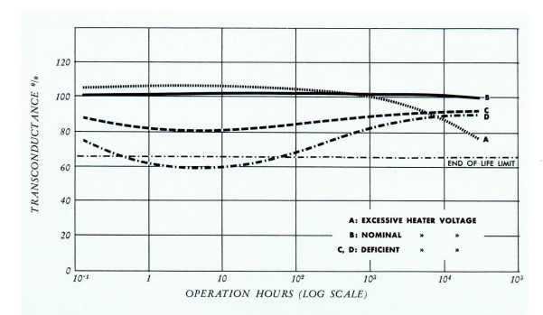

Although the Radiotron Hd/Bk 4th ed does mention near the beginning a description on voltage variations on tube life, it doesn´t provide any graphs. The graphic model I dug out nearly 30 yrs ago highlights the varying heater voltage on tube life, but the variation of anode load is not nearly so damaging .My approach with AC transformers is to have multiple incremental taps on the primary to deal with this.
However, the real problem in the early TV days was the series heaters using a ballast baretter with no input transformer was the worst of all conditions. No isolated chassis to the user, it was also mighty dangerous.
With low impedance european mains networks the C speed utility switchboard relays would immediately flip out with the slow (T) fuse approach. In my power amps of 500W upwards, on the primary side I always use a relay switching out a ballast resistor after 5-7 secs. This enables a fuse rating far more appropriate to the actual power.
