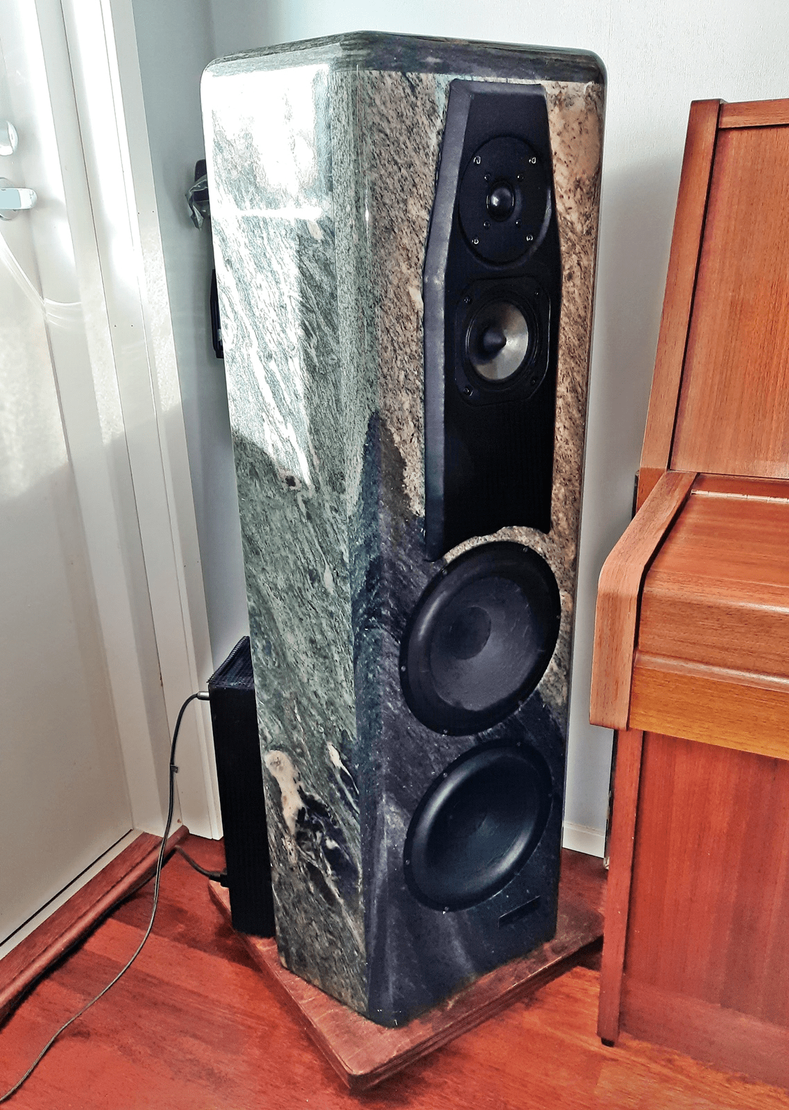

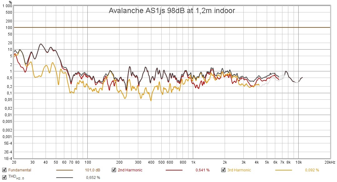

Very similar looking to my piano. And mine gets in the way of my speakers as well 😀2x ScanSpeak 21W sealed, mated with Audax HM100 and SB 26STAC and Hypex FA123 here. Plenty of juice...

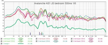

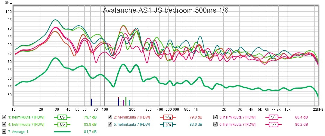

Speakers are in bedroom, better placement is impossible but this is my seondary set.

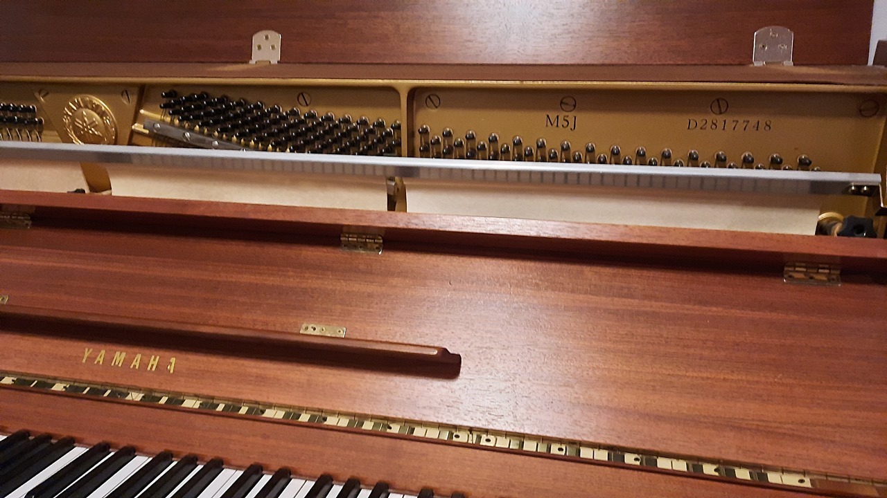

Ours is M5J (starter piano, smallest model) https://markgoodwinpianos.co.uk/yamaha/yamaha-m5j-upright-piano

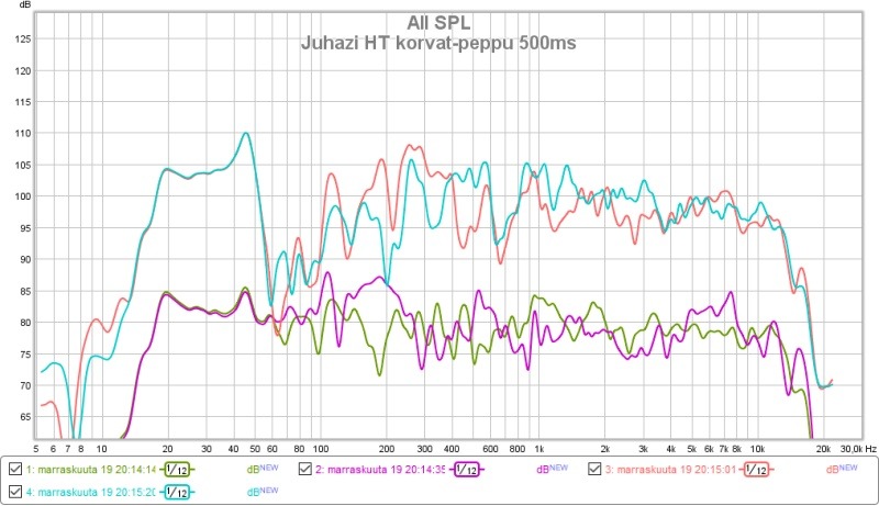

Back to topic... Actually I think that 8" long throw low distortion woofer is something that hifi needs, basic stuff! A 6,5" simply has so much smaller piston area, even high excursion can't compensate it.
8" is rather versatile, can be used in 2-way, 3-way single, doublet, triplet. Sealed box gives very nice low bass with EQ and lots of power that are piece of cake nowdays. In 3-way systems woofer's upper end resonances and directivity are not a problem, 10-15" low Fs woofers are even better, but require wider and larger boxes that most people don't want in their rooms - at least in Europe.
Digitalthor obviously has BR tuning for his 2x8" woofers? With room gain and a bit of EQ, a sealed box 10-12" or 2x8" goes down to 15Hz with moderate distortion. Power requirement for hifi is not terrible, I use 125-200W rated classD Ncore or ICEPower modules. In my HT I have 2x15" sealed with Hypex DS and minidsp and yes, it can play even louder with low distortion(DS has built-in highpass at 12Hz!
