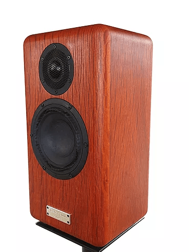

March Audio Sointuva speakers are available by order from Australia. A large bookshelf type enclosure.
Several Hypex Ncore-based amps and a dac available as well!
https://www.marchaudio.com/sointuva-purifi-speaker

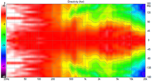

6,5" Purifi woofer with two Purifi BR units, and BliesMa 35mm tweeter, exceptionally good directivity and low distortion for a 2-way unit. Check Erin's homepage for the upcoming Klippel NFS test and review!
And the designer is certainly not a socpuppet!

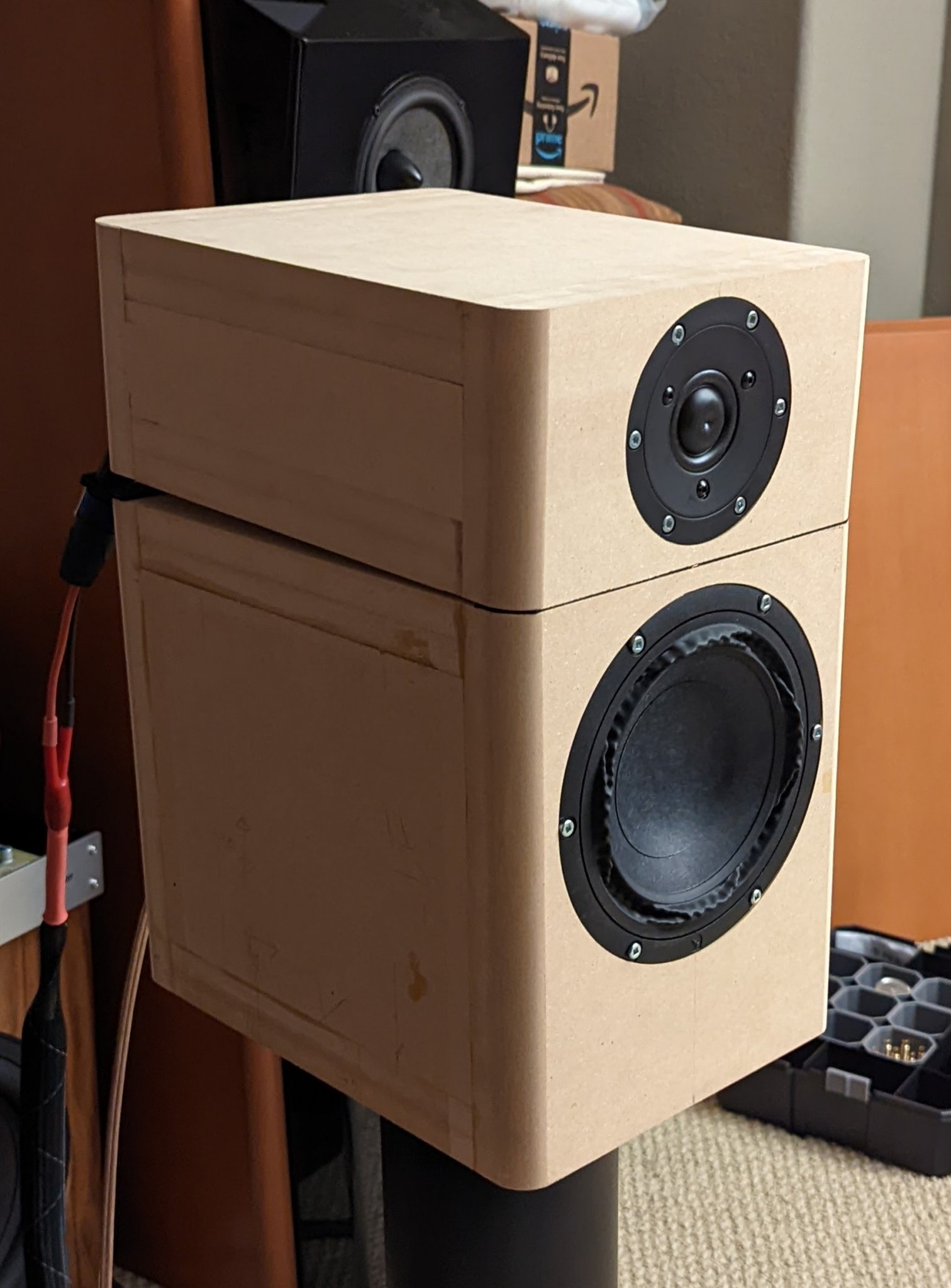

Did the sockpuppet account drive away Irisbo? I’m curious because I ended up returning my pair of PTT6.5W drivers to Meniscus for a credit towards a pair of PTT6.5M drivers (whenever they arrive) which would better suit my needs. The goal is a pair of two-way monitors using the Purifis and a pair of Raal 70-20XR ribbon tweeters I purchased in the swap meet forum. I’m fine taking my time with this project as I am already up to my ears in amplifier, preamplifier and loudspeaker projects and I would also like to see how a waveguide might improve the Raal’s low frequency performance, possibly leading to crossing over to the forthcoming Purifi 8” midwoofer instead.

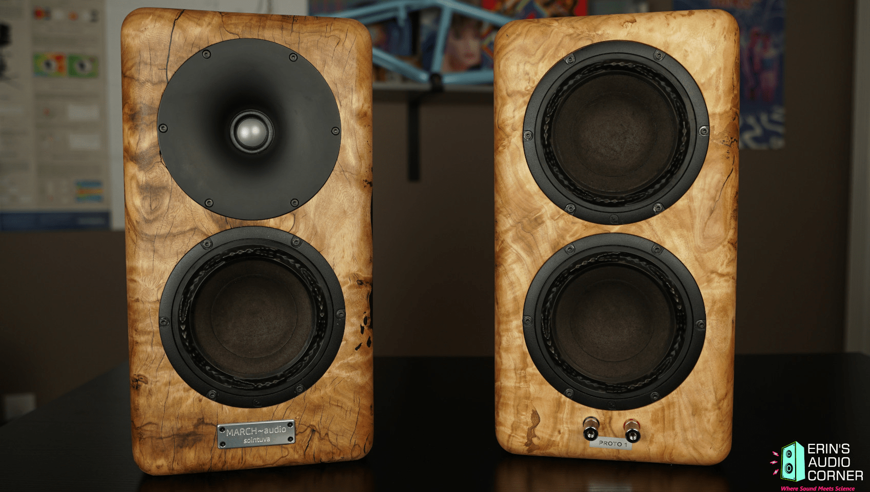

About waveguides, seems like Alan March ended up to using a waveguide!
https://www.erinsaudiocorner.com/loudspeakers/march_audio_sointuva/
Satori TW29BNWG-4 Beryllium Dome with wg. If I remember correctly, one reason was poor availability of BlieSMa

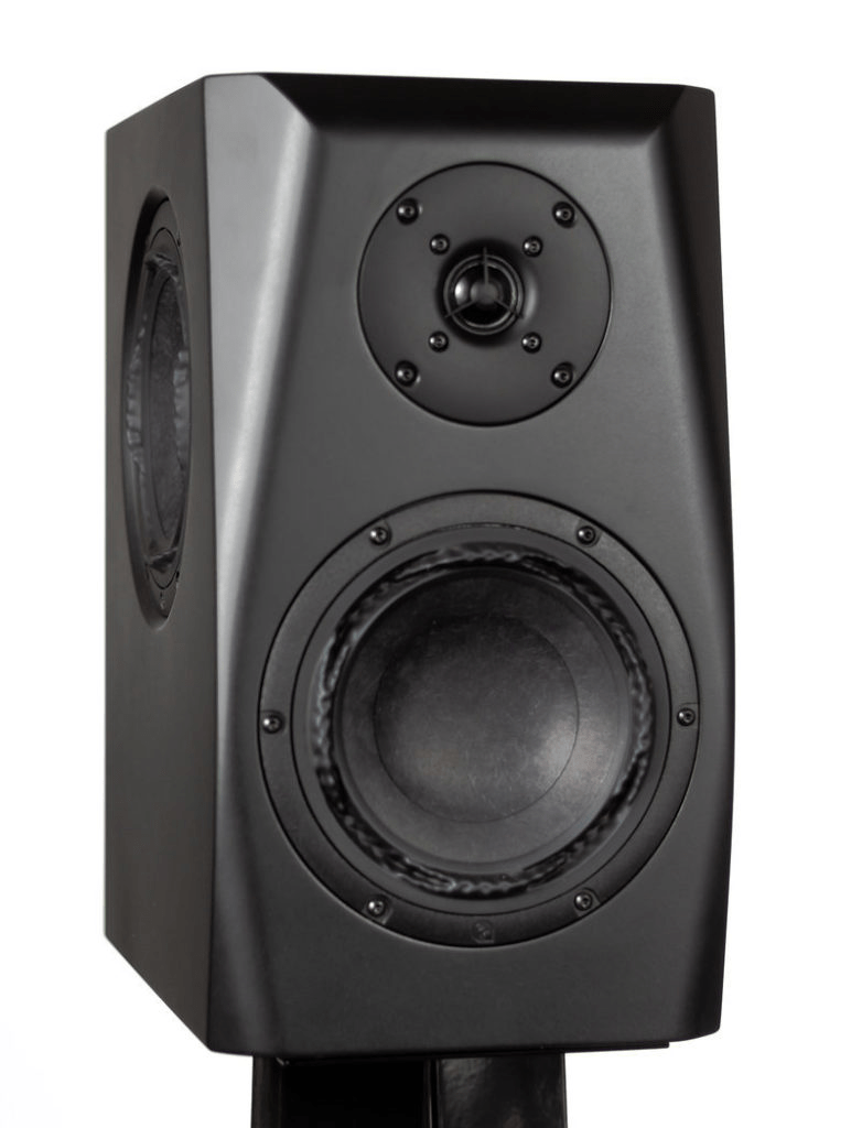

And here we have this passive design by kimmosto (VituixCAD guru) Passive 2-way with Purifi PR, SB26ADC tweeter

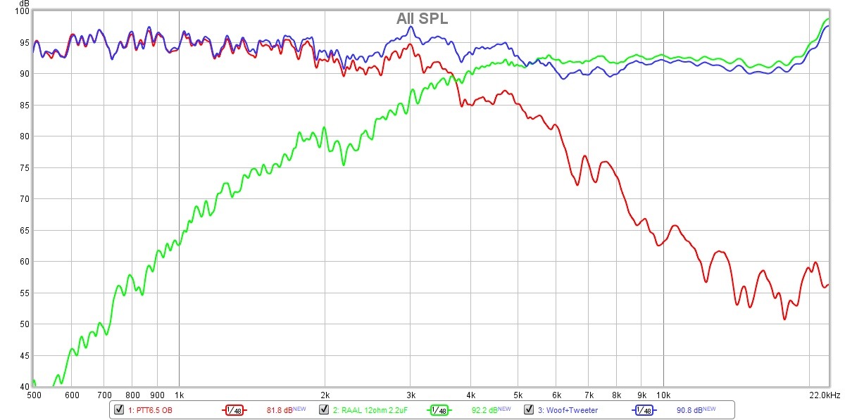

Nice choice! They are like made for each other. Here is a natural crossover with no filters or padding applied. Just the requisite 2.2uF series cap the RAAL needs as it cannot be DC connected.Did the sockpuppet account drive away Irisbo? I’m curious because I ended up returning my pair of PTT6.5W drivers to Meniscus for a credit towards a pair of PTT6.5M drivers (whenever they arrive) which would better suit my needs. The goal is a pair of two-way monitors using the Purifis and a pair of Raal 70-20XR ribbon tweeters I purchased in the swap meet forum. I’m fine taking my time with this project as I am already up to my ears in amplifier, preamplifier and loudspeaker projects and I would also like to see how a waveguide might improve the Raal’s low frequency performance, possibly leading to crossing over to the forthcoming Purifi 8” midwoofer instead.
