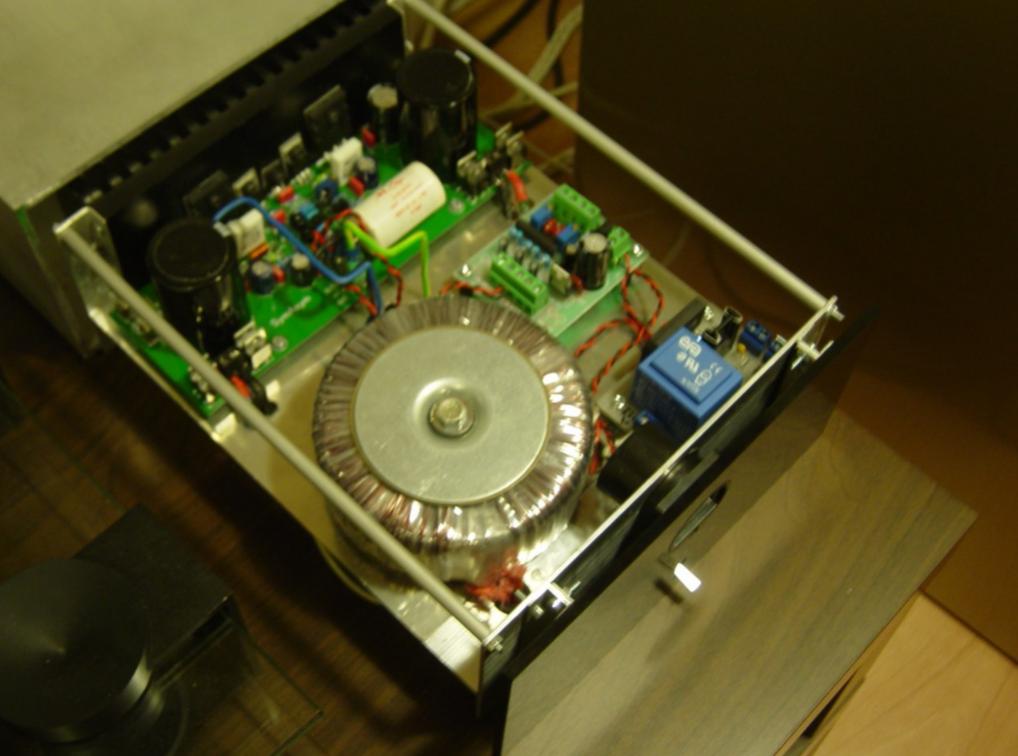

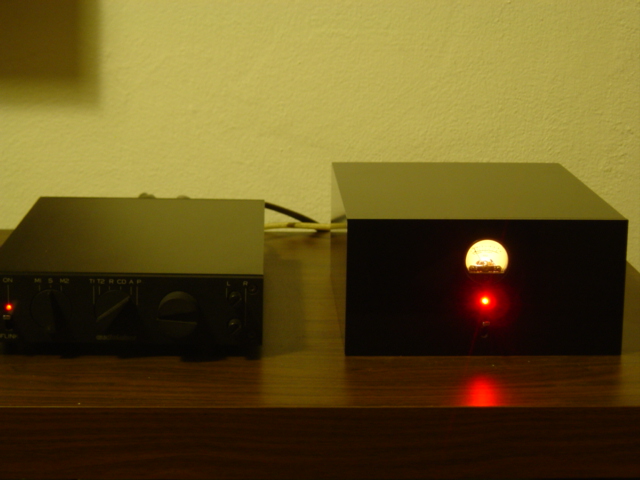

hi, first of all sorry about my english. im from argentina.
I successfully built the amplifier with the toshiba 2sc1943 and 2sc5200 transistors. originals and very difficult to find.
the sound is GREAT. te output power es very good. at least for my room. I've used it in some partys and birthdays but nothing proffesional. only for fun.
I want to thank the creator of such excellent design.
I uploaded some photos to rapidshare and a video of the amp.
the power supply has 4 transformers 12v to avoid space problems.
the voltage is stable at high current demand and themperature is ok.
there is a fan control system that turns on when the temperature exceeds the limit set by the preset and provides an histeresis.
and there is a stereo digital vumeter that uses the LM3915 and a peak detector circuit for better response, even in DOT mode.
here is the link to rapidshare.

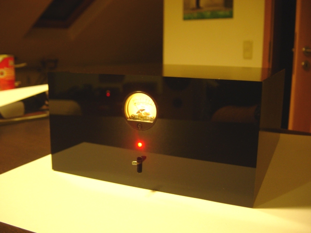

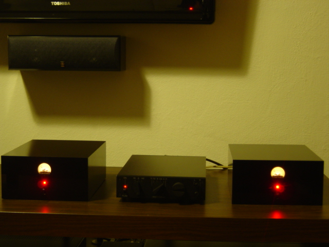

Here my finished SymAsym Monos black in black.Thomas
Congratulations, they look beautiful.

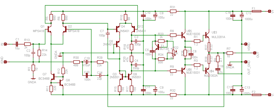

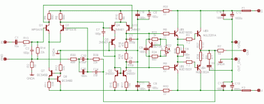

Ultimate scheme and PCB!
Hi all !
Very interesting and completely project!
I want to create an amplifier percent of this quality and I have little to enjoy its sound! It has a high quality DC-power supply Ucc=+/-36V/300W, so please rate it and makes the final schematic and PCB for this amplifier !
In the end, I ask if someone is able to describe the operation of this amplifier at a given schematic?
thanks and cherss!
P.S.
I expect a quick reply

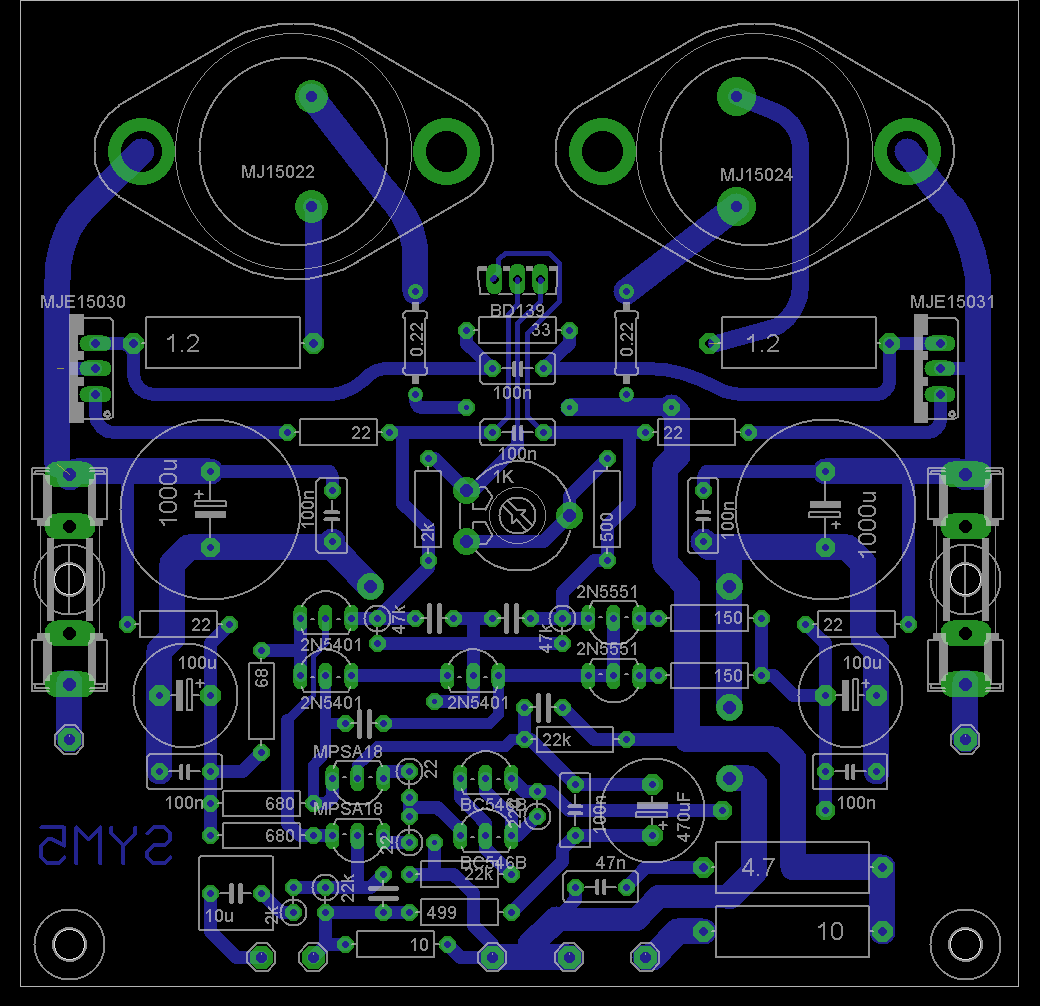

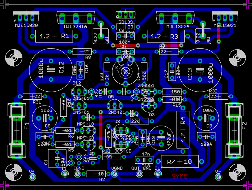

HiEvette,
are you thinking of something similar to this:
Best regards - Rudi_Ratlos
Complementary pair is MJ15024/MJ15025 and MJ15022/MJ15023!!!
Please see PCB (MJ15022/MJ15024)?!
I think the mistake.😕🙄
thanks
@Radio,
the design / layout shown in the picture above was made "quick and dirty", and I did not take care of the transistor types, names, ...
This layout:
http://h6.abload.de/img/untitledj7eu.jpg
is current and correct (has already been built by a lot of German DIY'ers).
I offer the PCBs in this group-buy:
http://www.diyaudio.com/forums/group-buys/187592-3-symasym.html
If you are interested: hurry up, please! I will close the group-buy today.

I am the author of this schematics (inspired and assisted by my Canadian friend Joseph).
The schematics that RADIO has shown in the SYMASYM-G PDF-document is of course the schematics of the TO-3 SYMASYM
that I am currently offering in the http://www.diyaudio.com/forums/group-buys/187592-3-symasym.html group buy.
I wonder where RADIO found it!

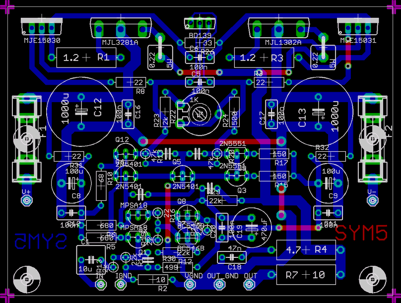

Hi all!
Here's extremely PCB for this audio amplifier with Ucc=+/-36Vdc!
The second PCB (Figure 2) has a fault, instead MJ15024 should be MJ15023 !
cheers !!
P.S.
Alex mm, if you are able to help around the design of the PCB, I know that you can do even better!
cheers !!

Two questions, Radio:
1) Who do you address with "Alex mm" ?
2) what do you want? There have been several GB, there are different version (from user AAK) which have been built as well, so what do you want??
