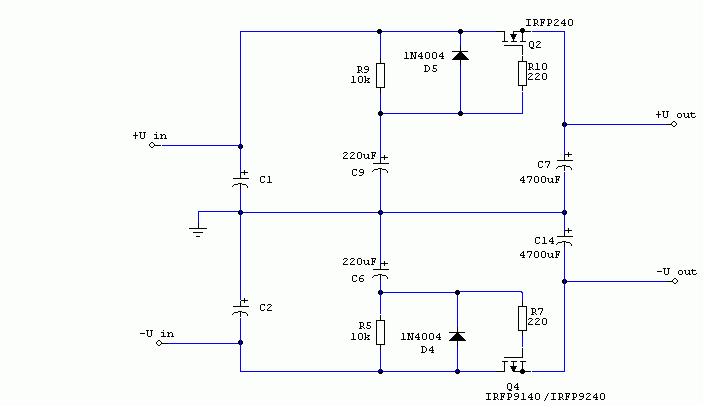

Hello Aleksandar,
a good, simple and cost effective way around it is to use a capacitance multiplier (see attached picture). You'll lose 4V (to get +/-38V) and the sound of your amp will benefit too.
The schematic shows a circuit needed for one channel. MOSFETs can be bought at kelco.rs
What's the value of C1-2 and voltage?
C1=C2=10000uF
Cap's voltage rating is chosen upon your transformer's secondaries' voltages. For 26V AC I'd use 40V caps.
