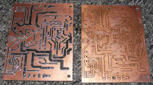

This is how my boards look like (i have pre-tinned the tracks on the one at the left, the second one is covered with flux and I'll do the same to make soldering easier). As you can see they have some sort of a ground plane (not actually connected to IGND or VGND but it'll connect to chassis GND through the mounting screws). Do you think this ground plane will be OK or will it give me problems? Should I try to get rid of it? Maybe Ferric Chloride could wipe it off, but first I have to check if it doesn't corrode the solder too...
Personally, I wouldn't recommend using those boards as they stand. The "standard" PCB layout is a proven design and known to work well.
a) Track clearance with respect to the ground plane is fairly minimal and the risk of shorts would be high because of this. The supply rails are particularly vulnerable.
b) There will be an increase in the capacitance to ground at most points of the circuit (compared to a board without a ground plane). This may affect performance and stability.
Steve
I have found that with exception of the inverting input, most Stable Audio Amp designs perform quite well with a ground plane, In fact i use one on Both sides of the board except in the area around the inverting Input. Since you already have the PC Board finished why not check for shorts and remove and plane from around the inverting input, then populate. Some sort of current Limiting would be nice upon 1st powering it up I often use a 100 watt lamp in series with the AC side for this.

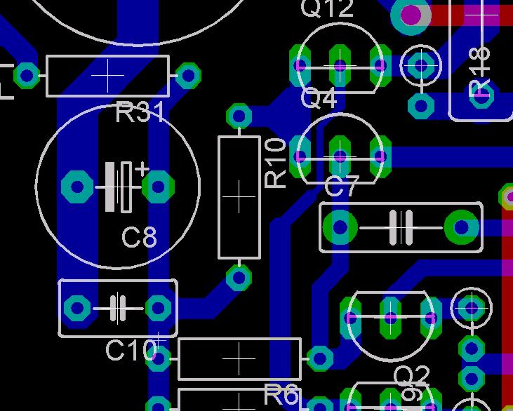

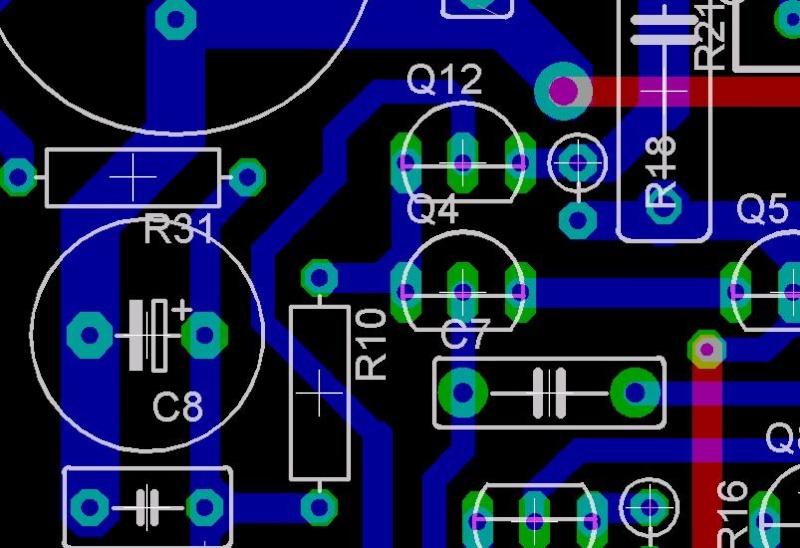

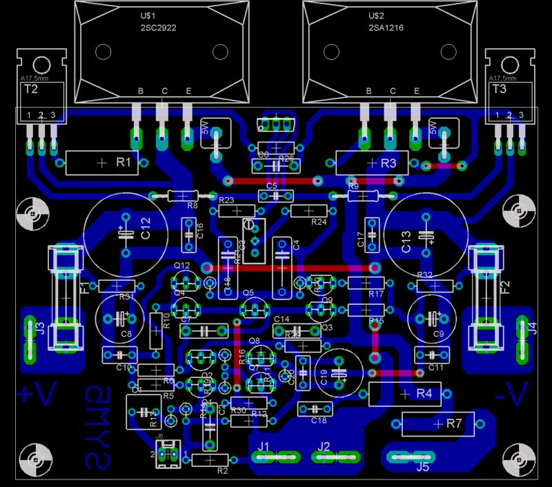

I manage to swap original layout to MT200 power transitor layout. I want to etch my self board. To make it more easy i change some route that was going between small T92 transitor. I shaown you the original layout and then my modification. Can somebody tell me if my modification will impact final result? Was there any raison forthe original layout with a so thin trace that goes between TO92 pad (more deficult to etch, possibility of shortcurt...).
Here is the original
My modification
Here is the my symasym version (little changes in fact)

Hi Marc,
I like the rerouting of that trace. Interesting use of the other output transistors. These are also very good and should work well. Expect to play with the compensation capacitor a little. That goes for everyone who either changes the layout or drivers and / or output transistors.

As currentflow pointed out, use them, but be sure to eliminate any possible short circuits. Be ruthless and remove anything that may possibly get too close for comfort. You must remove all flux in order to examine your connections. Also, as ppl pointed out, capacitance around the inverting input is most unwelcome. This could cause the amp to oscillate and fail.

Hi Carlos, I know that, and that' why i asked about my modification since i don't want tro degrade the grate job that do Michael Bittner. I want to build two channels for stereo set-up and swap them after in a 5ch configuration form suround. LCR would be brother of Quasi (a another great design).

I read in this topic (if i'm not wrong) that the original layout and caps value is ok for 2SC2922/2SA1216 2SA1837/2SC4793 without any changes.

Thanks for your input, currentflow and anatech. I completed both boards a month ago, after stripping the groundplane completely. It came off surprisingly easy, using a sharp cutter and a pair of tweezers.
Here's a picture of how the thing looks like at the moment. But the sound, oh the sound, it's so "alive" and enveloping that I already ordered a cool case from an Italian outfit 😀, and that case will be stuffed with lots of other goodies besides the amp boards and power supply. But more on that later, when it'll be finished. Here it is, you can laugh of course, but it's just a testbed:
