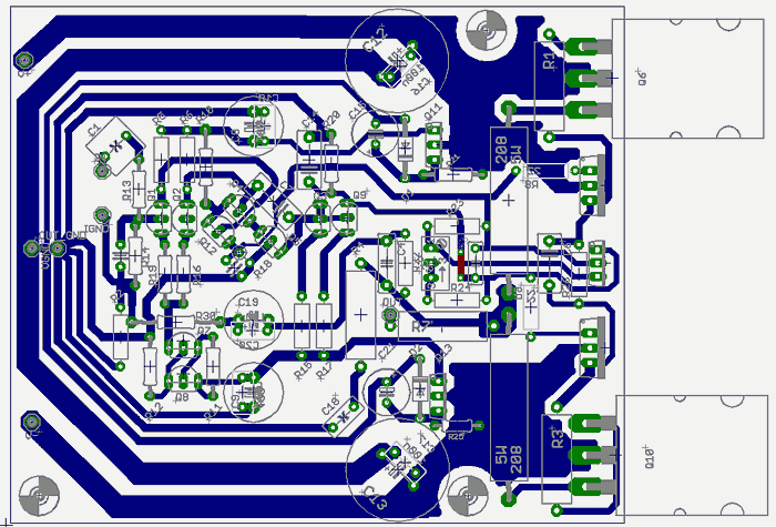

Nordic said:![]()
I think this images shows the traces better...
Just noticed a small trace missing... allready fixed on my files.
I understand the intention behind the separated ground tracks, but is there not a risk of creating inductance with all those long tracks? In particular, C12 and C13 lose their benefit of being close to the output devices because of this.
Maybe better to flood-fill in a big C shape. Or better still, use a double-sided board with the topside as a ground plane.
