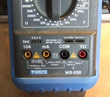

How do you do that hfe testing??🙄I've found that matches with the hFE feature on your DMM line up pretty good with "real life".

Ryssen said:How do you do that hfe testing??🙄
If you look middle left in the pic below you can see the sockets in the meter. You just set the DMM range for hFE testing, then plug in the component, (taking care about orientation), and the hFE is shown on the meter. Give it a couple of seconds to stabilse, then pull the trannie and write the value on the side. It takes about ten seconds per component once you get going.
Yes my DMM have that hfe thing,😎 always wondered what it was for.😀 (what a dumbass I am)🙄 Is it all that is needed for matching?what about the output transistors?
