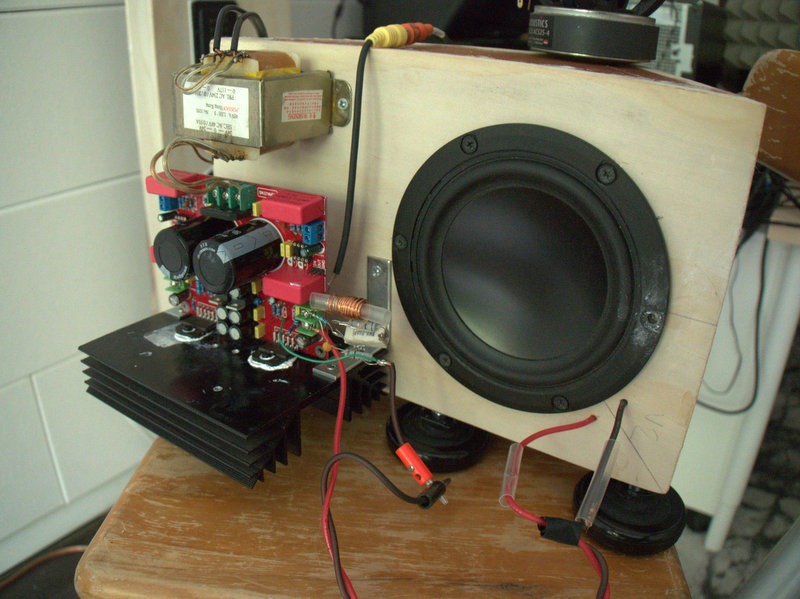

As a continuation of work by Esa Merilainen and Pascal Brunet, as well as my previous work, an approach with a deeper feedback circuitry has been tested. The deeper feedback indeed lowers harmonic distortions by 20dB and more, including the most stubborn 3rd harmonic, in a somewhat unexpected (by me) way.
The driver impedance lump was modelled as Zeq = (L+RDC)||C||Rres:
Contrary to the statements of previous researchers, it was found that the p grade of Lp is neither 0.5 nor 0.55 but varies from driver to driver, from 0.6 to 1.0.
A reasonable amount of RF care was taken. The amplifier is stable. Measurements were taken by an 12dBA AudioTechnika 4040(Or 2020?) cardiod condenser microphone calibrated by ECM8000 calibrated by AZ8930, at 0.5m from the cone, while being adjusted to 1m loudness (60..85 dB SPL), in a moderately damped living room (RT60 ~= 250ms for f>200Hz). In the signal processing, frequency resolution was traded off to benefit precision and dynamic range (i.e. the curves have been denoised). Dotted lines correspond to the resulting noise floor for the given harmonic and excitation levels. The curves are positioned on the originating frequency, i.e. they correspond to the frequency that produces the harmonic, rather than where it appears, and are properly normalized for the cone frequency response (FR).
Note that an open-air inductor serves as an antenna and gets lots of interference, even after turning most of the switching PSUs in the vicinity off. In a real product, the inductor must be shielded.
If seen as necessary, the f<2Fs distortions can be dealt with by motion feedback. However, here the focus of the efforts is on the midrange drivers. Here, you do not need to worry about Fs lump.
90 dB @ 1m is as loud as SIG150 (sensitivity 91.1 dB @ 2.83V / 1m) can get without producing obnoxious distortions, both voltage and current drive. Sig150 is not capable of producing clean sound for f < 2*Fs, and multiple saturated resonances appear all the way through the passband, which is fairly typical for non-professional drivers.
The current sensing network is too sensitive to power and temperature variations. Thicker wire shall be used for the inductor and all resistors must be high-power rated. Satisfying the destruction limit is not sufficient distortion-wise.
It is not clear how far you can get with the current drive because you are limited by the cone distortions.
The drivers are implicitly optimized for voltage drive. The current-drive-optimized drivers may turn out to be quite different. It’s a terra incognita, for you to discover.
Waiting for the missing components to be shipped and delivered…
Copyright © Michael Zrull, 2024/09/19. All rights reserved. Released under GPL 3.0. I won't patent it nor restrict DIY by any means.

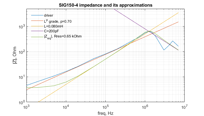

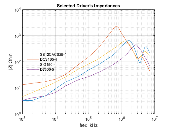

Measuring a driver impedance
A few drivers from different vendors have been measured using Feeltech FY3200S-20M generator and Rigol DHO802 oscilloscope.The driver impedance lump was modelled as Zeq = (L+RDC)||C||Rres:

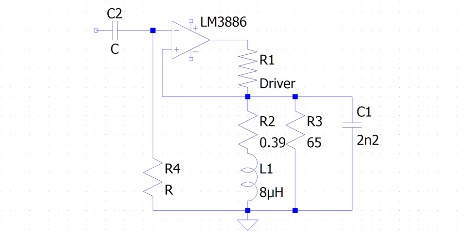

Feedback loop structure

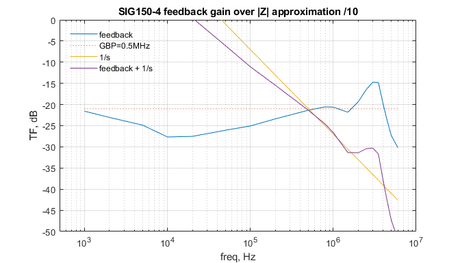

To start with, Dayton Audio SIG150-4 was used. An equivalent of 0.1*Zeq[SIG150] was used as a feedback discriminator, to get a voltage amplifier (LM3886, simplicity’s sake) with a gain in the range between 20 and 30dB. Of course, the feedback network cannot be universal. For SIG150-4:A reasonable amount of RF care was taken. The amplifier is stable. Measurements were taken by an 12dBA AudioTechnika 4040(Or 2020?) cardiod condenser microphone calibrated by ECM8000 calibrated by AZ8930, at 0.5m from the cone, while being adjusted to 1m loudness (60..85 dB SPL), in a moderately damped living room (RT60 ~= 250ms for f>200Hz). In the signal processing, frequency resolution was traded off to benefit precision and dynamic range (i.e. the curves have been denoised). Dotted lines correspond to the resulting noise floor for the given harmonic and excitation levels. The curves are positioned on the originating frequency, i.e. they correspond to the frequency that produces the harmonic, rather than where it appears, and are properly normalized for the cone frequency response (FR).

For LM3886, the depth of feedback is higher due to GBP=200kHz (46 dB on 1kHz). Most decent DIY Class A/B amplifiers have GBP over 1MHz. The depth of feedback can be improved by using second-degree astatizm and/or nested feedback. It is not entirely clear how to implement the current drive with non-self-oscillating Class D amplifiers efficiently.Note that an open-air inductor serves as an antenna and gets lots of interference, even after turning most of the switching PSUs in the vicinity off. In a real product, the inductor must be shielded.

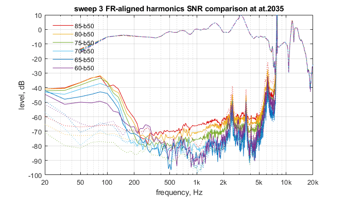

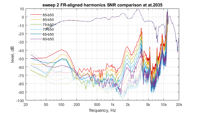

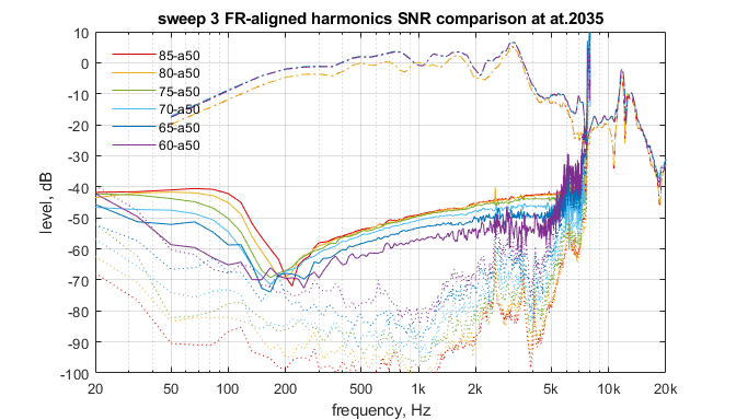

Could you elaborate on the difference between the 1st and 2nd graph of each group? Are graphs 2 and 4 normalised?
It also gives food for thought that AlNiCo magnets don't have that sharp transition between different material properties, so they would seem less prone to "grit" from magnetic snap-back effects. It motivates me to do something with electromagnets.
I'm curious about what happens at the glue line, where a typical ferrite ring connects to the iron ring. The iron seems like a "buffer zone" where the domains flex, but if the ferrite also flexes, it seems like there could be a technical case for aging and "burn in", as the magnet develops a second air-gap. Consider also that there is a gap there because of the glue thickness.The effect on Barkhausen noise (non-repeatable-in-details discretization of non-linear de/re-magnetization distortions) is most interesting for magnets that are never fully saturated because of the back current of the magnetizer and some domains are easier to flip than others.
D
Deleted member 375592
The first graph is the 2nd harmonics for the sine sweeps varying in level from 60 to 85 dB SPL, the second - of the 3rd harmonics.

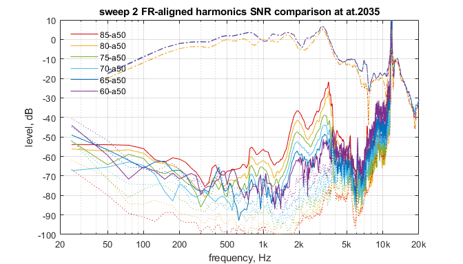

The current drive version appears to have 5dB more output around 100Hz, and 5dB less NFB, which could partly account for the difference in harmonics. I wonder what they did to optimise the driver to make it look like it 'prefers' voltage drive?

100Hz is about the Fs, so you have an increase in Q and therefore a bump in FR. The box is closed and well-damped by acoustic foam stuffed inside, so this 5dB increase is reasonable. The increase in harmonics is not explainable by any trivial theory, afaik, especially for the 3rd harmonics.

Are you sure that you don't have a drawing error in the amplifier schematic ? To me this looks more like an oscillator than an amp !
Regards
Charles
Regards
Charles
D
Yes, I am sure ... partially because it works as an amplifier. The driver has impedance ~10x of the sensing network.
And you don't think that both inputs are mixed-up in the diagram ?

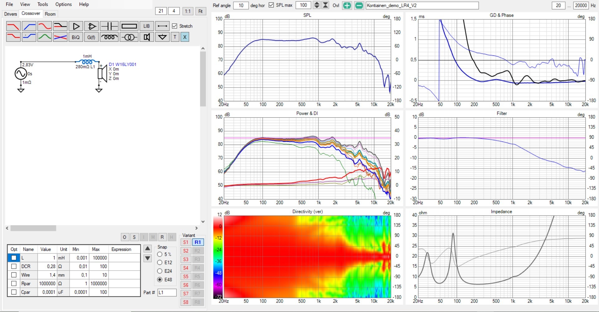

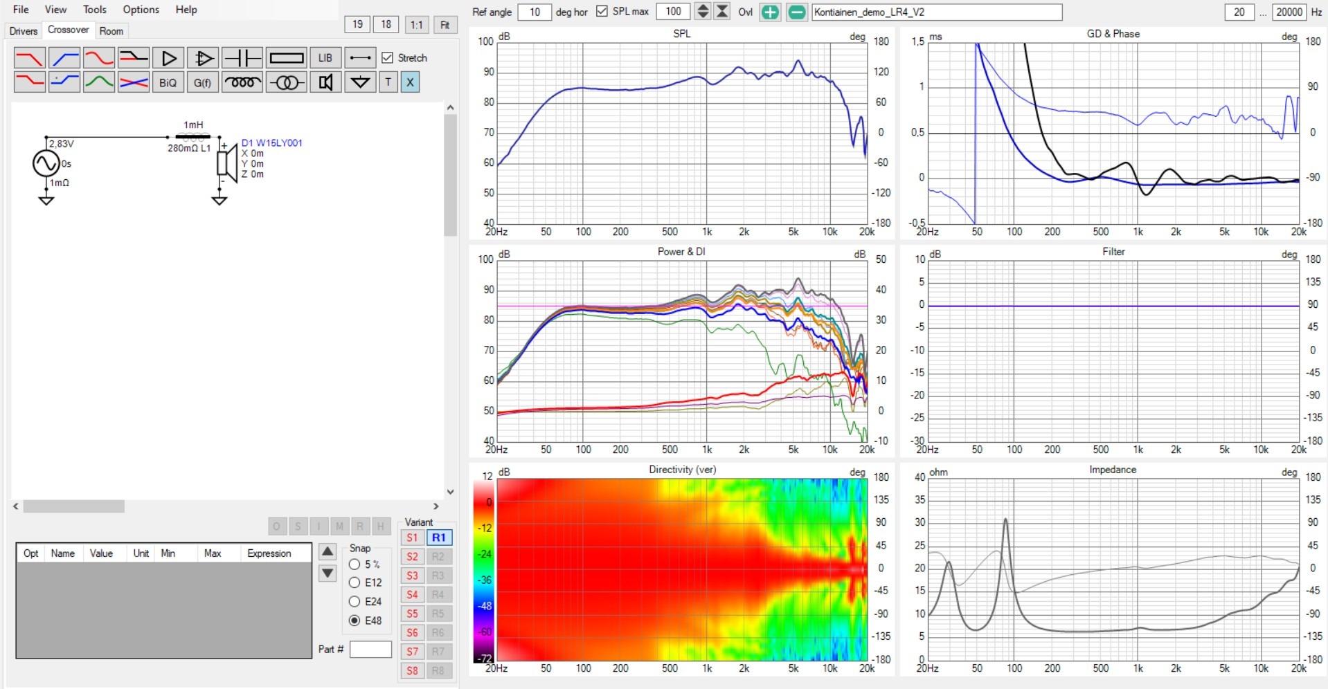

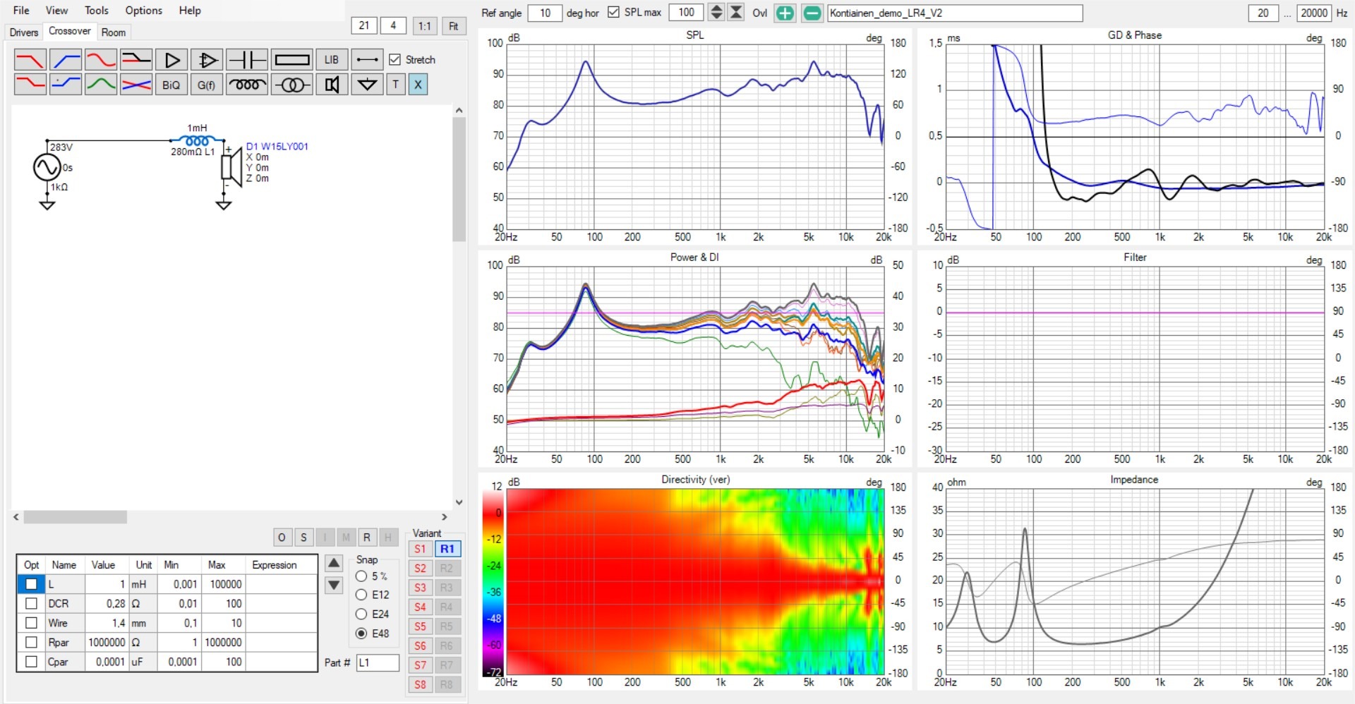

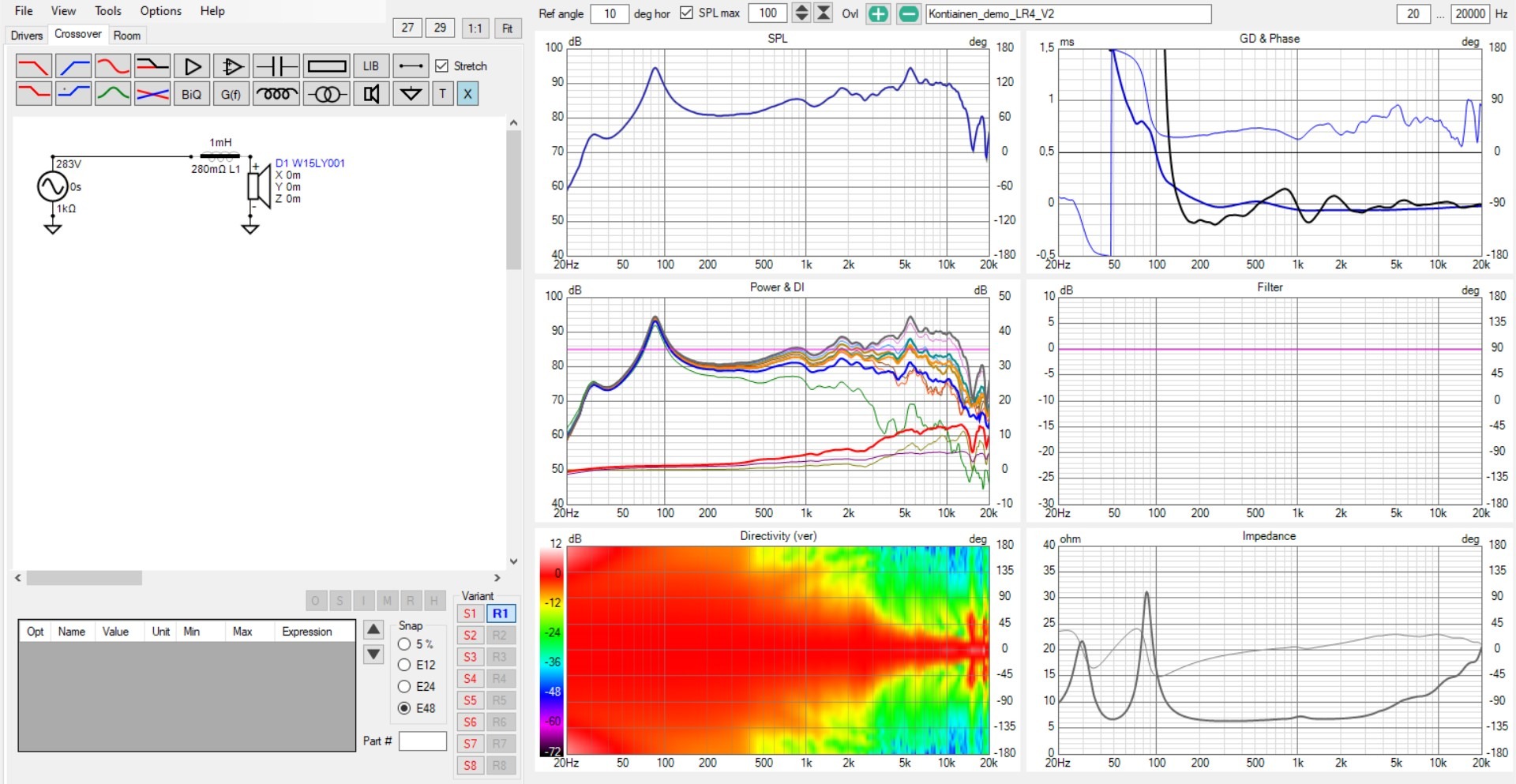

I'm quite familiar with these stuff and see the logic break with many posts, like in yours today, that's why I commented. You can have it as you like, but if it prevents other people understanding the stuff I want to everyone have a chance to figure out themselves. This is not that critical stuff so everyone can understanding as they like, as long as everyone is able to make fine sounding systems which both drives certainly can, so pardon me picking this up. It's just that your expertise and experience and confident text output makes it read like a truth, while this time it is not so I'll stand up. There is nothing wrong being wrong, so that's also why I have courage to do this. Everyone here to learn, at least I'm and want to share what I've learned in return.
Here, voltage drive, response changes when impedance changes. Simply demonstrated swapping inductor in series with a driver:
Here current drive, response stays the same no matter the different load impedance, because output is determined by current which stays the same no matter the impedance.
In that case, can you please show some results from your favorite Spice program?I'm quite familiar with these stuff and see the logic break with many posts,
VituixCAD can't do this, because it can't simulate a true current drive circuit.
A high impedance resistor in series does NOT do the same thing!
