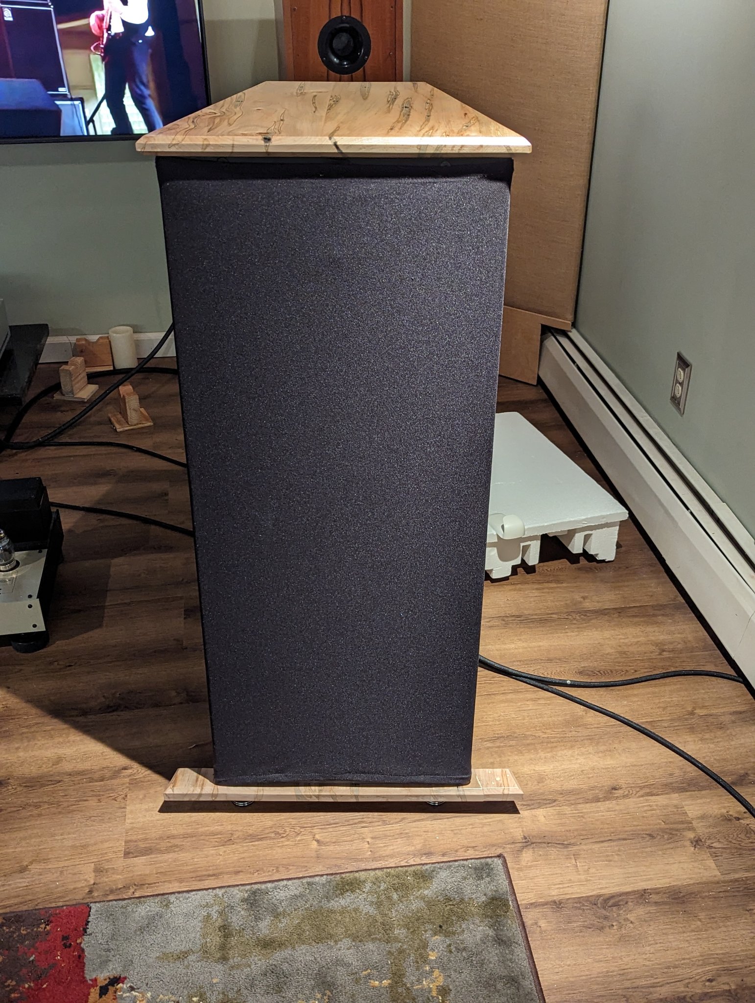

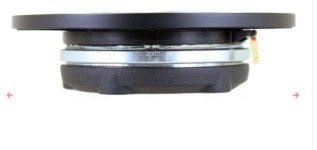

Thank you @flex2 for your suggestion. I did some research and that is definitely an awesome driver. The only question is does the protective wire over the dome protrude? The grill cloth on my speaker is like a sock stretched around the cabinet (see pic). I need a driver with a flat profile where the dome doesn't protrude. I looked at the photo of the driver side view and it doesn't look like it protrudes but I cant be sure.
