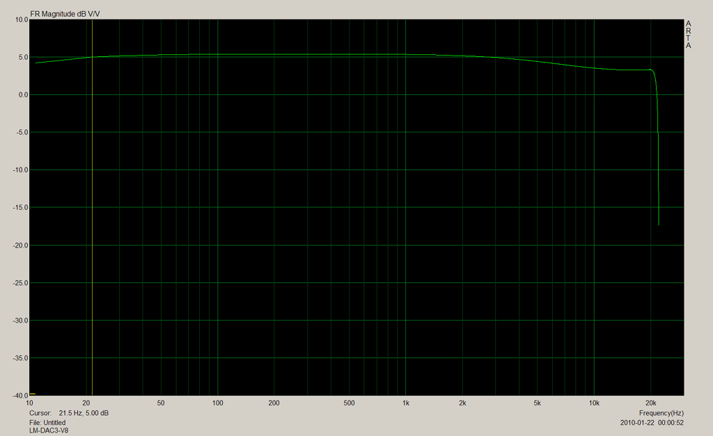

Got my DAC
This thread inspired me to purchase one of these little DACs. It arrived a few days ago and I had time to hook it up tonight and do some quick measurements. I used ARTA combined with an M-Audio 2496 card, frequency response was measured using a 16bit 44.1kHz SPDIF output.
I see about -3dB dip at 10kHz which I seem to remember reading some earlier posts about this. I look forward to modding this!
