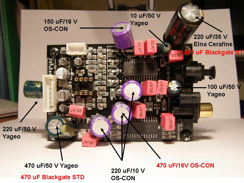

Hi, I found Lukasz Fikusz's pages approx 4 months ago. There are many interesting stuff over there, and I decided to give a try to "Lampucera 1.0" project (because of the cheapest one). After a while, I found this forum, and I am really amazed about this thread too! So, I bought a mini DAC board only, and upgraded the smd parts. The sound of the DAC is great: smooth, lovely, dynamic. The full symmetric version is even better! I steal the signal from L-, L+, R-, R+ points, followed by GE 330 nF/850 V capacitors. The signal goes to a Balanced Bride of Son of Zen preamp (DIY 🙂. The power source is an 6 V SLB (Sealed Lead) battery with special circuit. The black labeled was made to my friend; the red substitutions are for my version. János

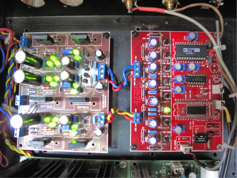

Definitely yes....besides the regulator meant for preamp and dac....but the board itself is too big to put into the chassis....

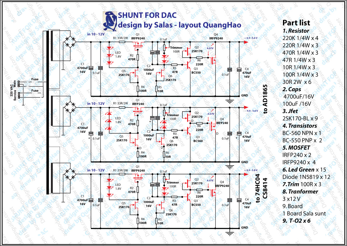

probably i'm thinking another shunt board like this reg-v2n-5d_shunt_regulator_PCB
I just wondering to those who applying output traffo mod such as Lundals, UTC and others, what else that you can do from here...? Would it be a tube output after the traffo...??? Is this the ending for this DAC board.....???
I imagine some will try upgrading the PS with shunt regs. A tube buffer circuit after the trafos, or a jfet buffer like the Pass B1.

I think the closest mod that can be done right now is the regulator and the final tube stage....I've seen one DAC with such mod done by Mcgyver
Notice that in Andrea Ciuffoli's DAC END circuit, there's a lot that can be implemented to the CS board although AD is a current DAC...look at the +5v and -5v circuit for the DAC. Using LD1086V50 is simple enough for the digital section PSU for the DAC and maybe better that generic LM7805 regulator and small too....
Andrea use E182CC which is pretty much the same to 6H6P used for lampizatior and we can use the PSU circuit for anode and heater supply...
