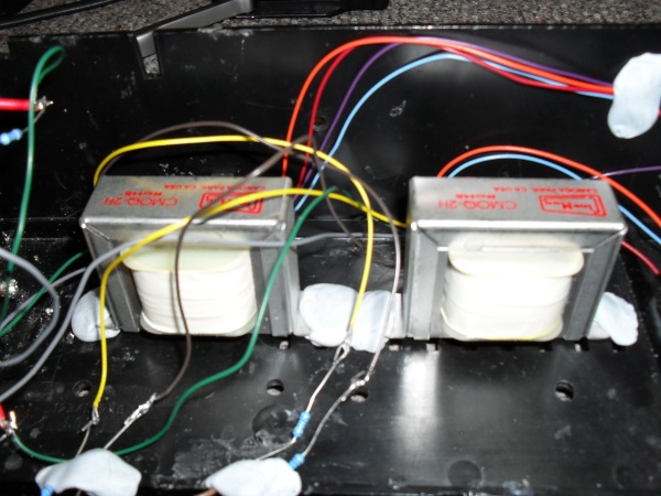

Well, I got my Cinemags, and find them unsuitable - too light weight for my liking.
Connected them up using the data sheet as a ref' and also using the preferred filters in this thread. Maybe I'm just doing something wrong, but I can't imagine what.
I give up on this project, wasted too much cash at this point to keep spending on it. I'll just keep playing my Vinyl.
Thanks Bill for the feedback. I have the boards for the AJ and now excited to build it. Well see how it sound.😀
CORRECTION!
The Cinemags are now working, and sound very clear and do have enough weight for me 🙂
Only issue is I may have damaged the right channel on the chip from the last resoldering, the gain is down on the right.
The left is lovely.
Damn it...........always something 🙁
At least I can say that these transformers are very nice.
The left is lovely.
OK....little better now, must be some of my solder joints 😛
Very transparent, un-coloured sound from these Cinemags.
