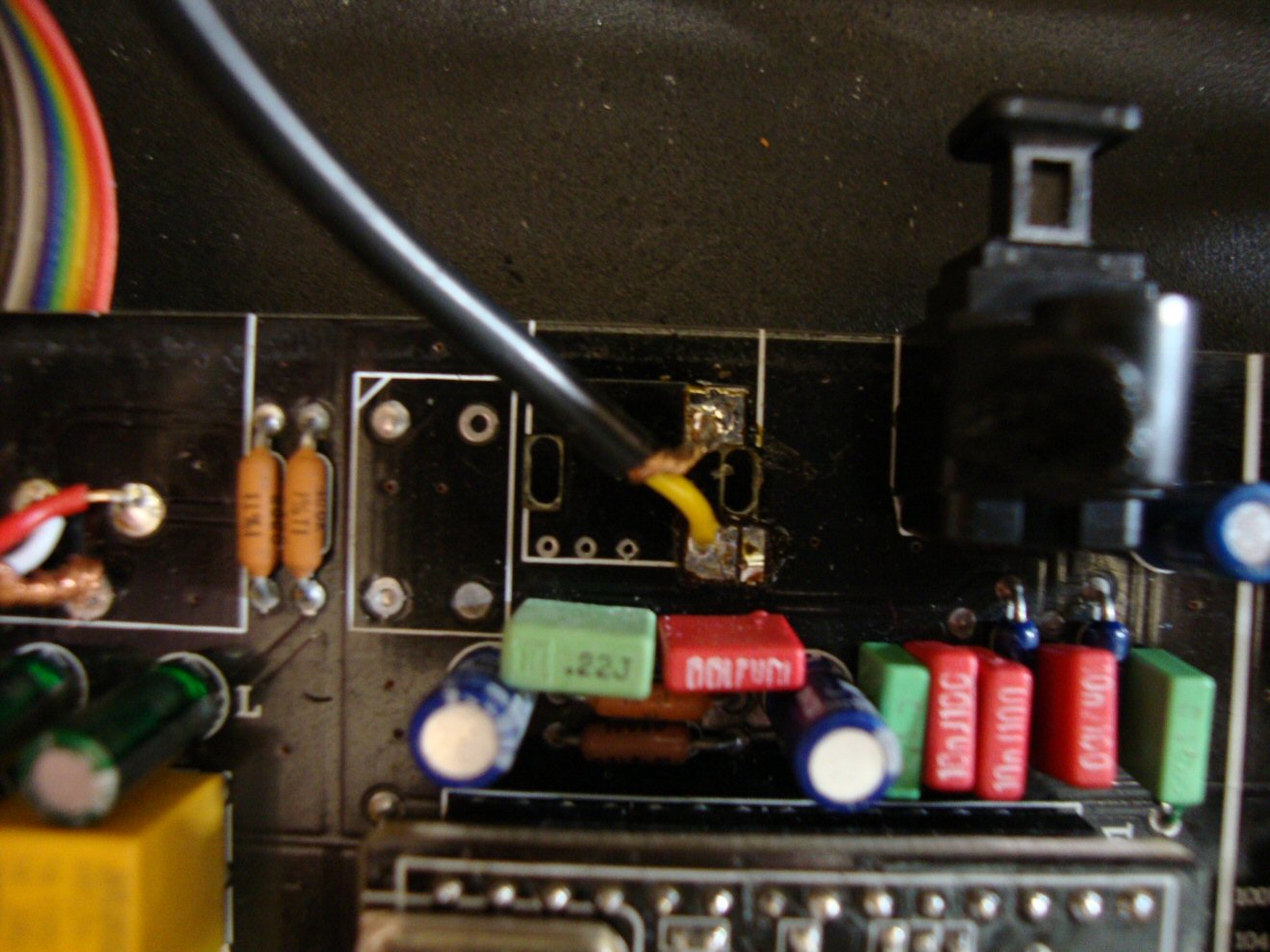

My coax and optical inputs don't work (USB does). I use a RCA plug on the chassis to connect to the coax input. The picture shows how this is connected.
Does anyone know if i have to connect the wire (yellow) also to the solder pad next to the one it is connected to?

The solder pad next to the yellow wire should be shorted, as well as the pad on the other side of the board. Furthermore, the setting Coax vs Optical is switched (rev. 8). The board is working fine now.
