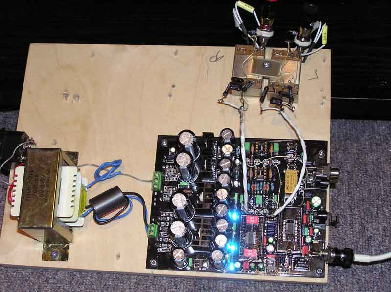

Hi
I'm the guy who published the direct coupling LM4562 in the lampizator web site.
The dac as is isn't flat with it's special equalization done by different RC combinaisons around the first op amp.
I tried to modify some parts around this op amp and ended to nothing.
You have the choice to leave it as is or completly redone the circuit arount this op amp.
The LM4562 is one of the best IF IT IS BROKEN IN. This means that it has to play at least 100 hours. The AD826 is better than a NE5534 but it has an annoying overbright high mid. The AD8066 with Browndog adaptors have slam and have terrific bass. They're not as natural sounding as LM4562. The OPA627 are too laid back.
I also tried tubes for output stage. This is good but believe me:
do you a favor:
Throw away your op amps, tubes, fets, Burson modules and use output transformers.
I used a pair of Lundahl LL1690 amorphous core and NOTHING beats this topology. It takes AT LEAST 100 + hours to be broken in but after that, you're in another league. Soundstage is huge, the image is wider, sound is mellower with better definition, it's the nirvana. It beats killer dacs.
Other things to do:
Replace the Sumlink pulse transformer for a Newava S22083 (Digi Key) They look the same but don't do the same sound.
Try a DIR9001 module to replace the CS8416 module. Replace the 3x100uF surface mount caps on the DIR9001 module with OS con Caps or good ones.
Replace the PLL parts value with the ones described here:
http://www.cirrus.com/en/pubs/errata/ER578D1.pdf
Have some fun with this marvelous dac
Here is the dac with the CS8416 receiver later changed for the
DIR9001
do you a favor:
Other things to do:
DIR9001

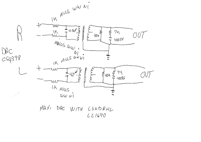

Hey Mister M .. good to see you on another board .. If we would to implement Lundhal trans on this dac :
. any clues on how we could do this
.. do you think there would be any value is doing this instead of OPAM..
Thks
Thks
Because my writing on the drawing is bad, here are the parts for both channels
4 X 1K Mills non inductive wirewound
2 X 4,7 nF
2 X 40K (I used Rikens but other quality resistors can be ok)
2 X 7K Mills non inductive wirewound
2 X 400pF (mica or polypropylene but please no styroflex)
Price for the two Lundahls is $250 (US)
2 X 4,7 nF
