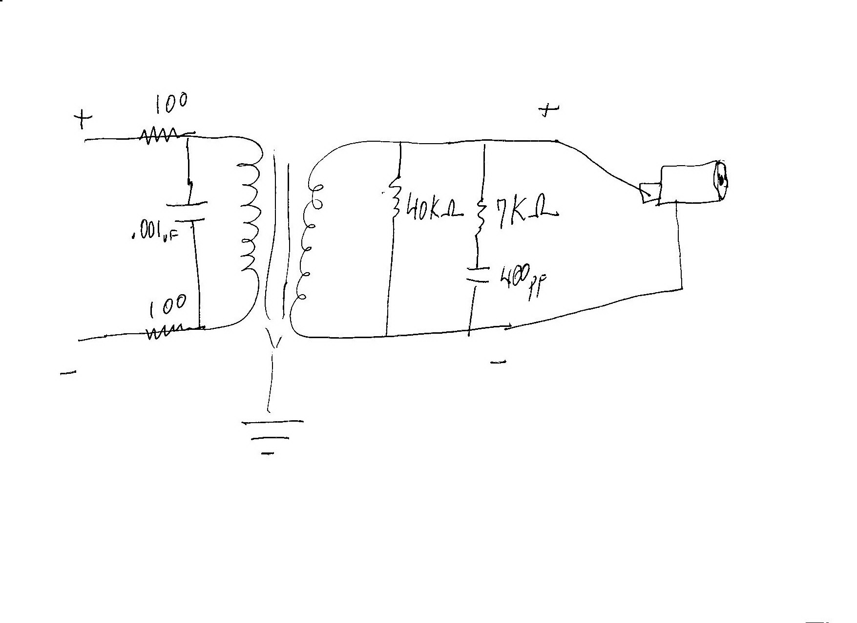

I would like for you guys to look at this drawing and see if it will work correctly before I connect it,It is a 1:1 Edcor TTPC EDCOR Electronics Corporation
Thanks alot

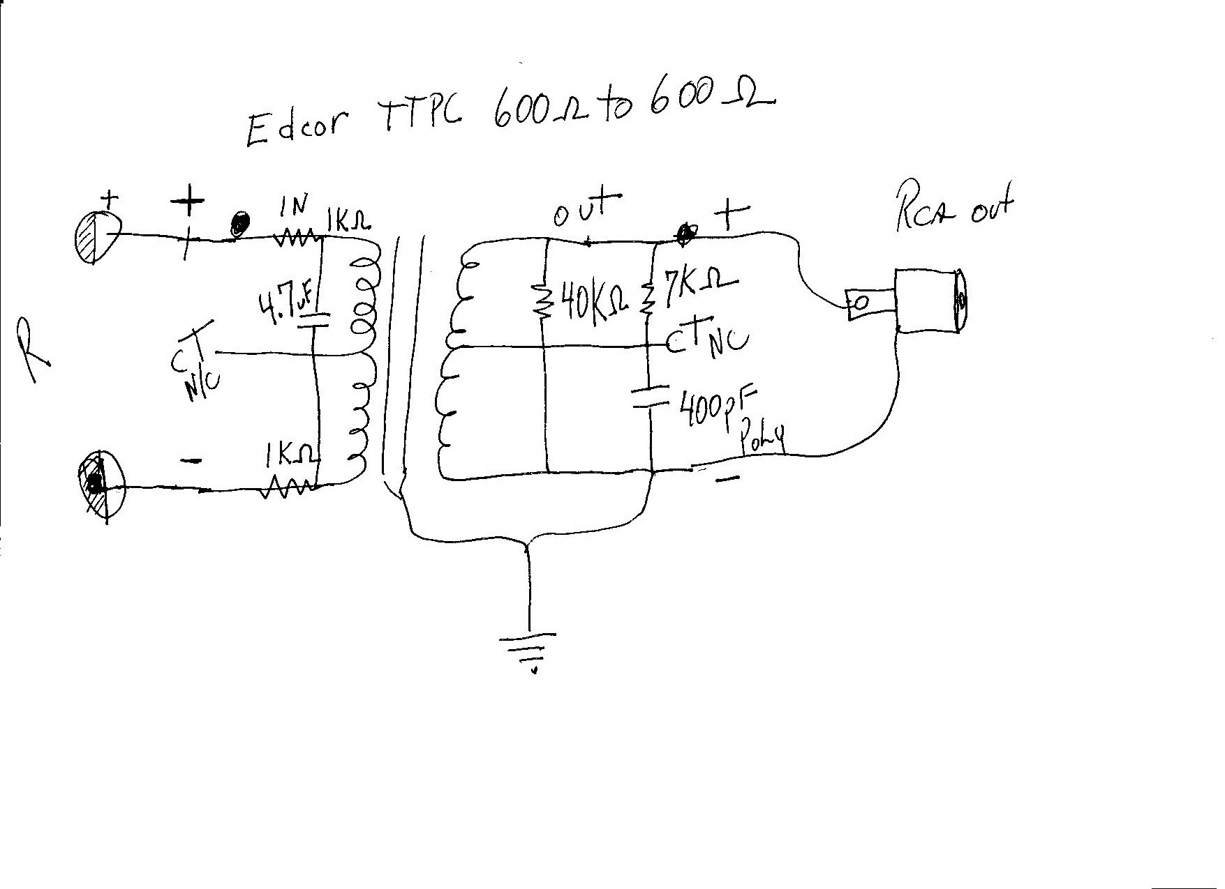

Lose the center taps and change the primary series resistors to around 100 ohms. Change the cap on the primary to around .001uf. I would not ground the minus output either.
That should work OK. The 40k could be eliminated and the 7k could be as low as 1k, but it will work as is.
http://www.edcorusa.com/Manuals/TTPC_0900.pdf
Thanks alot
