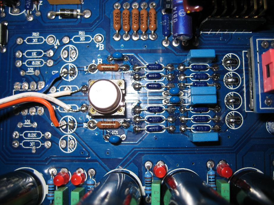

I finished all my mods and messed with bypassing the mute relay. It didn't make any noise at all when when losing lock on the digital signal, but it made a horrid screech when powering down. I set the relay up to short the output signal to ground and that fixed the power down noise.

Hi End 24/192 DAC DA CONVERTER CS8416+CS8421+CS4398 USB - eBay (item 160496622438 end time Oct-24-10 15:05:13 PDT) is what I got
shows the main chips
end stage audio by pair of 5532

Hi JB,
As far as bugs, there are a couple that I believe most, but not all, have ignored.
If you got the schematic with it, compare the 8416 PLL filter circuit with the recommended filter on the 8416 datasheet. I don't think they ever fixed it on previous versions, but a lot of us have fixed it on our own boards. I can't really tell you if it is audible though.
The power supplied to half of the 8421 upsampling chip is quite a bit over the manufacturers max voltage limit. There have been a few failures that required replacement by the vendors, but generally it doesn't seem to be as big an issue as I would have expected. That's another thing that they probably have not fixed.
As far as mods, if you dont mind opamps you can roll your own to your hearts content.
The standard dac chip itself has a 2v rms output that you can use directly through caps, through trafos, through tube or SS buffers or anything else you can dream up.
You can upgrade or completely replace any or all of the 8 different PS regulator circuits.
Most everyone that has posted in this thread has had their own goals and areas of interest for improving the board. If you ask direct questions about particular areas of improvement I'm sure you will get quite a few suggestions.
I personally don't have a single opamp in my entire system. I chose the output trafo solution, doing away with the entire output section on the board. The direct out solution with cap coupling is also appealing, especially if you have a balanced preamp input to feed.
Best, Bill

I have spent some hours on this thread but still have no good idea what mods would be best for this version.
If you don't go with output transformers, then at the very least the LPF for the op-amp needs changed to the values outlined in this document....
http://www.cirrus.com/en/pubs/appNote/AN048Rev2.pdf
I have also removed the second op-amp and all of it's components, removed all signal coupling caps, added local supply decoupling to the LPF op-amp, reconfigured the muting relay to short the output to ground when muting, and replaced all the Sanyo caps on the output of the regulators with Panasonic FC.

One word of warning. Be as gentle as possible removing components, the board traces are pretty fragile. For example, if a cap wont come out easily and you want to bypass it, just jumper across it with solder or a piece of wire. If replacing resistors, clip the leads off and solder the new one to them if they wont come out easily.
You might not have any trouble at all, I just thought this would be helpful.
