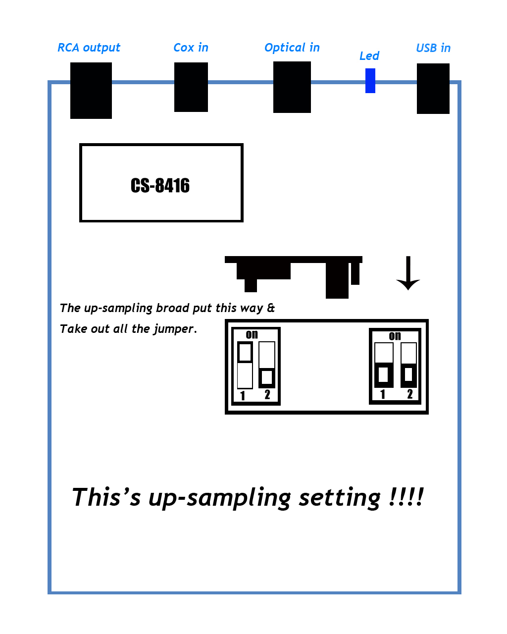

I use the upsampler board in place as suggested in the picture. However I wonder which kind of upsampling I get. Does the board upsample at the maximum frequency (192KHz) ? Does the upsampling board pass data to the DAC chip through the I2S port?
Anyway it seems to me that the with upsampler into the chain the Gigaworks sound much better. I also tried to remove the upsampler and compare with the file upsampled by the computer using SoX VHQ with mimimum phase (which is considered the best upsampler), it seems that the upsampler board does a better job. Did somebody do some experiment like that?

Ciao Pietro,
Can't answer you first questions, but hardware upsampling in the DAC will attenuate jitter whereas that done on the PC won't. This is perhaps why the hardware upsampling sounds better to you.

Greetings, I also have the Gigawork DAC and found a way to pick off the Fs frequency that the DAC samples at. Pin 28 of the CS8416 has the Fs there. Use a scope in the 10X mode of the probe or use a 15K ohm resistor from pin 28 to a DMM that does frequency. Ground is pin 22. My El Cheapo Radioshaft 22-812 DMM meter displays the frequency no problem.
I bought a cheap{20 dollar} frequency counter board and LCD display from a guy on Ebay and use it to display the Fs frequency. Very cool.
You also have to set the M3 and M2 switches on the DAC board to the "one" position and the DAC automatically follows any frequency from 44Khz. to 176.4 Khz. that is the max my PS3 will upsample to.
I don't get this. If you set M2 and M3 on 1 it should upsample the digital stream.
what's PS3?
I am not sure I got your replay. I think I was asking a different question. My question is about the upsampling frequency.
When the upsampler board is installed, does the gigaworks always upsample at the same frequency? Which one? The quartz on the upsampler board has a frequency which is a multiple of 48KHz so I guess that either it upsamples to 96KHz or to 192Khz. I wonder whether the upsampling frequency is fixed or it rather depends on the input signal.
