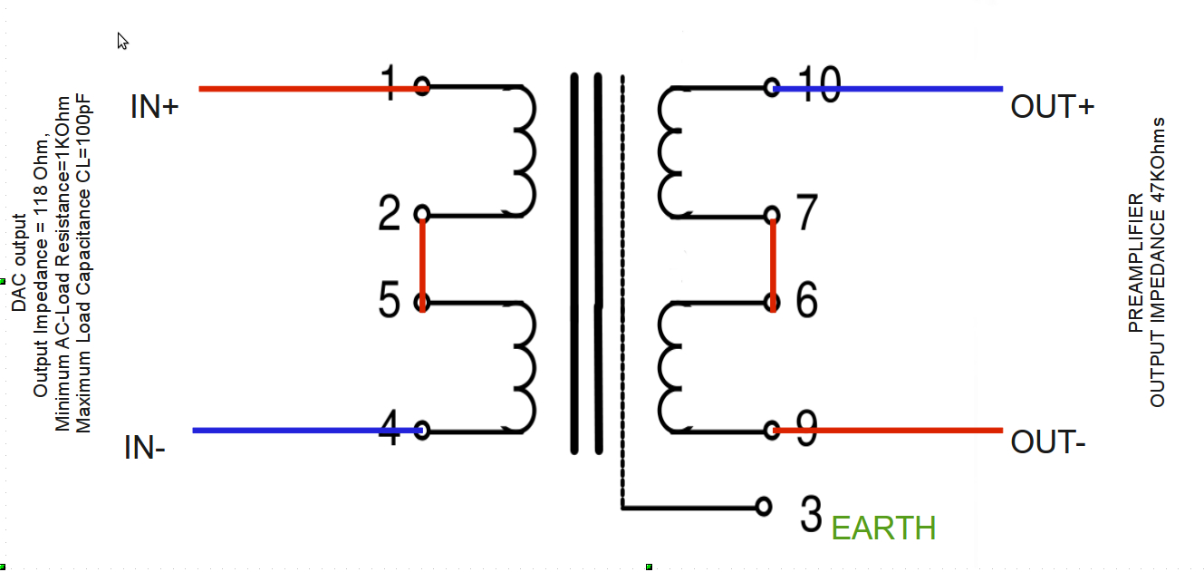

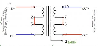

Per Lunahal suggestion
Dear forumers,
I wrote an email to Per Lundhal. Based on the the data of the CS4398 and the input impedance of my preamp (47KOhms) he suggests to connect the trafo as in the picture with a 7k resistor between pins 10 and 9... as a first try I'll follow his suggestion... I guess he knows his stuffs!
Pietro
NOTE: Please notice that on the right hand side of the picture it should be "input impedance" and not "ouput impedance"
