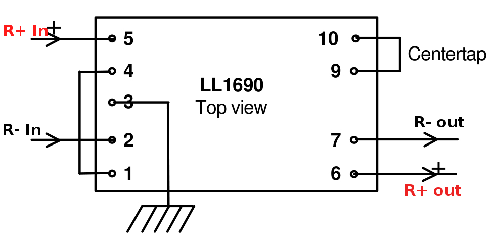

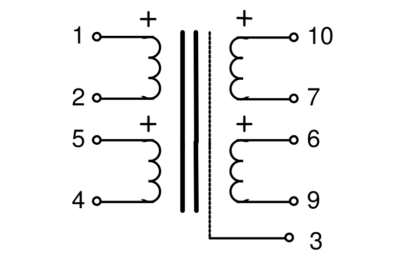

Lundhal connection
Hello Dears
today I got a new pair of Lundhal LL1690. I would like to connect them without any additional filtering... straight to dac!
I need some help, actually I am not sure I understood how to connect it. The trafo-01.jpg (attached pics) is the trafo's electrical schema, then trafo-02.jpg is the way I understood I should connect to the dac for right channel, say. Did I get it correct?
Best
Pietro

2-5 joined IN+ 1 IN- 4
6-7 joined OUT+ 10 OUT- 9
OK, and what about earthing (pin n.3)?
Pietro
Pietro
I would not earth anything on the trafo except the shielding. Differential circuits do not require a ground reference.

The LL1690 requires a proper load to operate correctly, look at the datasheet. Use it unless you are an expert yourself.
so you suggest to not leave pin n.3 unconnected?
The reason why I would like to try it unloaded is because there are people saying it sound better... who knows!?
P
