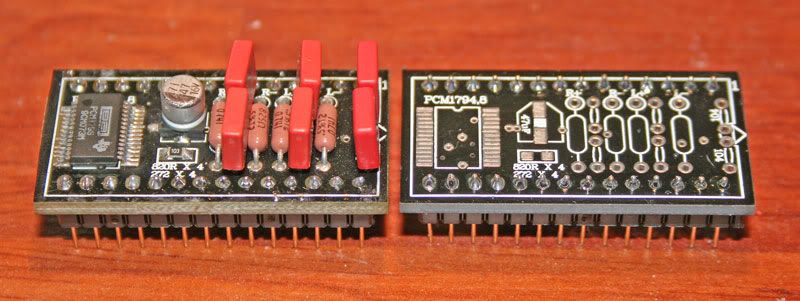

I got the empty adapter for the PCM1798/94,but how do I find out the pinconfiguration of the DAC board/adapter.I mean I know the pinlayout of the DAC chip,just wanna check the adapters layout is right against the main DAC board.Any one have a layout on this?I messaured voltages of the CS4398 adapterboard,but all I get is voltages I don´t get what is what,I2S and more.

I can tell you that the 4398 daughter board traces jump all over the place, so if your new board is generic there is no way it will work. If you got it from one of the Chinese dac suppliers you would hope they gave you the right one. You might have to ring out every trace to be sure.
I got it from snow468@gmail.com he sells this DAC board that whe are using.
They look like this:
I know sommeone did use one in this thread with output trafos,so they do work with this board.I guess I will have to try follow the traces on the adapters,because I wanna know what the pins are for,unless snow knows it...

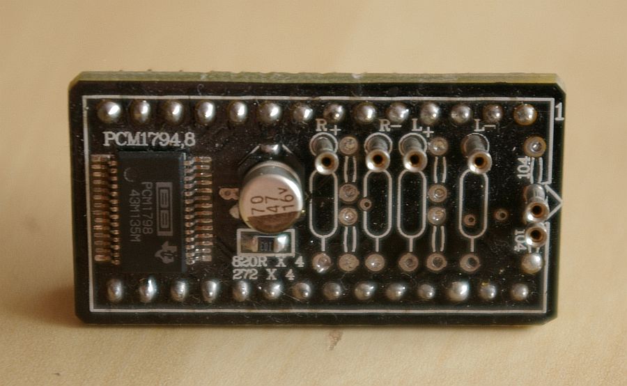

I did use it.
Your daughter board is the right one. You had to solder a capacitor and SMD resistor, and of course PCM1798 or 1794 (and NOT 1792 or 1796).
I'll post some pictures later.
pcm1798 board

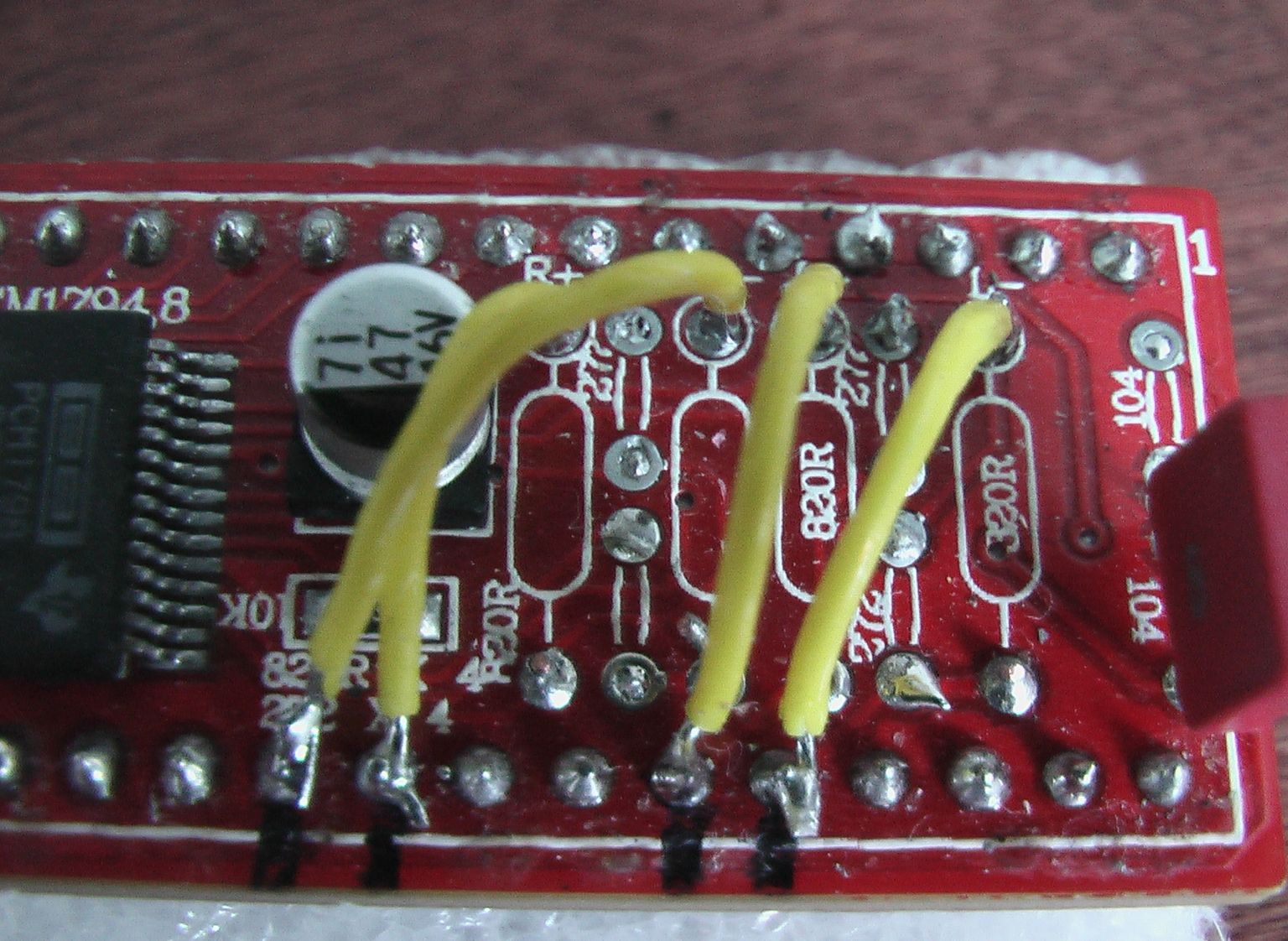

That reminds me something...
Actually, I removed several parts from the pcm1798 adaptor (including the opamps under the board) and put few wires to make a direct drop-in for the DA converter.
Look at the picture:
pin19 to R-
pin20 to R+
pin23 to L+
pin24 to L-
That goes directly to the same outputs (ref CS4398 adaptor) on the DA converter board.
You can load the transformers at the output or the input (better results in my setup but takes 4 resistors instead of 2). Take a look at my findings on a previous post (same title: pcm1798).

Is it simply a matter of stripping the board of the parts on the top, removing opamps and soldering the wires as shown or does something else need to be done that is not shown in the pics?
Also - can these adapters be ordered with with PCMxxxx already included or do the chips need to be ordered separately and then soldered?
Thanks for the pics,by the way is there a ground connection on the adapter,to solder the I/V resistors to.
Snow sells the Pcm1798 on adapter,the Pcm1794 he did not have,so I boght an empty adapter and bought a 94 else where on ebay.Also - can these adapters be ordered with with PCMxxxx already included or do the chips need to be ordered separately and then soldered?

I did a direct comparison between CS4398 and PCM1798, and... there is no any comparison. PCM1798 is a way better in every aspect. I'm impressed.
Some pictures:
