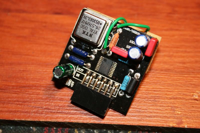

I´ve maid the "finesse"trick to the clock on the upsampling module:
Finesse Voltage Regulator Noise!
Checked with the scope,it´s hard to see exactly,but I think it is 1-2mv less ripple.

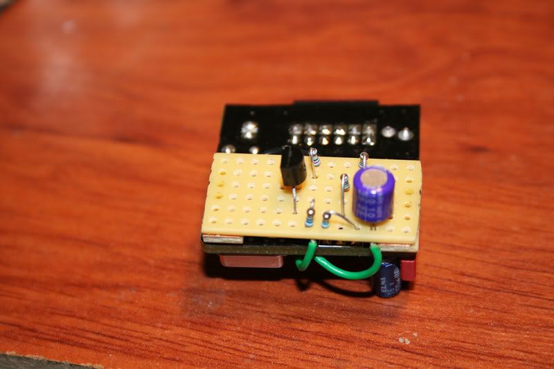

My Sample rate converter board died today (the third time it was powered up). I think I understand why it did and maybe why others are having similar problems with no sound in this DAC.
The gigawork sample rate converter board that came with my unit doe not contain any 3.3 volt regulator. This means that the entire chip is being fed 5 volts. This isn't a problem for the VL (logic voltage), but is a big deal for the VD (digital voltage). The VD line has an absolute maximum voltage of 3.5 volts which is significantly lower than the 5volts it's being force fed.
Take a look at the enclosed pictures, the part on the back side of the board is the 3.3 volt regulator, if yours is missing, you've got problems. Those of you with no sound coming out of your DAC, is this part missing?

Wow... a solder bridge. That's bad. Did you buy it straight from Gigawork (eBay)?
I guess if you have the 3.3V regulator, then you will need that everything on digital side to be 3.3V (to avoid level-shifters).
I noticed the same thing. Gigaworks replaced my bad upsampling board with one that had the regulator attached to the back. First one did not have the regulator. How much did they save there? Couldn't be that much.
They aren't saving anything when they have to replace them all 😡
You really need a spectrum analyzer for that task. You'd check the power to the chip and more importantly the spectral purity of the clock before and after adding the clamp. I don't have an RF spectrum analyzer at home, so I'm flying blind.

Don't you have some heat issue for CS8421 there?
No,should I?
