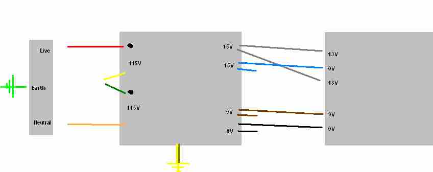

Help Please! I'm hoping someone can sanity check my plans for wiring up my IEC connector, R-core (R26-34) and DAC as I'm pretty sure I've got it wrong. I haven't been able to find a good guide for the r-core (plenty for default toroids).
The advice I was provided from diyclub regarding the r-core:
the R26-4 have two group of 0-15v and two group of 0-9V wiring, just connect the two 0-15V in series then you wiring is look like 15 0-15 0, then connect one of the 15V wiring to you DAC 13V, the 0-15 wiring to 0, and then the remain wiring to other 13V,
and about the 9V just you one of the 0-9V
I don't really understand the part about connecting the two 0-15V in series then wiring 15 0-15 0 (or does this mean the 0-15 is actually a blue and grey connected together into the 0V?)
Current Layout
IEC
E - earth?
L - live?
N - neutral?
R-core
PRIMARY
Red (dot)
->115V
Yellow
Green (dot)
->115V
Orange
SECONDARY
2 x Brown (9V)
2 x Black (9V)
2 x Grey (15V)
2 x Blue (15V)
EARTH
1 x Yellow/Green
Proposed setup
PRIMARY
* Chassis earth -> IEC Earth
* 1 x Red (dot) -> IEC Live
* 1 x Yellow -> 1 x Green (dot) (to obtain series 230V for Australia)
* 1 x Orange -> IEC Neutral
SECONDARY
* 1 x Grey -> DAC 13V
* 1 x Blue -> DAC 0V
* 1 x Brown -> DAC 9V
* 1 x Black -> DAC 0V
EARTH
* R-core yellow/green earth -> Chassis ground
I'm not sure about the 0V connections to the DAC - another poster from stereo.net suggested these needed to be connected to ground
Thanks,
Michael.

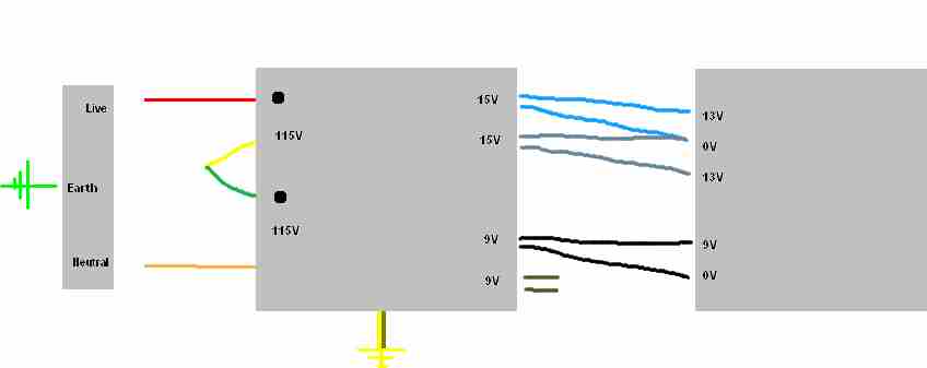

That was me, but in that description it looks like you have no '0' taps coming from that transformer.
R-core
SECONDARY
2 x Brown (9V)
2 x Black (9V)
2 x Grey (15V)
2 x Blue (15V)
See by what you posted it looks like you only have active secondaries (with voltage), and no '0' taps
I'm very confused?
Yes!
But then you have to measure that the remaining blue and grey make 30 V AC on them. If not connect the other one of the blues to the grey one.
Then the two that make 30V you connect to the two 13V connections and the two you already put together you put on the 0V connection.
For the 9V you either take the two brown wires or the two black ones.

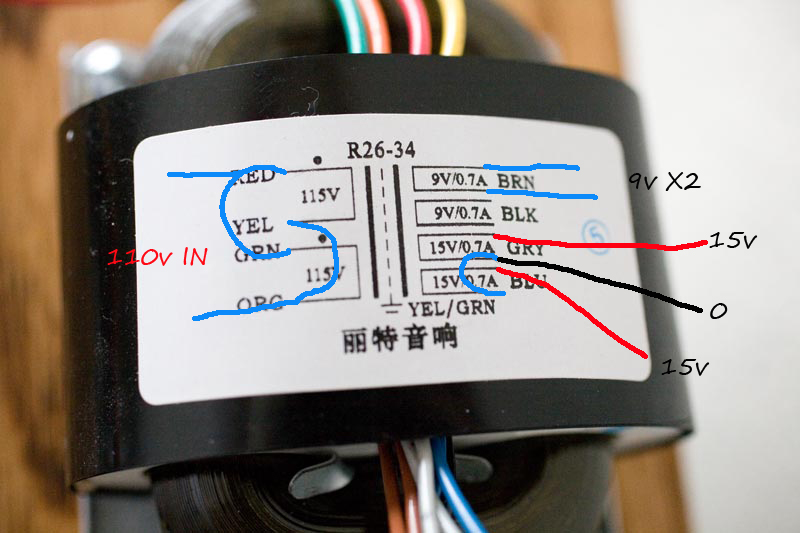

Hi rhinomite
I have the same transformer (R26-34) and asked Ian Ma advice. He now supplies an R-core transformer instead of the toroid (typical!)
His has different colour wires but he sent me this diagram to help.
In place of the blue - 9V use both blacks (browns not used so snip ends and tie safely in knot)
in place of the yellow - 15V use grey
in place of the brown - 15V use blue
Twist spare grey and blue ends together and connect to middle 0V
I'm in UK so for 240V primary use red for Live and orange for neutral
Then twist ends of yellow and green primary's together to make connection (solder together or crimp)
Connect earth wire (yellow/green striped) to IEC socket if using metal chassis.
Hope that helps
Rich
I set Ian Ma a pic of my R26-34 and he sent back the below pic.
In a nutshell, yes you connect both a blue and a gray wire to the 0v.
Thanks so much everyone for helping out with the wiring!
I've attached a picture of the final diagram for reference
Just on grounding, given I'll be mounting all this on wood until finished, what can I do about the IEC ground and r-core ground?
