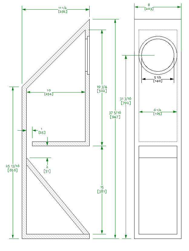

I have been enjoying your D5nf design from earlier in this thread. It really lets the driver sing, and gives excellent bass. I would use MDF next time, the pine is ringy, but I haven't started bracing or damping yet.
I did a rough and dirty measurement of the bass response in room, 1M distance on driver axis. It is really flat to 290Hz and rolls off -6dB at 60Hz and -15dB at 50Hz. Measured using SPL meter and recorded sine tones at 10Hz intervals.
The low height of the driver is the only drawback. Do you think it could be raised to ear height while still maintaining the acoustic function of the design? I was thinking of stretching out the cabinet to the right height, while maintaining same chamber volume, port dimensions, but the horn section would have to be elongated to go all the way to the floor which I assume is critical to the bass. Raising the speaker 10" up off the floor on a solid wood box destroyed the bass and balance.

Glad they're working for you. Frankly I'd be inclined to leave it alone. The vent profile / flare is rather specific. What you could do is shape the box to a trapezodial profile so it angles the driver backward slightly and aims it at your ears.
BTW -don't try MDF for this. It's not stiff enough for the flare & the front edges will resonate like crazy. Birch ply is more expensive but IMO is a much better choice for this type of cabinet. Or any, come to think of it.

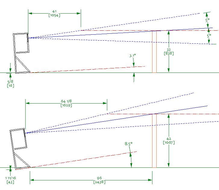

mluckow said:but I'd be even more interested in them if they positioned the drivers at ear height. I guess that one option would be to build them and then cut the bases off at a slight angle (a few degrees) such that the front baffle points upward slightly, to the point where the drivers are aimed at my ears from about 8 feet away, but that would always limit them to being placed about that far away.
See the attached... you can see that it is not all that limiting.
The other thing is -- How much off axis is the best listening position for these drivers?
dave
Nice drawings Dave! I see you have a real CAD program, but I bet it wasn't free like mine - haha
Your first drawing is interesting. I prefer a little off axis anyway, so the sound quality is just about right for me as they are now, but the imaging is the only issue. Sitting on the floor it is perfect!
The second drawing was kinda what I had in mind, but I was thinking of stretching the horn before I learned that the horn geometry is sacred. Great idea you have there on manipulating the top rear edge while keeping volume constant. Since width must remain the same for the port to work properly there aren't a lot of options. I assume the port needs a vertical rear wall to be optimum. A curved top rear would be optimal for volume, space behind driver and flow through port. Building the curve non resonant would require some effort.

Yes, I guess that cutting a slight angle off the bottom wouldn't be as limiting as I thought, so that will definitely be one option.
Also, with regard to your second drawing, I can see that the drives would have to be moved down quite a bit to avoid hitting the angled back plate. (The Feastrex D5nf drivers have a near-spherical yoke on the back that's quite large for 5" drivers.) Also, is it okay to change the internal geometry in this way? If so, then that might be a great way to go.

mluckow said:Also, with regard to your second drawing, I can see that the drives would have to be moved down quite a bit to avoid hitting the angled back plate. (The Feastrex D5nf drivers have a near-spherical yoke on the back that's quite large for 5" drivers.) Also, is it okay to change the internal geometry in this way? If so, then that might be a great way to go.
I would indeed be interested in building a larger cabinet to start with, such as the Harvey,
The Changs and the Harvey family are all really bass reflex, so within reason (you don't want to turn it into a BVR-ML-TL) as long as port geometry is held constant you can manipulate the shape of the actual box part of the box. My 2nd thot on Freddie Chang (the working name for the Feastrex half-chang) was to angle the front panel back.
A double mouth Freddie would certainly follow directly from the single mouth, a mutation of Harvey might be more work (or it might just be a change in the size of the pre-chamber)
