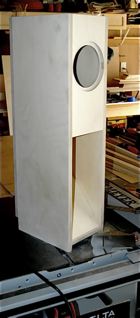

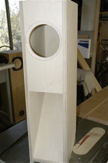

One Box built one to go...
I do not like the idea of having a removable back.
Screws in a speaker cab bothers me.
I like glue.
I know you have to get at the Feastrex to screw it to the internal brace....
A better way...please?
Ideas...anyone.

That's two of us who don't like it much. Then again, I suppose we should reflect on the LS3/5a. Not to all tastes, but few would deny that it is superb for what it is & it's design criteria.
Re: One Box built one to go...
Three of us.
There must be a way of getting at the mounting. Can you (& Mike) send (big) pictures of the details of this mounting/driver? I think i saw an example in a box too.
dave
