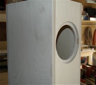

One down, one to go
LS3/5a
Its a small box , the LS3/5a, So I guess if I were going to duplicate the build quality, I would need to add extra side panels and tops plus a bunch of internal bracing. The Rodgers are built like the proverbial brick sxxx house.
Then I could drill and countersink the screw holes and add a foam gasket all around.
But until we see the Feastrex numbers from Chris...this box is a good start

I don't have a problem with screws per se, just the gasket material in-between the mating surfaces and why I only use at least NEMA 3R and preferably NEMA 4X rated industrial grade neoprene that should be available at your local electrical contractor's supply house and I assume on-line through McMaster-Carr or similar.
Anyway, JC broached this subject with me yesterday and there's no doubt that these driver's bulbous appendages needs some serious support/damping. Then there's the bane of all wide BW single drivers I've messed with and that's baffle and/or frame spurious resonances that normally can be delt with via one or more forms of mass loading such as massive front, rear mounting rings, HJ's adjustable screw blocks (wish I'd thought of that one!), etc..
Being a lazy sort, my choice would be to 'kill two birds with one stone' by rigidly mounting the driver only by its motor with a massive, contoured ring attached to its mounting plate to act as a harmonic balancer 'floating' above the surface of the baffle, yet lightly! compressed against a suitable gasket both around the baffle opening's perimeter and between the driver/damping ring. Now, any cab/whatever spurious resonances will be damped down at both ends.
I'd put the access panel in either the top or bottom depending on the driver's location figuring if on the bottom the structure's weight will ~guarantee a good seal and since I'm a firm believer in mass loading any cab that doesn't weigh at least as much as me, a massive top plate (slate, marble, or similar and high WAF to boot) will help with any potential sealing issues if at the top.
As always though, YMMV.
GM
mounting of the rear
Phil,
Agreed, don't like removable cabinet backs either. I have an idea for getting around it. However, I'm not necessarily looking to decouple from the front baffle and plan on maintaining the front mounting as well. I prefer to have a solid support mounting that does not allow any flex in the axis of cone movement. Distributing the support between the front, rear and sides makes more sense (to me at least) than providing a single support between the sides with a cross brace.
My plan is fairly simple. I'll be building a support that consists of a wooden tube that extends from the rear of the driver to the rear of the cabinet. The wooden tube is hollow and allows a longer cap bolt to be used from the rear of the enclosure and into the back of the driver. This alone gives you mounting of the driver to both front and rear. The tube itself is then braced to the sides and possibly the top and bottom (depending on the cabinet design). One could even make an "X" brace from the support tube to the corners of the enclosure internals.
Regards, KM

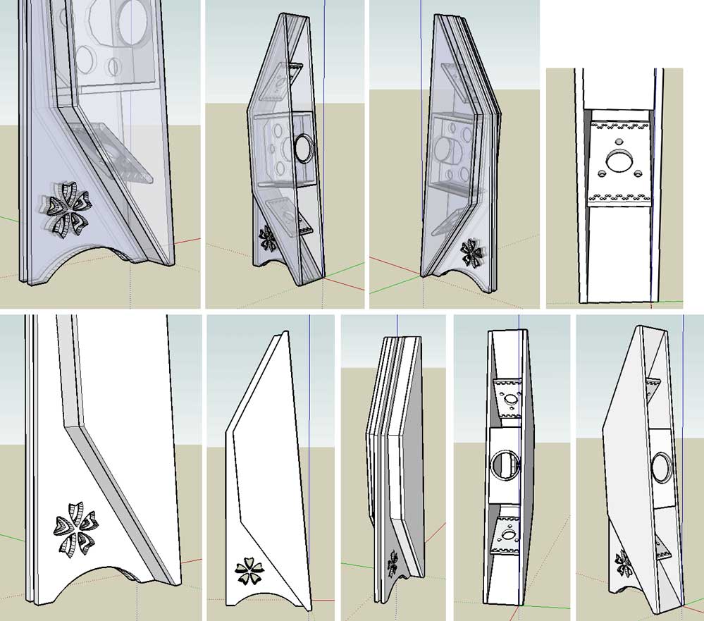

New Maiko cabinet for the Feastrex D5nf
I wanted to let people in this thread know that I just started a new thread called "New Maiko cabinet for the Feastrex D5nf" to announce a new cabinet that Scott and Dave of Frugal Horn designed specifically for the Feastrex D5nf driver.
All the details are over there in the new thread, but I'll post the preliminary rendering of the cabinet below for your reference.
This is great news for people who have this wonderful driver!
