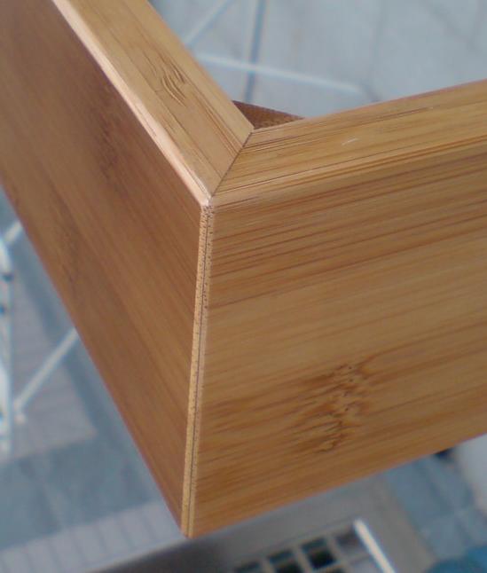

the many faces of bamboo
chrisb said:
Brian:
the block core laminated panels are definitely within the realm of what the Architectural millwork associations classify as "plywoods" - the internal cores do not need to be veneer. Indeed, depending on how liberally your interpretation, MDF or particle board core with thick face veneers are "technically" plywoods.
As to my staining issues, those could well be the result of the wrong product (i.e. fast penetrating alcohol based stain), and the resin content of the laminated plywood.
hi Chris:
just came back from the wood factory and asked the owner about the story on bamboo. He said processing and using solid bamboo wood's began in Japan, then later in Taiwan and now in China. the factory he buys from is actually Taiwanese. Bamboo wood for furniture is graded AA, A, and B. AA is what you see in the snap here and is the superior grade with no separations or flaws. The nice thing about bamboo is it can be harvested every four years.
Staining: he said yes, most difficult stain. They use a process of hot staining where they heat up the wood and apply the stain under pressure. I don't know what kind of machinery they have for that but I'll surely take some pictures if I see it in operation.
In two weeks I should have a 30 L cabinet made out of the same kind of what you see in this picture.
