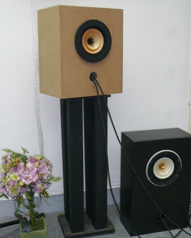

enter the Dragon: Field coil version of the 5 inch with Urushi treated phase plug and special treatment to the cone material. and a few other little inspired touches, courtesy of Teramoto-san. standing next to the D5nf.
right now I'm powering them with our DC filament supplies. We can get a maximum of 13.5 V out. And field coil draws a little over an amp. We will do a higher voltage version of the supply especially for powering field coil motors.
I know, you can't take your eyes off those boxes! I think I can claim the highest driver to box cost ratio in the world. I'm still thinking about their final resting places.
Not able to take any measurements of the field coil version has we had a break-in and someone took my notebook which is what I use to measure. Replacement coming this week, then will do some measurements. But I may need to wait until we have the high-voltage filament supply as I understand 15 V is optimum so would be nice to compare a different voltages.
will post some listing impressions later.

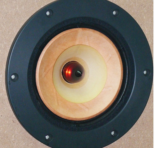

Crikey, a red cone! Now I know why he needed to obtain a supply of "dragon's blood." And that looks like a different frame too. Doesn't that guy ever sleep? Or did you put him up to it so you could have a 10th "dragon" for Kowloon? (I should think nine dragons ought to be plenty . . .)
If that motor is like other Feastrex field coil motors, I would want a power supply that could be adjusted all the way up to 24V, at least for experimentation purposes. Probably 24V is "wasted" insofar as the gap flux density ceases to rise long before you get anywhere near 24V, but I think remember reading on the president's blog that the sound continues to change as the voltage is increased, even though the gap flux density remains unchanged.
I definitely want a run-down on what they sound like because I think that's probably the sole pair of Feastrex drivers using dragon's blood. The red glow of those translucent phase plugs is a nice match . . . a "dragon green" frame to complete the "draconic" imagery would have been an interesting touch.
-- Chris

it was a case of one thing leading to another. The basket is machined so that it can flush mount into the front baffle. With the D5nf a wide baffle really affects the sound positively. so I'd like to find out if anything is to be gained by removing the diffracting edge of the basket frame on the front baffle. and then there was some discussion on cone treatment and a few other details and Hal then just took the ball and kept on running....
the thing is that even at 13.5 V we are dissipating about 15 or 16 W. I measured the basket increasing about 18°C above ambient temperature. At 24 V we'd be dissipating about 48 W. I hate to think how much that will drive up the temperature. I think our supplies will have an adjustment limit of about 20 V.
I'll need to get them out of those MDF boxes first. That's just to let them run in and to give our DC supplies a shake down. IMO it is a total waste of these drivers to put them anywhere near MDF. I can hear the MDF-muffled-decay sound right away, especially with these drivers. I plan to make some cabinets from a material more familiar to the dragon -- solid bamboo wood.
Next step will be to do some measurements.
regards
Brian
