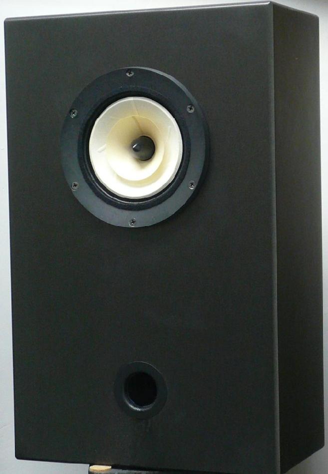

Brian, any details and/or pics of the 13L enclosures you did?
Here's a pic.
I'll get the internal dimensions when I return to the shop on Monday.

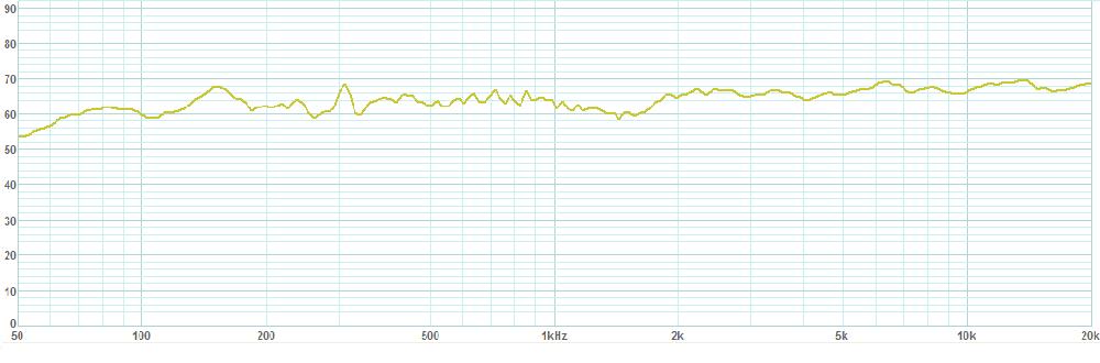

Just to update: I've done 2 things since the above:
1. installed the 0-8-16-22ohm OPT and
2. mounted the drivers from the back and removed teh basket rim mounting screws.
Last time I compared 4/16ohms. The difference between 8/16ohms was less than half to 4/16ohms numbers. The 22ohm OPT doesn't have the 4 ohms taps so will have to compare with what we've got:
referenced to 8 ohm: frq/db change 16/22ohm tap
70hz/+0.75/+1db
100hz/+1.2/+1.5db
1khz/-0.2/-0.4db
5khz/+0.2/+0.5db
10khz/+0.4/+0.5db
20khz/+0.6/+1.5db
So there is still a little to be gained at the frequency extremes with the higher taps although not as great as 4/16ohm comparison.
Also I used WT3 to test the box tuning and F has dropped from 45 to 42.4hz so I'll pull out the drivers and retest as seems the driver is loosening up and Fs dropping? I guess the Vas getting larger then too.
Attached is the frequency response in room. Can't exactly be compared to my last measurement as probably the mic is in a different position and some boxes etc changed position.
I'm getting the feeling the amount of stuffing needed when the drivers were new is now too much. I'll pull out some in the next few days and see how that changes things.
Regards
brian

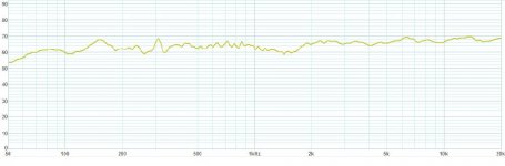

Been running a week now. The D5nf are mounted is a 13L box with vent. After getting WT3 I found the box was tuned too low so shortened the vent by 40% to get it back to the desired 45hz. It's still running in but can throw some heft in the bass. Treble is great. The attached is as measured in my room, at listening position. The room is untreated and there are a lot of reflections but it does illustrate the bandwidth. I cut the side going down to 10hz because the ground here shakes constantly. I had to do the measurements on a Sunday to get a halfways quiet environment. Also tried different taps, 4/8 and 16 ohms. Best response is definitely 16ohms. Compared to 16 ohms the treble falls away 4db/20khz, 3.5dd/10khz, 1db/1khz, 2.5db/100hz, 3db/65hz. on the 4 ohm tap.
