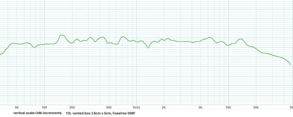

13L box - some measurements
Been running a week now. The D5nf are mounted is a 13L box with vent. After getting WT3 I found the box was tuned too low so shortened the vent by 40% to get it back to the desired 45hz. It's still running in but can throw some heft in the bass. Treble is great. The attached is as measured in my room, at listening position. The room is untreated and there are a lot of reflections but it does illustrate the bandwidth. I cut the side going down to 10hz because the ground here shakes constantly. I had to do the measurements on a Sunday to get a halfways quiet environment.
Also tried different taps, 4/8 and 16 ohms. Best response is definitely 16ohms. Compared to 16 ohms the treble falls away 4db/20khz, 3.5dd/10khz, 1db/1khz, 2.5db/100hz, 3db/65hz. on the 4 ohm tap.

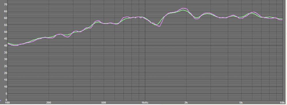

Hal Teramoto told me he is grateful for that post, Brian, and he expects that over time the high end extension will continue to improve.
Well high frequencies above 10K are the MOST difficult to measure accurately so I wouldn't be concerned about the absolute values of the graph above that number. Actually the RTA shows a lot of healthy action up to 25khz which is already a feat for Feastrex and way better than other drivers I've tested.
Consistency is possible even without testing. Just use consistent components and assemble them in a consistent manner and you'll get consistent results.
The attached shows an on-the-floor, quick and dirty measurement of the two drivers as received, fresh out of the box. Compared to other drivers we've tested, these are supremely well matched.

My little box: a 13L ported box isn't very creative, i know, but as mentioned I wanted to see if this driver will work as someone might want to use these drivers but not have space for big boxes. Well they work very well. Maybe with a smaller box we hear less box and more driver. Yesterday a Feastex user came by and observed that the small boxes don't sound deficient at all compared to the usual size box this driver is used with.
