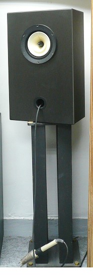

Just 13L, wide baffle. I had these at hand, so for a quick tryout, and a chance to get to know the drivers before leaping into something more deserving I used WinISD to tune it, backwards from the said cabinet. It plays in room pretty well what the software predicts - good bass down to 50hz, not run in yet (software predicts should have good bass presence to about 45hz. In Asia, by necessity we often need to place speakers close to the wall. Mine are about 30cm from the back wall.
The speakers are very melodic and I'm quite surprised at the quality of the treble. I'm getting measured output up to 23khz.
It seems these drivers like a wide baffle.

From the black phase plug I assume that is a D5nf driver? You'll get better everything as the driver breaks in over the very long run-in period.
The now-defunct Exact brand always benefited from broad enclosures; here is one realization of the Exact 38 liter enclosure (with 16cm driver -- belongs to William Ang in Singapore):
Hal Teramoto also has been generally happier with the sound of enclosures that are broad and shallow rather than narrow and deep. I think he will be surprised if something as small as 13 liters works out really well -- he is quite happy with his current 50 liter enclosures.
