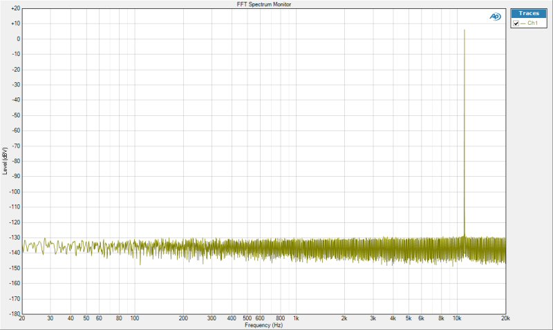

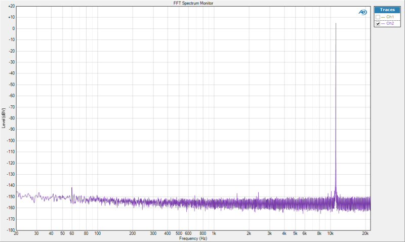

exaU2I Jitter Measurement
We were asked many times about the jitter levels of exaU2I. To measure jitter reliably down to the picosecond level is exceedingly difficult. So instead of presenting a single value, we measured jitter patterns that are relevant to auditory perception. One direct way to measure jitter is to monitor the DAC output.
We used signal from a 16 bit file, 11.025 KHz, a quarter of the sample rate, 44.1KHz. We used very long FFTs, 1024K points, averaged 4 times.
The jitter would manifest itself in the frequency domain as double sidebands, centered around the signal. The amount of timing jitter can be estimated from the amplitudes of these sidebands and the frequency of the signal.
Here is a measurement that illustrates the lack of visible jitter artifacts above the noise floor in the exaU2I->e18 DAC output. Keep in mind that this measurement is affected by the noise and jitter caused by the ADC of the measuring instrument.

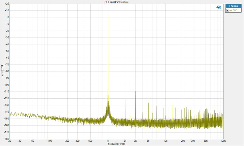

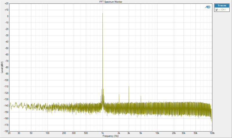

exaU2I Measurements
During the past few weeks I took some measurements of exaU2I connected to our first DAC prototype, code-named the BlackDAC. Here they are.

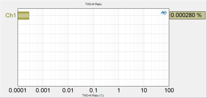

Note the dramatic difference in dynamic range and resolution between 16bit and 32 bit sources. This illustrates the advantage of listening to high-resolution media sources over 32bit I2S interface, compared to CD quality media / SPDIF.
Even 16 bit and 24 bit sources benefit from the 32bit I2S interface. The full 32 bit range is used when software volume control or DSP processing is applied. OS X does not support Integer modes, the internal Core Audio processing is 32bit float. On OS X Lion the 32bit I2S range is used practically at all times.

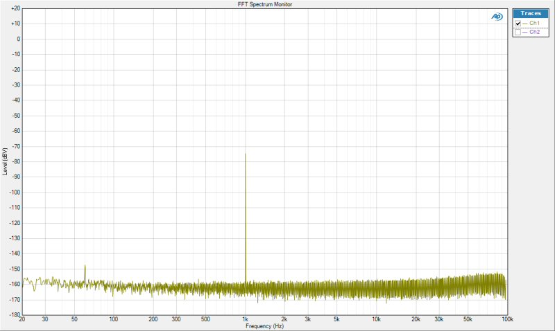

I particularly enjoy measurement No.9. You can see -80 dB signal resolved around 80dB above the noise floor.
3. THD+N Ratio exaU2I 1k 192k 32bit float 0dB (20kHz AP BW).jpg36.4 KB · Views: 348

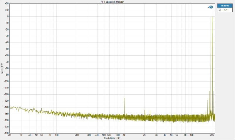

7. FFT exaU2I IMD 19k-20k 0dB 192k 32bit float BW to 22kHz.jpg53.3 KB · Views: 340
exaU2I-e18-11025Hz-44.1kHz-16bit-0dB-1M-AP-eqripple-4avg.jpg54.4 KB · Views: 138

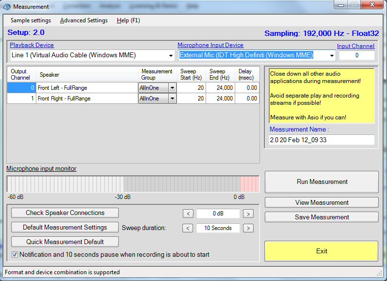

Hello. I am really interested in using the exaU2I as an output for a FIR crossover, and I would love to use something like Audiolense to create a convolver file.
I am using Jriver, and the new version now supports native 64bit convolver processing with automatic sampling rate switching. Also, Jriver can compensate automatically for filter delay, which is great for videos.
Unfortunately, Audiolense and Acourate are supposed to work with ASIO, but I can not get it to work with the exaU2I. Is this a driver issue? Is there anything that I can do? I have searched, and I have not found any solutions yet.
Thank you in advanced.
It appears that Audiolense would not allow you to mix ASIO output device with a WDM input device. You can try to configure Audiolense with exaU2I and the Virtual Audio Cable (VAC) driver. Make sure that for each measurement the VAC input and output sides are configured to work at the same sampling rate as Audiolense.Hello. I am really interested in using the exaU2I as an output for a FIR crossover, and I would love to use something like Audiolense to create a convolver file.
The VAC configuration guide is here - exaU2I DB - Installation and Configuration of Native Windows and ASIO Drivers.
Thank you very much for your quick response. Does this mean that if I were to be able to find a ASIO sound card, with an audio input jack, I would be able to use the exaU2I directly in the software?
Also, would there be any disadvantages by using the VAC method?
Audiolense is limited to 192kHz. Perhaps you can ask the developer to enable 352.8 and 384 kHz.
