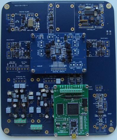

Very nice. :-D
So is this the e18 DAC, or something else? :con fused:
Thanks! As I've mentioned, the measurements are taken with our first DAC prototype, code-named the BlackDAC. The BlackDac was produced before the exaU2I and it was never released. We have several units and we use them for experiments.
e18 has a different built-in USB to I2S interface and cannot be connected to the exaU2I.

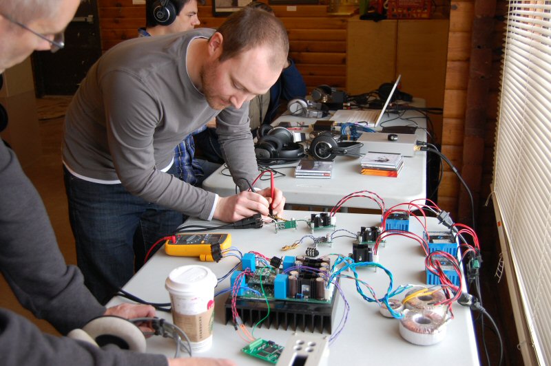

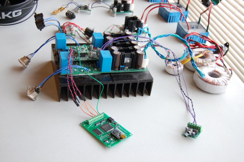

Earlier this month I attended the DIY Ottawa Winter Fest. It was a real pleasure to meet this great group of seasoned DIYers to talk about, and listen to their creations. I am building two of OPC's Wire amplifiers and I had the opportunity to meet him and to see his work.
The pictures: exaU2I connected to OPC's NTD1.

Looks great! I am still waiting to have my NTD1 finished as it is a very complicated build (including an EXAU2I 😉 ), did you have a chance to hear how it sounds?

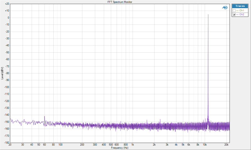

XMOS causes 2.5 ns Jitter?
Here is an interesting post by JarekC:
http://www.diyaudio.com/forums/digi...pdif-converter-24bit-96khz-2.html#post2921904
It appears that according to Larry, an XMOS employee:
" any external clock is resampled to 400MHz
If you tie I2S signals BCLK LRCLK and DATA to a low-jitter external
clock on the XMOS device, this will introduce a jitter in the order of
one to two 2.5ns (400MHz) cycles"
XMOS causes 2.5 ns JITTER? I will investigate this further.
108 ps jitter vs. 2500 ps jitter
Isn't it 4 times better than 10 ns that ES9018S chip has in its asynchronous resampling processing when you use 100 MHz oscillator for asynchronous MCLK?
Isn't it 23 time worse than the 108 ps worst-case scenario jitter of exaU2I? Actually our estimate for exaU2I is 40ps.
2.5 ns is horrible 🙂
