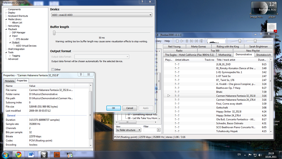

Now I've discovered an odd thing when playing with the U2I. I have two files at 352.8Khz 32 bits and I didn't even considered playing these in foobar without a sample rate converter. Now I accidentally played one in foobar and guess what, I was hearing music. Now how on earth is this possible?? AK4396 can play higher sampling rates?? How? I am all settled regarding the 32bits matter, I am sure the chip is ignoring the last bits. Still, what about the sampling rate?
Now here's another funny thing: I also have some 24 bit / 352.8 files. And these are playing also, only that it's also coming with a terrible hiss noise. The only difference I get in Foobar is that when playing the 32bit ones it says PCM (floating point) followed by bitrate and sampling rate.
Any ideas on what is happening?

SunRa, we need to investigate.
The most suspicious issue is the floating point. The exaU2I ASIO driver supports only Integer formats. Can you provide screen-shots of Foobar reporting floating point? Is it reporting floating point source file or floating point output? I would like to see the Foobar Status Bar and the media properties pane during playback. Please verify that there are no DSP plugins loaded. Check also the settings window - Output Settings. When ASIO output is selected the drop-down for output format should be blank and disabled. The ASIO driver takes over the control of the output format.
You may be discovering something here. If your Foobar configuration is correct and there is no implied re-sampling than.... your DAC may be more capable than expected.
We also experienced noise and distortion in some modes during our initial tests with ES9018. I would like to play the same 24 bit / 352.8 files with my DAC. I should test with the exact same Foobar settings as you. This will allow us to narrow down the root cause of the noise problem.

Here's the screen. I also can confirm the same behavior with the JRiver Media Center. Oh and I have no DSP that can affect the sample rate of the file.

Your setup from the screen shot is correct and identical to mine. When I play Carmen in the original WAV format I also have the (floating point) notice the way you do. This is the source format. Normally I listen tho this piece converted to WavPack, which is Integer. That's why I never noticed the message.
I trust Foobar, J. River and exaU2I, so congratulations! You made history! You are playing 352.8 kHz.

I've noticed on your screen shot that in the Foobar toolbar you have a little visualization effect - Spectrum. It consumes lots of CPU resources at 352.8 kHz. Depend on the CPU you are using it may be beneficial to have it disabled.

Well, the LED indicators seem to tell that's 352.8K I am playing alright. I'll take a closer look tomorrow on this. It would be great checking this with an oscilloscope, maybe I can find something within the DIY community here in Bucharest.
The 24 bits files causing the noise are from HERE the bottom half of the page. When playing these through cPlay (downsampled to 192) they are OK.
Can't tell why the 32 bit files are crystal clear and all of the 24 bit files are making that hiss in the background.

Hi SunRa,
I checked my DXD 352.8k/24bit files (23 albums) and all are PCM integer and plays without any kind of noises.
If you have a pointer to where the 32 bit files can be downloaded I would like to test those also.
I will also convert some DXD files to floating point format and check what happens then...
Have you checked the input data format your DAC chip defaults to?
You should be able to change between several formats...
As your DAC only uses 24 bit of the 32 bits that are clocked in each word clock frame it is possible that there are some misalignment like left vs. right justified etc..??

Thanks for your input. The DAC is set to I2S compatibility mode, I don't believe there's a problem with that.
Any other lower sampling rate files at 24 bits play well, without noise. Only the 352.8 from the above link are having that noise. The noise is not evident when playing through cPlay and downsample the files to 192Khz (real-time). And yes, foobar tells me that these are integer files.
As you can see in the screenshot the 32bit files are floating point. And they also play well. Is it because of the bit rate? Is it because of integer/floating point? None of this makes sense because all the other integer, 24 bit files I have play without noise.
So it must be something in relation with all these three aspects: 352.8K sampling rate, bit depth and maybe floating point/integer.
I plan to diether the 352.8k 24 bit files to 32 bit files and check what happens. I also plan to convert the 32 bit files I have to 24 bit and also play with WavPack. I'll tell you more about my findings.
