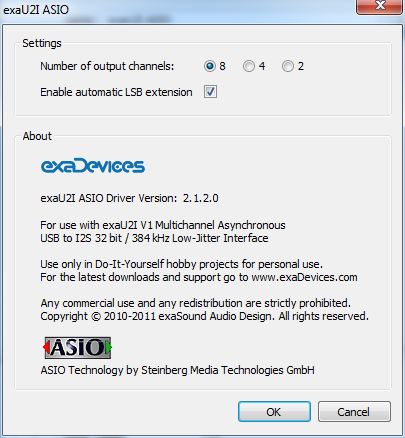

Due to the change from 32FS (pure 16 bit) to 64FS clocking to allow for bit depths above 16 bit the Philips and Sony people obviously was stuck with a dilemma...
They had basically two options as I see it:
1. Revise the I2S specifications for proper operation.
2. Revise the I2S specifications in a quick and dirty fashion and allow for easy operation of 16 - 32 bit transmitters and 16 - 32 bit receivers at the cost of accuracy..
They selected option 2 and if these I2S specifications are followed the true fidelity are compromised.
I was for many years able to avoid the problems by only playing 16 bit sources and only use pure 16 bit DAC´s as this is the only combination that avoids the I2S specifications errors.
With 24 bit sources and 24 bit DAC´s and 32 bit sources and 32 bit DAC´s the problems are also avoided.

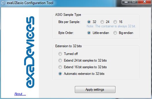

But to be able to play 16 - 32 bit sources with a 32 bit DAC as the ES9018 the sender side needs to correct the I2S specifications errors for bit depths between 16 and 32 bit.
Due to most music are available as 16 and 24 bit the correction can be implemented in 8 bit steps..
exa065 / exaDevices developed a version of the ASIO driver that implemented the correction options after my request.
As they do NOT use a general available ASIO driver, but have developed their own ASIO compliant driver that have full control from the player application to the registers in the DAC they could implement my requested changes at once.
A exaU2I Configuration Tool to manually change the setup was made for the beta testing and measurements in a controlled environment.
This exaU2I Configuration Tool are not available to the public as the ASIO driver now have included a check box for selection of the automatic LSB extensions corrections.
Screenshoots of both the exaU2I Configuration Tool and the ASIO driver configuration screen are attached.
In the finalized version the automatic LSB extensions (when selected) requires a bitperfect source.
If the volume control or any other manipulations are used (DLL´s, pluggins etc.) the LSB extensions corrections are automatically turned off as it will only work as intended with bitperfect sources.
The screenshoots are from the latest versions of the Configuration Tool and ASIO driver.
The updated ASIO driver will be available from exaDevices as soon as they have finished the quality controls.
I have been using a SDTrans192 SD card player as my primary audio source for a period of time and also this device have implemented the automatic LSB extensions.
The firmware (SDTrans192) was first done as a paid job exclusively for me, but became a standard of the SDTrans192 later.
When the users of exaU2I have installed this new updated driver there are very easy to check or uncheck the automatic conditional LSB extensions in the ASIO driver configuration panel as shown in the attached screenshots.
For those that wonders if there are any improvements in the fidelity the answers are simply yes.
Most of the harsh "digitalis" distortions are removed and everything in respect of fidelity improves.
I expect there will be posted reports as the exaU2I users have installed their devices and upgraded the ASIO drivers..
When working with exa065 on the new ASIO drivers I became aware of the fact that when the exaU2I are configured as a 2 channel device the L & R channel are repeated on the three remaining I2S channels.
This makes it very easy to connect a ES9018 DAC as there is no need of tweaking with register settings to utilize the ES9018 as a 2 channel device...
Published with permission from exaDevices 🙂
