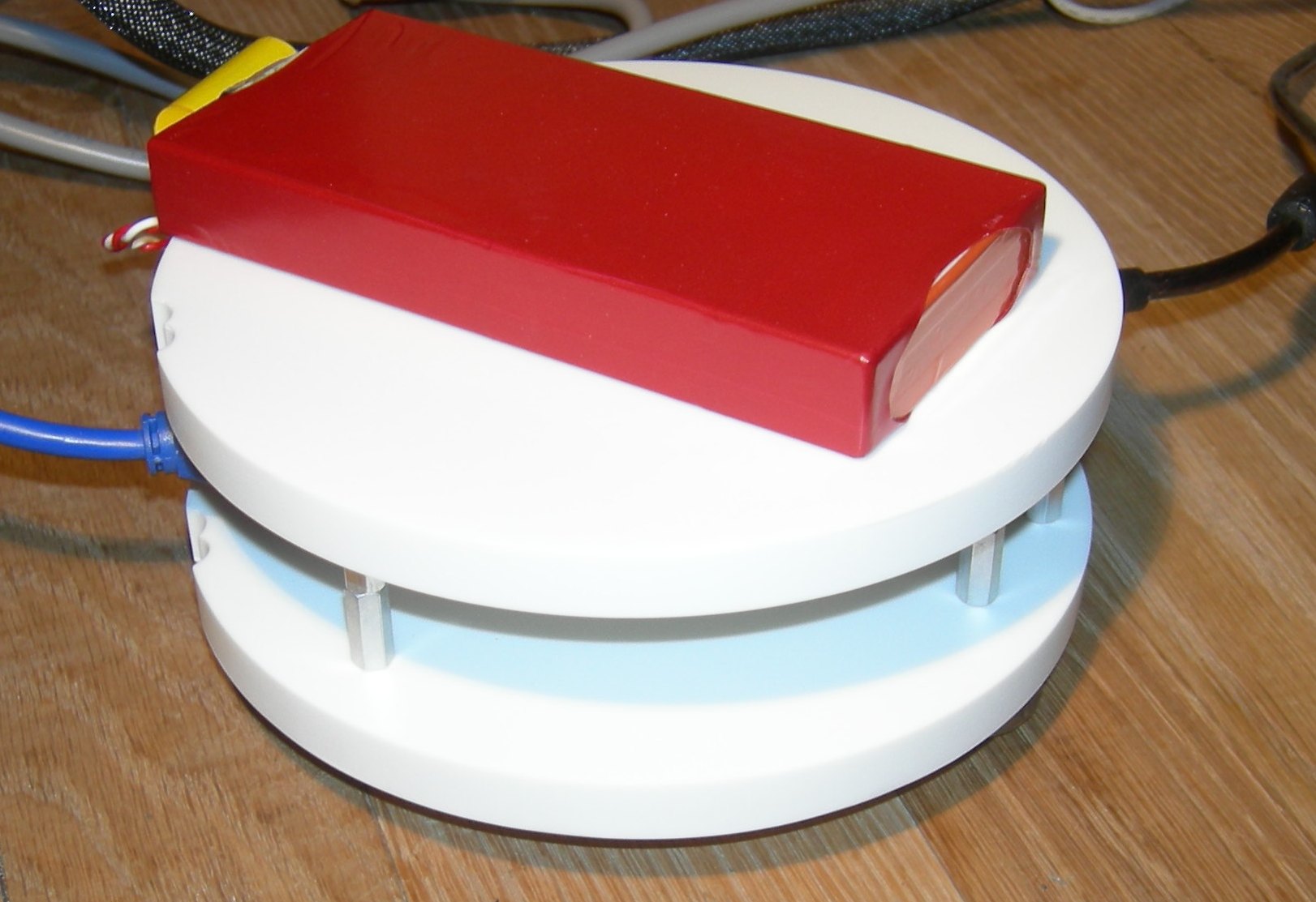

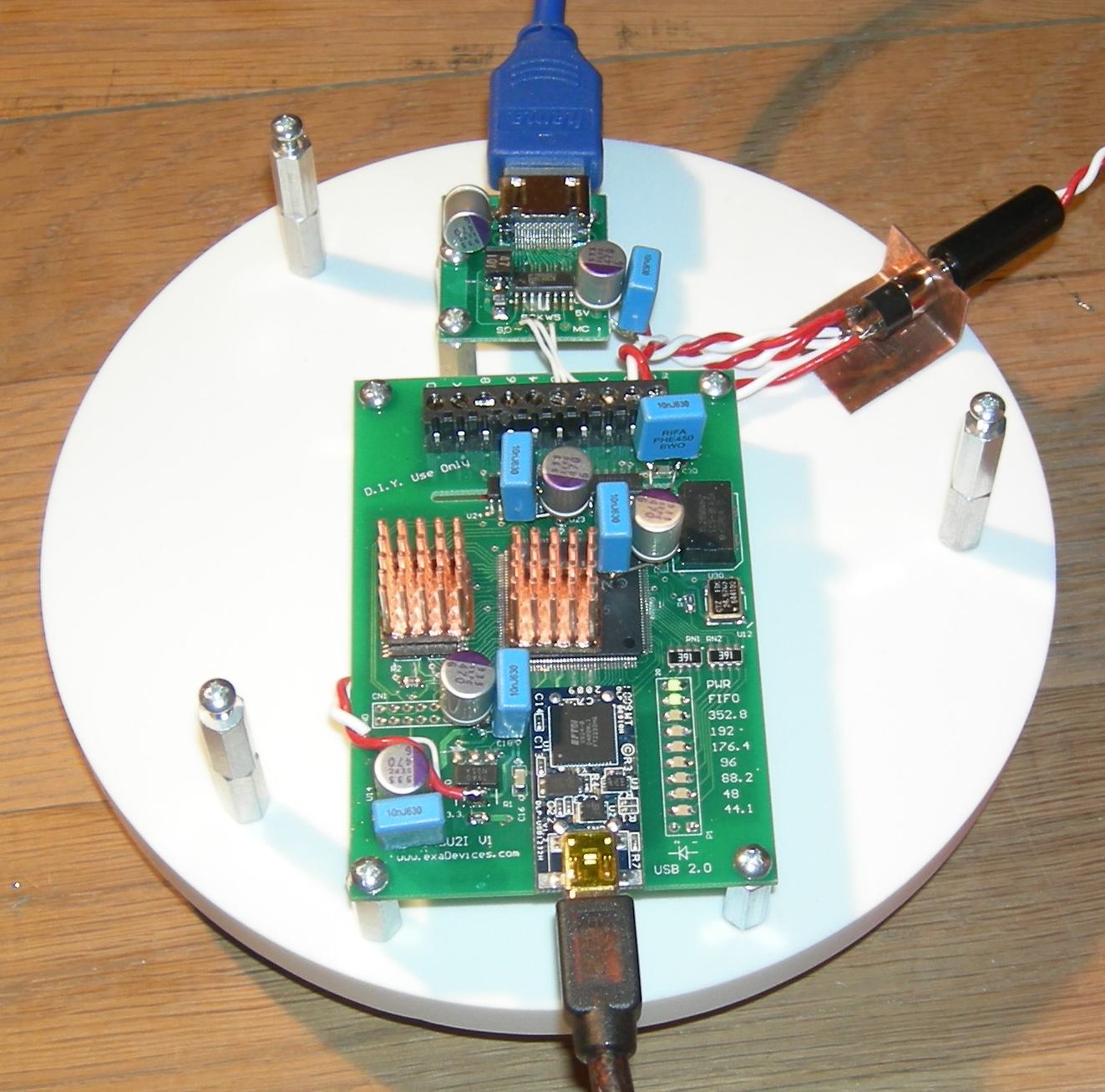

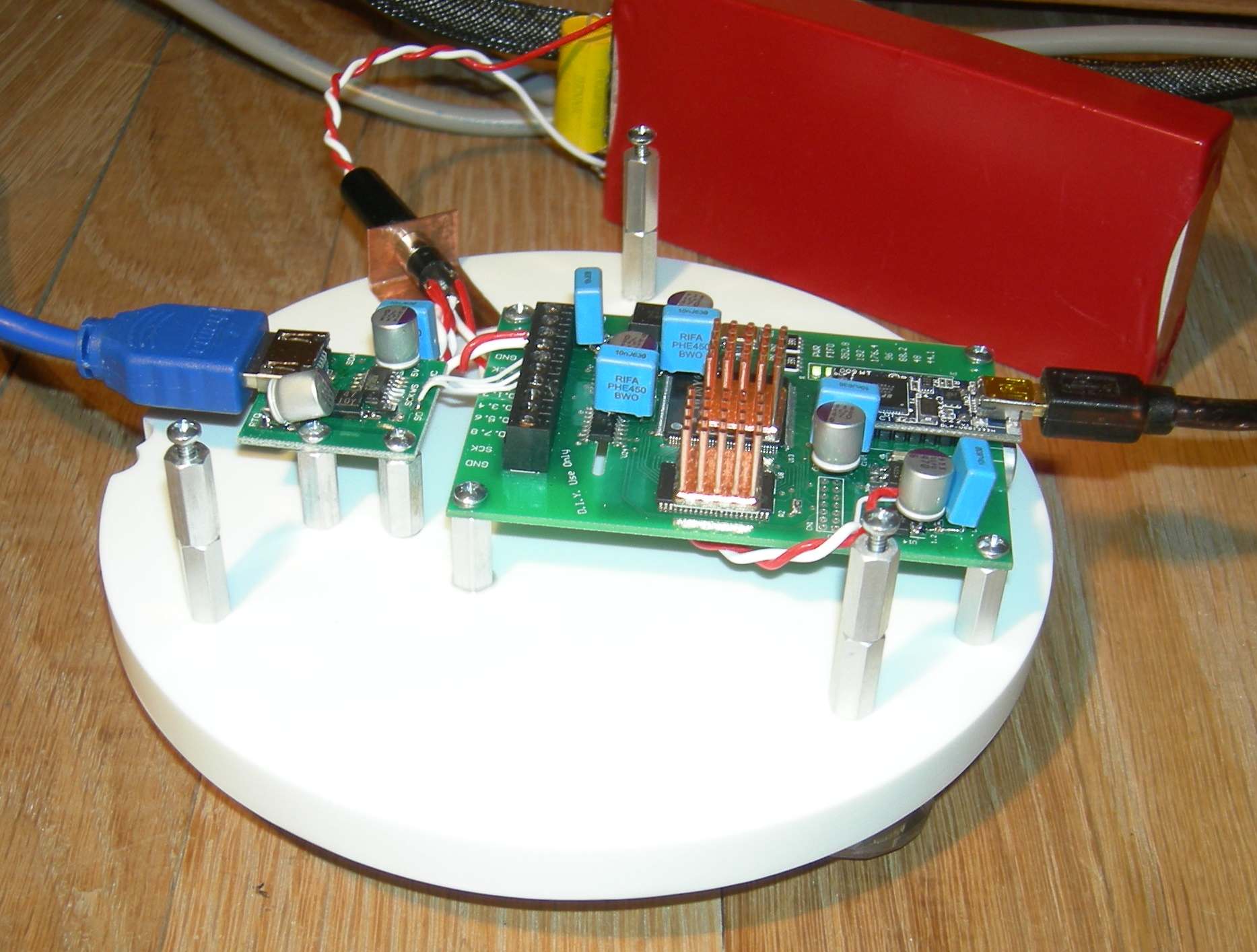

Tweaking of the exaU2I...
Since the exaU2I are a DIY product I have made an easy to change / modify setup and I have tweaked the exaU2I in several ways just to check if the already excellent performance of the standard product can be tweaked further.
The attached pictures are some days old and I have since then reconfigured and are evaluating other "upgrades".
The setup in the pictures have a Corian base and top and the 5 volt USB voltage are disconnected and the FPGA, clocks, GMR´s and LVDS are powered by LIFEPO4 battery.
The difference in fidelity between the standard exaU2I and the tweaked exaU2I (pictured) and the current tweaked exaU2I are not very big as the standard unit performs excellent.
For me every little improvement are of importance and my setup will be tweaked until there is no more to gain 😀

In my setup the differences are easily detected and the exaU2I stays connected to the NEC USB 3.0 controller 😉
This is certainly wonderful but can you suggest any reasons why an async, galvanically isolated device should be sensitive to the type of interface. I also tried async usb with the vain hope that it will eliminate cable and port effects but it appears every bit as sensitive as the old 2707 isochronous chip.
I believe the answer may simply be "noise" of all kinds.
Of course there are also many other issues that will have impact,
but reducing noise in power supplies and reducing the noise the power supplies sends back to the mains have always improved my setups.
I have never been able to reach a level where the improvements stops...
You could try shunt regulating the 3.3V and 1.2V feeds to the NEC chip if you really want to go to the nth degree - I am thinking of doing this at some point.
