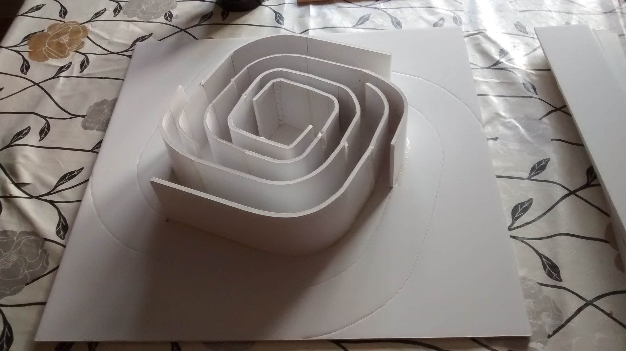

My Cornu's are progressing slowly. I've got one spiral about 2/3rds done. Not the neatest of jobs (I've hidden the worst joints and blobs of glue in the photo 🙂)and burning my finger with hot glue didn't help either 🙄.

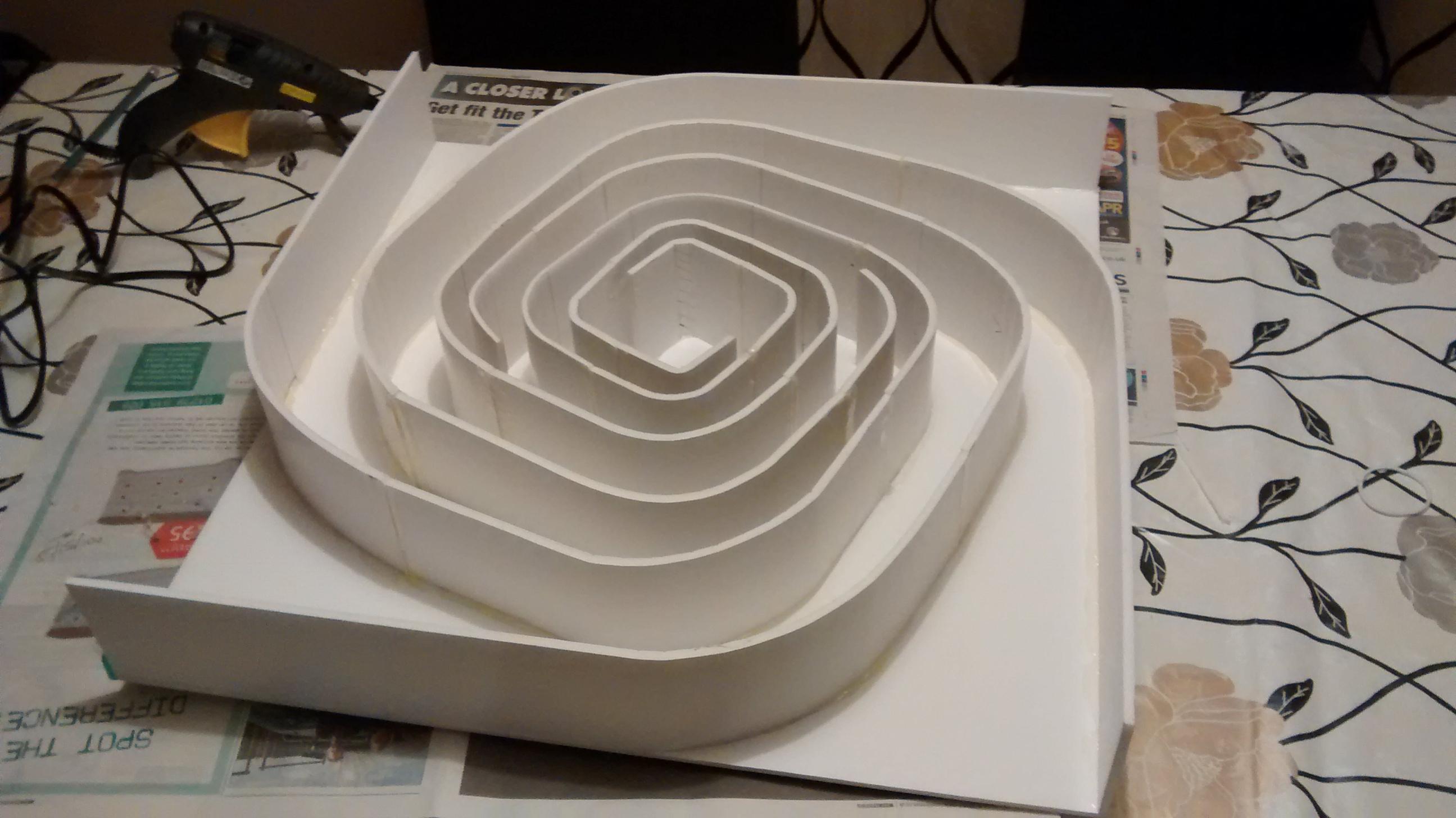

Got one spiral completed late last night. Not the neatest of glue joints in some places, but as it's my first attempt at building one of these and using hot melt glue I'm cutting myself some slack 😉.
Hopefully I'll get some time tonight to get the other spiral built. Fingers crossed it'll go a bit quicker as I've learnt from my mistakes on the first one 🙂
Oddly my wife commented that she really liked the spiral pattern and it would be a shame that it was covered up when the speaker was completed, which is the most positive thing she's ever said about any of my DIY speaker projects. Let's hope the positivity stays once they're on the wall playing music 😀

Blaides, It looks like you spent enough time to get it right. From here we can't see anything wrong with your joints and gluing, it looks just fine.
Burning your fingers with hot glue is a right of passage. You're now one of us.

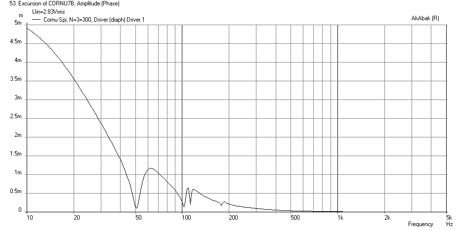

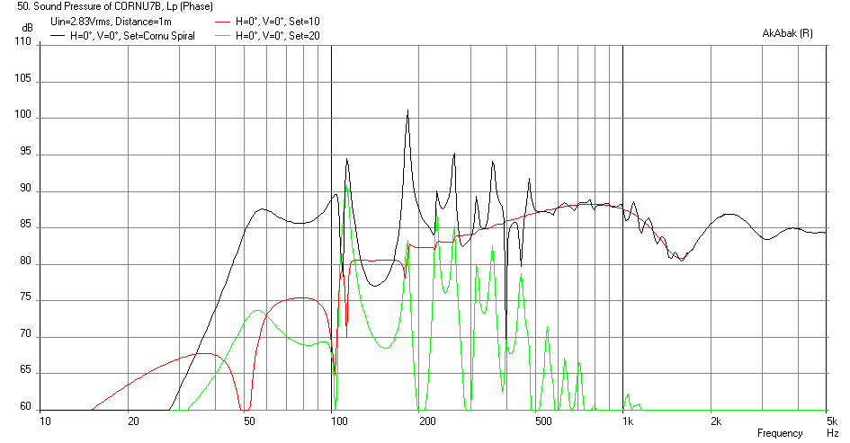

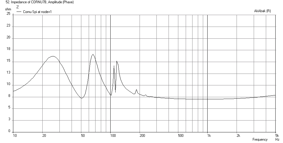

You are one of the lucky ones who has such a nice driver. The Eikona's are very special drivers that deserve a special Cornu. If you want to fully utilize the Eikona's capabilities, I recommend an extra large but thin Cornu that is 34 in x 4 in deep - that will give deep bass extension down to mid 40 Hz while keeping the sound balanced. Because of the large size, I recommend you make the front and back out of thin 5 mm plywood and use foam core for just the channels so that they can be curved and glued. Use stuffing in the main driver chamber and loosely stuffed in the horn channels leading from the throat to the bifurcation point. Put the stuffing in a porous cheesecloth "sock" with a string tied to it on both ends so you can pull it out to adjust amount of stuffing inside the sock, and pull it back into position.
Here are the results of the simulation for SPL vs Freq, Impedance, Cone Excursion.
It is important to mount it on a wall at the correct optimal height of 45 inches from the floor (adjust to taste but start there).
Good luck!
X

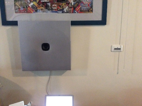

I needed a sweet little project to take my mind off my other experiments... and this was right on the spot as something fun to do and interesting at the same time.
Ran into a couple of problems right off the bat. My driver is not the best little 3" unit, but this was just for fun, so I didn't care too much. Also, I can't get nice foam core around here. The only thing I found was "half" foam core sheets. Basically, take one sheet and cut it in half. One side has paper, the other is foam. Quiet thin as well.
Nothing stopping me, I blew up the pdf and figured a 50x50cm and 8cm deep could work with my 3" driver (Sd is around 22cm2), printed it and made a grid on one sheet of foam core. Drew the patterns and used hot glue to do the channels. Used rockwool as stuffing.
Finished with sealing silicone the top part, installed the little 3" and hung it on the wall.
The construction is too light. It vibrates like crazy, but I can see the potential. It helped my little crappy driver to sound a bit better. Vocals and jazz at low volume were perfect. Daft Punk's Tron Legacy CD was a no-no! Still, it was fun and I think that using thin plywood and a better driver will do it justice.

Nice try there Perceval! Don't give up and have another go at it with the FE126en and plywood front and back with foam channels. You can also try bendy plywood for the channels.
