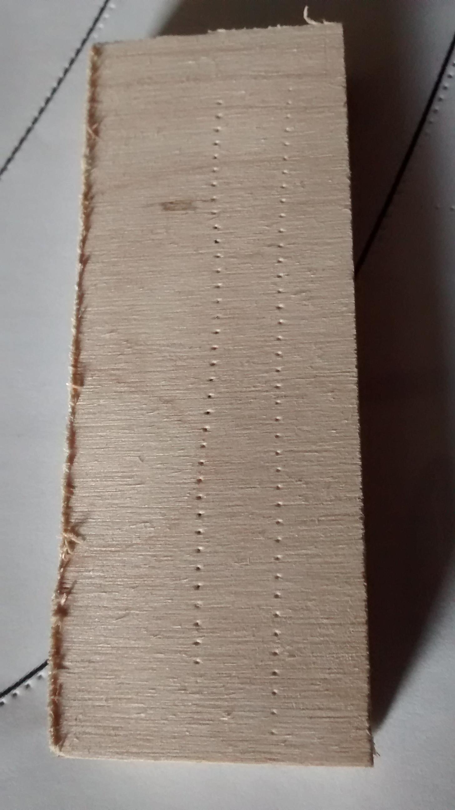

That tracing wheel looks like a good idea. I wonder how it would work on the Sure-ply wood? I remember, about the only frustrating thing with these (I am a very impatient person) was poking those holes to get the pattern onto the wood. It looks like it would do a good job. I also think the indents it creates are actually a bonus for the gluing.
I've got some scrap ply in the garage, I'll give it a bash later and let you know.
I'll admit I'm not the world's most patient person either, hence why I experimented with the tracing wheel as I didn't fancy trying to mark it all out by hand. Plus I thought the rolling motion of the wheel might make it easier to mark out the curves.
If the paper surface had been absorbent or I'd been using depron foam, I saw a technique on the RC forums using acetone to transfer ink from printouts directly to the foam that looked like a very fast and accurate method of transferring templates.

Attached is the result of running the tracing wheel over part of my template onto some birch ply. Not too bad, although you would probably have to trace over the marks. Not sure how long the tracing wheel teeth would last cutting in to ply either. But then they're relatively cheap to replace.
Thanks for trying that. Were you pushing rather hard on the wheel? Is that why it might not last long?
Not that hard, but with a fair amount of pressure and much harder than for the foamboard. Given the extra pressure and the tougher surface of the ply, I just got the impression that the tracing wheel might blunt a bit sooner than when used on softer material.
Having said that I'm sure it would make it through a few templates before giving up the ghost and the one I used only cost ~£2 so when you consider that cost against your time/patience marking out by hand it's certainly worth it.

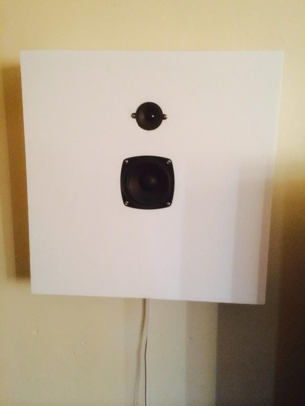

The box on the wall
And the room view
I love them. Now if only the lazy beggars upstairs would get up I could stick some music on again Pfft it is half past seven on a lovely Sunday morning 🙄
Oh and please excuse the dead squirrel on the carpet, it's the dogs.
And the room view
Yes, very nice work there Squiffy. It looks like the 2-way setup worked for you. Did you just use the XO that came with the computer speaker? Also do you have a photo of how the tweeter mounts and how much it protrudes into a channel?
It works very well X. Mounted with just a couple of tiny bolts and little protrusion into the channel of one of the tubes.

Thanks for showing us the details of the tweeter - I think this may really expand on the possibilities for the Cornu for many of us. We may even try bi-amping with a DSP XO 😀

I meant to say that the tweeter has a tiny little pot on the side however the original speakers had an internal power supply with tone balance and volume controls. I thought it might be a little too much to try and fit all of that in the box.
So how are you connecting the tweeter - fullrange direct drive to the main driver or with a high pass capacitor?
I kept it the same as they came out of the computer speakers, two leads direct to the two terminals on the main drivers. Is this the full range that you refer to?
