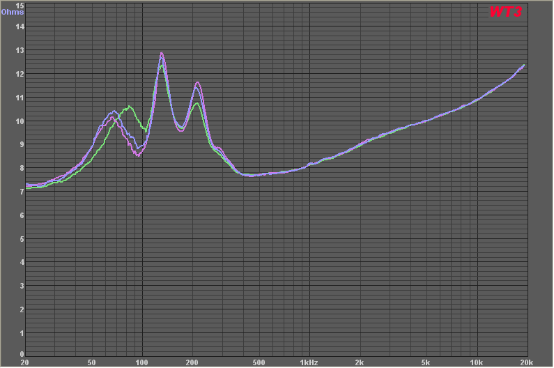

OK, here are 3 plots of impedance. I hope it's legible.
- Magenta trace = no stuffing in rear chamber
- Blue Trace = as much pillow stuffing as will fit
- Green Trace= 1 car polishing rag about 8"x11". A tight fit in the camber.

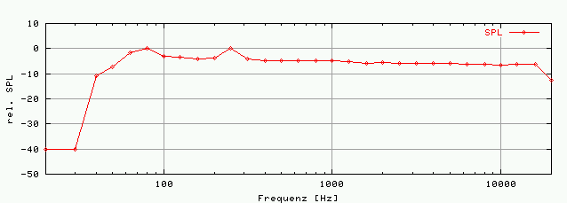

That's not a bad frequency plot, on that page.
I wonder if the fact that Cornu uses divider to make 8 horns makes a difference and allows achievement of a nice measurement like this? It's more likely that the driverVas, xmax, Qts are matched with driver chamber and throat. This would indicate the drivers to use are 'Fostex' like: lower Qts, low xmax, high efficiency deals. 😕
