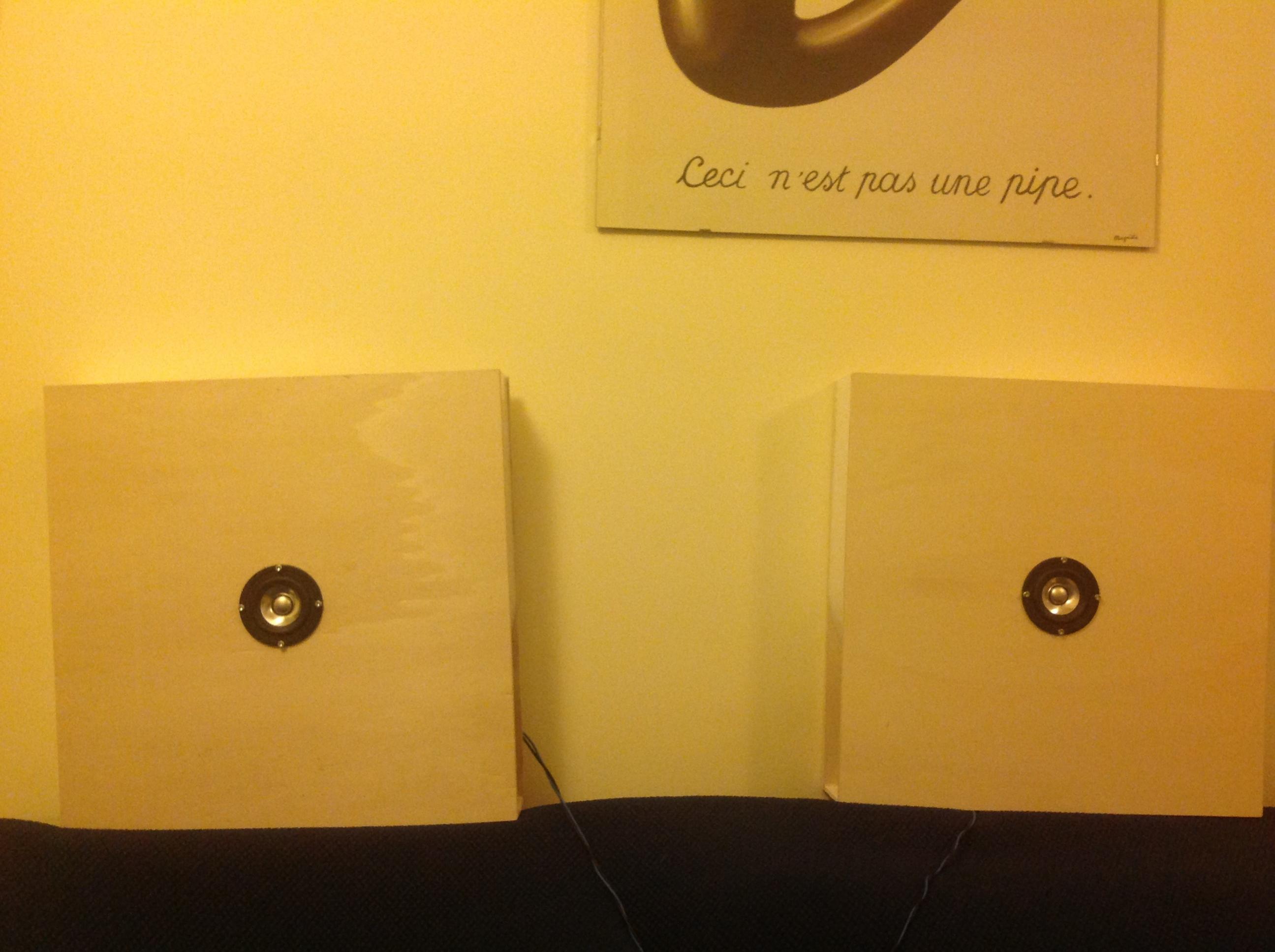

I dunno if my Cornu has issues, or it's just the stuffing. Anyhow, I'd like to get the FR smoother.
To answer an earlier question:
When scaled to 20", the Planet10 PDF gives a mouth size of about 3.75". That's measured from parallel side to side on the section after the first corner. I.E. the first significant straight walls.
