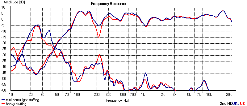

I measured the creation last night. Looks about as bad as it sounds. I do not seem to have gotten the stuffing right yet. Below you see the FR and 2nd harmonic distortion with a lightly stuffed box (blue) and very heavily stuffed box (red). More stuffing made it worse. 🙁
It's really nice above about 1K, but the horn loading is not yet correct. I'll keep working at it to see what can be done better.

Thanks for someone finally doing a real measurement. So, you have not been able to achieve a level of stuffing that sounds good? 😕 How far away are you doing the measurement? One thing about the Cornu Is that it really depends on the room integration of the outputs from the horns to smooth out the output form the back horn and combine it with the direct output of the driver. Try the measurement at least at 3 to 4 meters away - which is where I think it starts to sound really nice. Also, how do you have it mounted - on a wall at ear height or just on a bench?
It makes a huge difference. Good luck and keep playing with stuffing. Loose in first few inches of throat and a lot more in chamber is what I have and I used pillow stuffing.

The measurements were taken with the speaker flat on the floor, thus plenty of "wall" for the back plane. Mic is 2 feet above the speaker cone, which I figured should be plenty. I may be able to go up another foot.
Will continue to work with stuffing techniques. I also used pillow stuffing. FWIW, spiral depth is 2.5"
2 ft not enough for room reflections of horn to blend out.
Try wall mount and back off at least 6 to 8 ft.
If I do that, then the room comes into play. I know that's important to actual listening, but it gets hard to judge the speaker itself. Am I measuring the room, or the speaker?
As measured, the first reflection (ceiling bounce) comes at 18.75ms, and it's down ~23dB.
I'll do some more tomorrow if I get the chance. Will report back here. It's not a bad sounding speaker, just heavy and somewhat colored. I hope to tune it up.
Pano

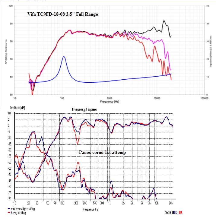

Thanks for sharing.
Is the driver you used the Vifa TC9FD-18-08 3.5" Full Range ?
If this is the one, see the published FR. It slopes at ~12db/oct below 100Hz. Yours slopes at ~24db/oct from there.
This does not indicate a back horn loading.
If you take an impedance sweep, the shape at LF will tell more about what actual loading -if any-the driver is been subjected to.
The deep notch just above 200Hz is for the improper integration btn front and side emitted sound. It has to do with front and rear path lengths and the soundwaves phase relationship at the point they mix (“horn” mouth output).
As it is a phase issue, stuffing can not cure this.
Your distortion plots alone, hints to both inadequate LF loading as well as phase issues at ~ 200Hz.

Thank you for your insight into the interpretation of the plots and how it relates to horn design. The improper horn loading may be from overly simplistic approach of scaling the throats to match Sd alone. As Planet10 has suggested, there is an interplay of the driver chamber volume, throat, Vas, and probably horn expansion to get proper loading on the back horn. Perhaps this is where we can start using the models to try figuring out what the throat and driver chamber volume should be. The front and side emission phase mismatch may also be function of scaling the 70 cm down to 50 cm. If someone can do a measurement on the 70 cm (full size) version to see if it's any better? I fear not, it may be an inherent design "flaw" in the Cornu. We can easily change the throat area, it's harder to change driver chamber volume if it is not big enough. One would have to expand the central box and redesign the spiral from there on out - or add either a hidden small chamber box behind or in front of the main flat box to increase the driver chamber. The spiral lengths would have to be adjusted in length by growth or shrinkage. What's interesting is that even with the response of the speaker as shown here, I wonder why it sounds so good? It must just be the fact that the mid and low bass exits the edges?
Yes George, that's the driver. What you say makes sense to me, and was pretty much what I was thinking. Nice to have confirmation. I'll do an impedance sweep later today.
It may be that this driver and this size cornu are not ideally suited for each other.
As I like the idea of the cornu, I'll continue to pursue it to hear and see what can be found.
