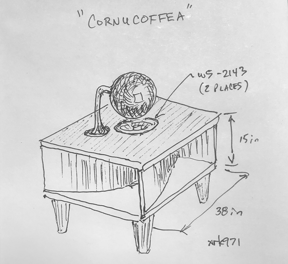

I had an idea for a coffee table Cornu with a 5.25in driver but never built it. 🙂
https://www.diyaudio.com/community/threads/enclosure-for-tang-band-w5-2143.322720/post-6326491

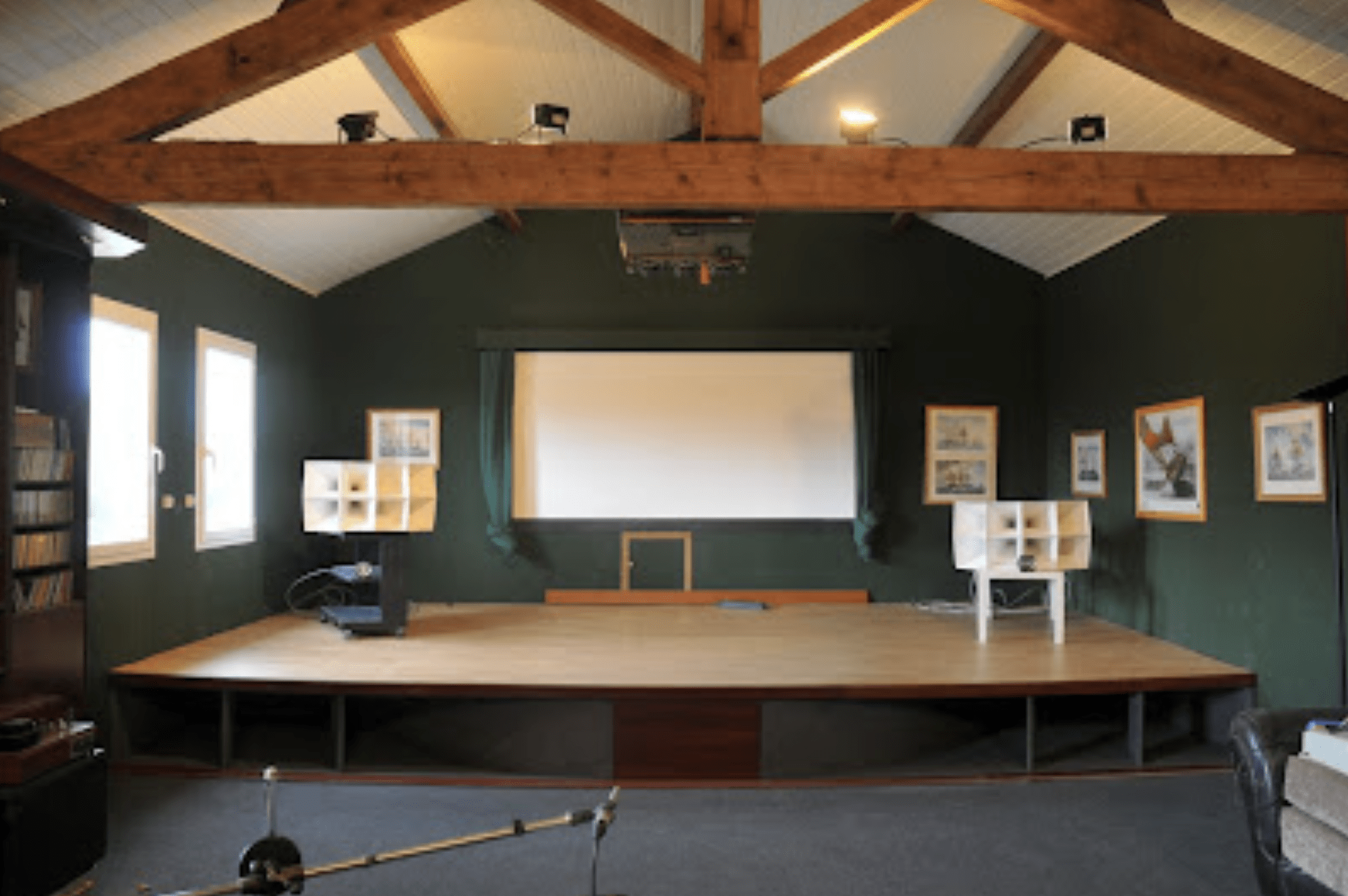

Royal Device, I think that is. “It’s been a minute since I saw that one; IINM the rest of the system was crazier.
Always wondered if you could put the speaker on a short hollow "stem", if only to get a little more distance to the cabinet back wall. Perhaps pronounce the speaker by a few inches, cover the front with a few inches of damping material.You would need to scale up the plans accordingly.
If you "adapted" a larger diameter driver using a conical structure, would that give some "venturi" effect at the right angle transition into the horn ends? This is understanding only the bass frequencies comes out the horns...
yes, Varese is the woofer. A dozen or two of the mains. One man’s dream, come to life. I think it’s a couple decades old now IIRC.Royal Device, I think that is.
