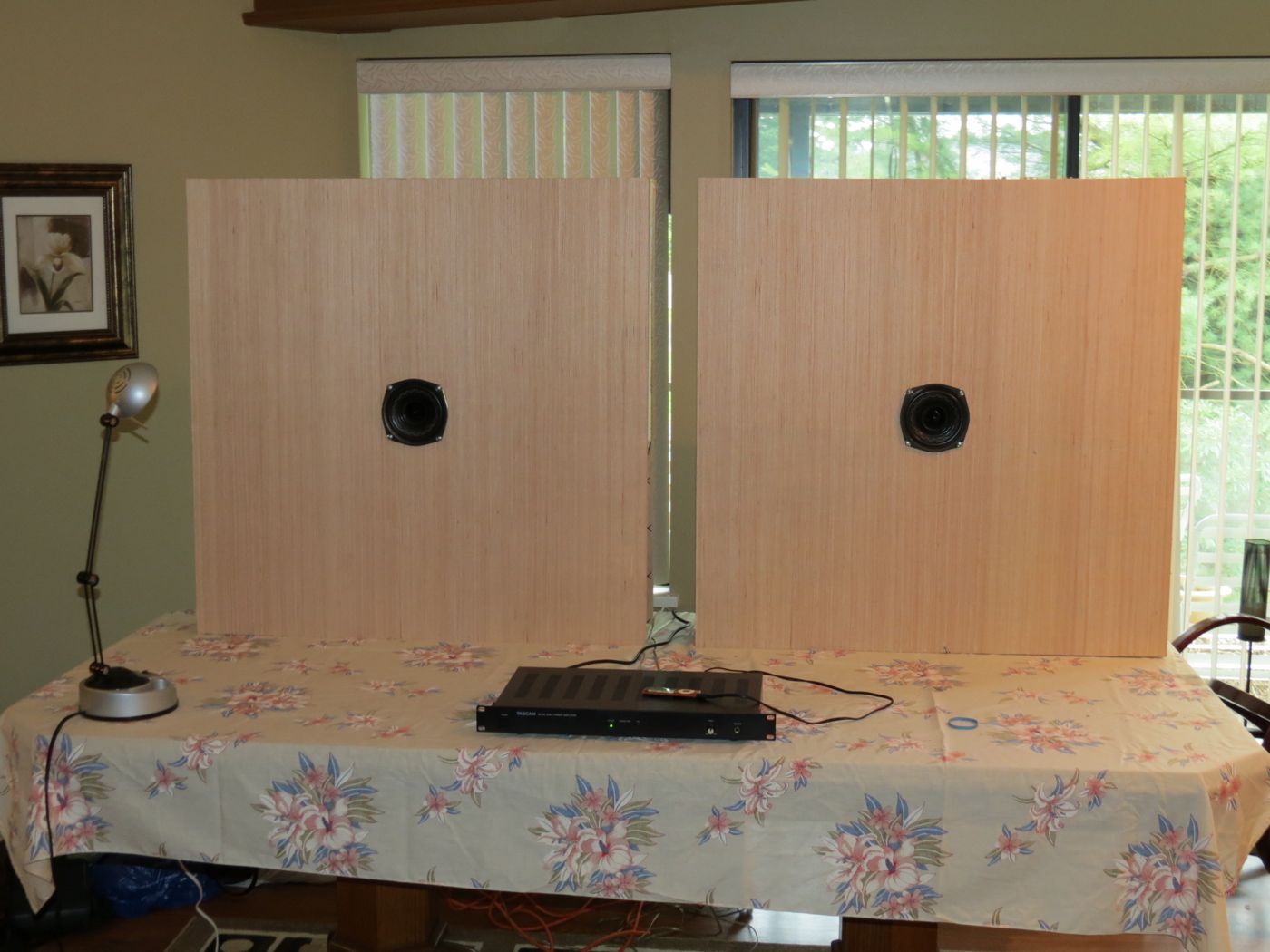

I think Cal made some really big 36in x 36in ones with big drivers (Radio Shack branded Fostex possibly). I can’t remember which. But they were played outdoors at a DIY get together at Planet10’s place.
Great idea for wedding gift. They do depend on a wall to give them the bass. Out in the open I am not so sure how they sound.
I feel like the 28in size with a Faital 4FE32 might be a nice combo. 91dB and good highs and a powerful motor for horn loading.

Thanks X! I was thinking the 28" might be nice as well. Maybe Cal will chime in as well.

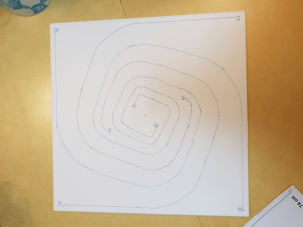

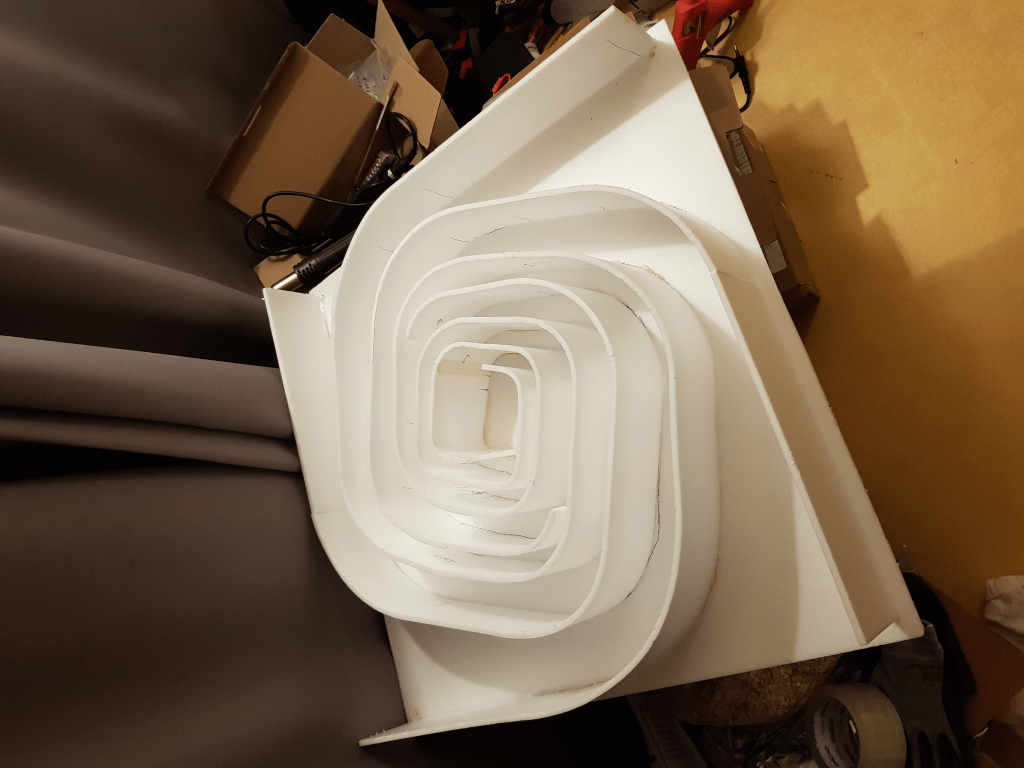

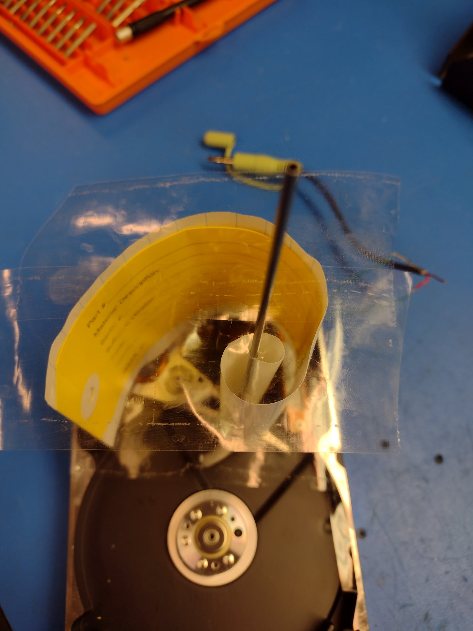

Just wanted to post this for a laugh but also a proof of concept. I've been kicking the idea of a spiral horn loudspeaker around for a while now too and just now found this thread in a google search. But I had a couple of different ideas...
First, what if you made the horn itself the driver by either activating the innermost edge or perhaps a part of the spiral at the 1/2 or 1/4 wavelength. So I mocked up a proof of concept 🤣 with a small tube, an old hard drive connected to a headphone plug, some cardboard, paper, and tape. You can hear sound coming from the bare hard drive, but with the horn on there, the bass response is actually quite surprising when you put your ear next to it. I get full range with great bass! I can tell that it could be better though if the horn was better fixed and the rod better connected to the arm of the hard drive, but for a quick test, it ain't bad LOL.
More realistically though, instead of driving it from the center with the driver on the flat face, what if you put a ramp inside the spiral down to the tip such that the horn was the same rate of area increase as a typical voigt tube/BIB with the driver faced out from the 1/4 or 1/2 wave point in the horn installed in the outer curve? Basically, make a voigt tube with the driver on the triangle side, then set it on the floor long ways, and curl it up with a bigger horn exiting vertically, and the sides become a single curve wrapped up in itself. In this way, the horn portion could create an entire wall of sound. Maybe even tuck the driver inside the spiral (keeping it on the curved wall) such that it interacts with the horn in a sort of single driver push pull configuration and the driver itself doesn't interfere with the sound exiting the horn and you get power from both directions of cone movement with all of it coming out of the horn?
Thoughts? Anyone smarter than me know how that would (or wouldn't) work acoustically?

I’m sorry I am not understanding what you are doing. Using the voice coil of a HD head as the transducer? Where is the membrane?
Maybe a sketch of what you are proposing with a coiled up BIB etc would be helpful. The horn expansion of the Cornu is non linear and has quite an expansion compared to most BLH’s. The area of the driver membrane comes out to a horn area equal to depth of Cornu x perimeter. For standard 28in x 5.5in that is 4x28in x 5.5in or 4312in^2 from a 12.6in^2 Sd of a 4in driver. That’s a 342 area expansion.

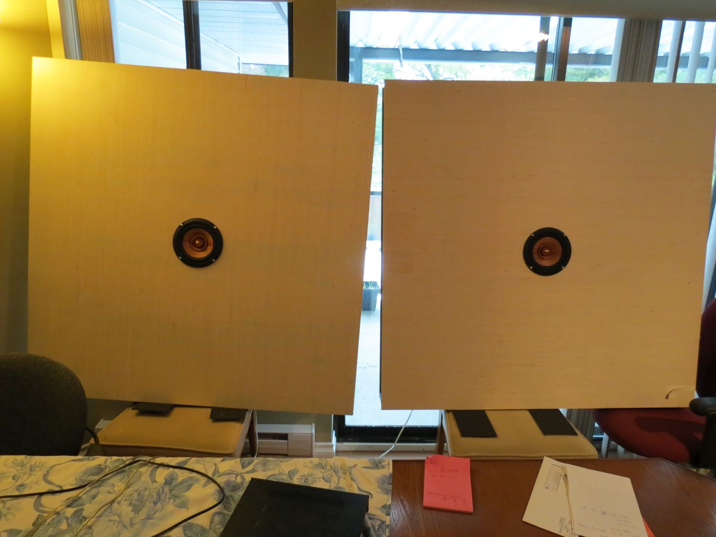

Yes, the 36" were the RS-1354 5.25" drivers. They were quite bassy even out in the open. I made the 48" for aa Airborne 6.5" wood cone driver.
I find the 27" a little too small, with that 'bass hump' a little too high. IIRC it was up around 150 Hz?

Here's a quick and dirty drawing. In the hard drive mockup (not meant to demonstrate the drive, only the horn), I'm using the inside edge as the membrane which is probably not ideal, but I think an electrostatic membrane (or just a normal driver) installed on the curve at the 1/2 wave point like a BIB might be better, but there's 2 horns in one that way because the back radiation uses the same horn as the front but at different points. I was sorta hoping it would just naturally work as it's essentially pumping air with both sides. But perhaps a double horn would work better, or a resonant spiral space within the horn?I’m sorry I am not understanding what you are doing. Using the voice coil of a HD head as the transducer? Where is the membrane?
The signal path between the front and rear of the cone is quite small, so the cancellation pattern starts in an unfortunate frequency range.

I think you have what is closer to a spiral BLH with a spiral wall mounted driver vs a flat side wall mounted driver. Interesting idea and can work but not a Cornu anymore.

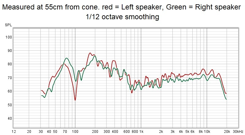

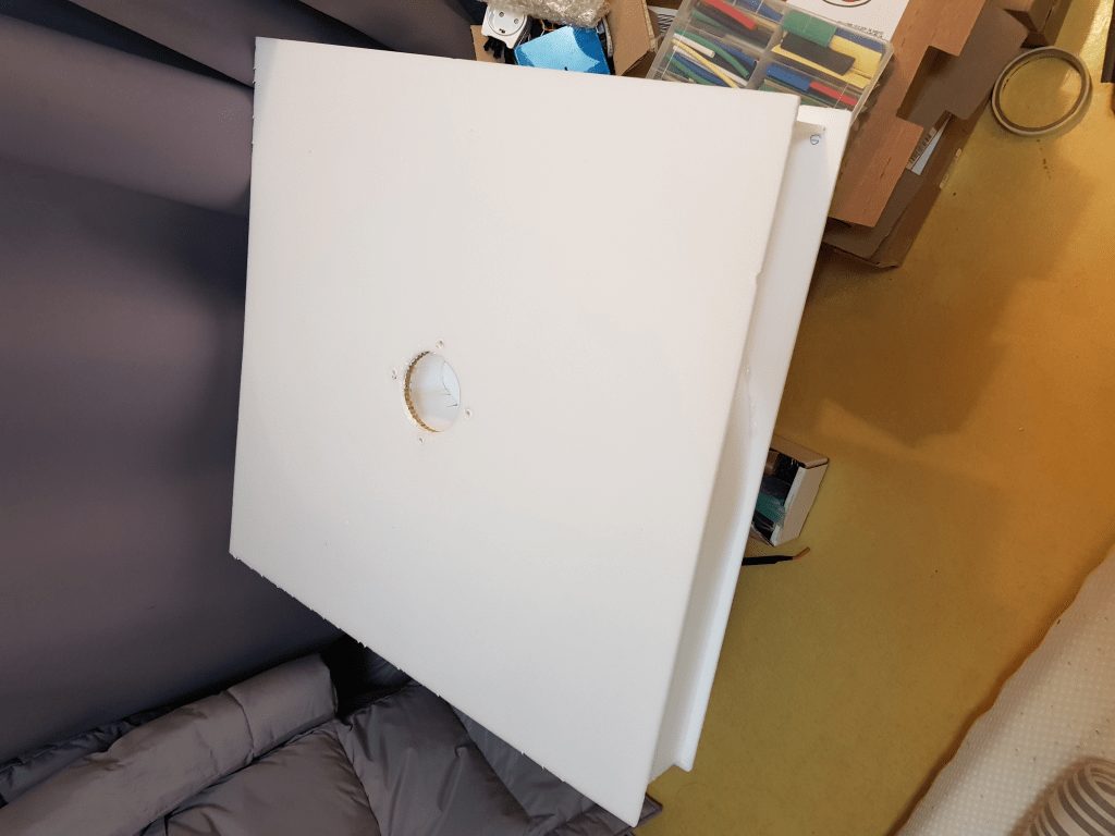

So I finally got around to trying to measure my “Modified Spiral/Large Cavity Cornucopyas”. These are modified from the standard design as detailed in posts #2798 and #2810 (basically much bigger cavity and longer horns).
Using REW V5.20.9 and a Umic-1 and trying to find my way into getting everything set up properly so these results may be completely wrong….
Set up uses laptop headphone output to feed a Cambridge A1 amp (volume 12:00, tone controls flat) then to the Cornu’s that are wedged/roof mounted in the “workshop/shed”.
REW is set up to select laptop speakers (Comcast Smart HD soundcard) with output volume set to 1.0.
Input Volume is set to 0.95.
Output level to -5dBFS.
Output sweep 30hz to 20khz.
Input length 1m 48khz sample rate.
Headroom is reported as ~7dBFS. (various gain settings were trying to get headroom close to ~10dBFS)
Umic-1 is taped to a tripod pointing at the centre of the speaker cone and ~55cm distance. There is a lot of stuff around speakers to confuse room response - its a busy and cramped workshop.
This is the resulting measurement.
Remember this is a 3inch TC9FD18 in a plywood/foam-core box and stuffing was arrived at by trial and error to "sounds good enough". Not sure if most of the stuff below 100hz is proper sound or just the box resonating with the TC9 acting more as an exciter than a speaker – the front panel certainly shakes a lot at the low end.
The test signal was around usual listening level, lower volumes tended to leave the 30-500hz response similar but lower the 500hz plus curve by a few dB.
Although the response is ragged they actually sound quite good.
So – what have I got wrong in the set-up, what else should I be measuring, and any suggestions for improvements to set up or speakers?

That looks great. Your midbass might be a tad high and speaker could use a bit more stuffing until 200Hz is only 5dB higher than 10kHz. That might be more balanced for more genres.

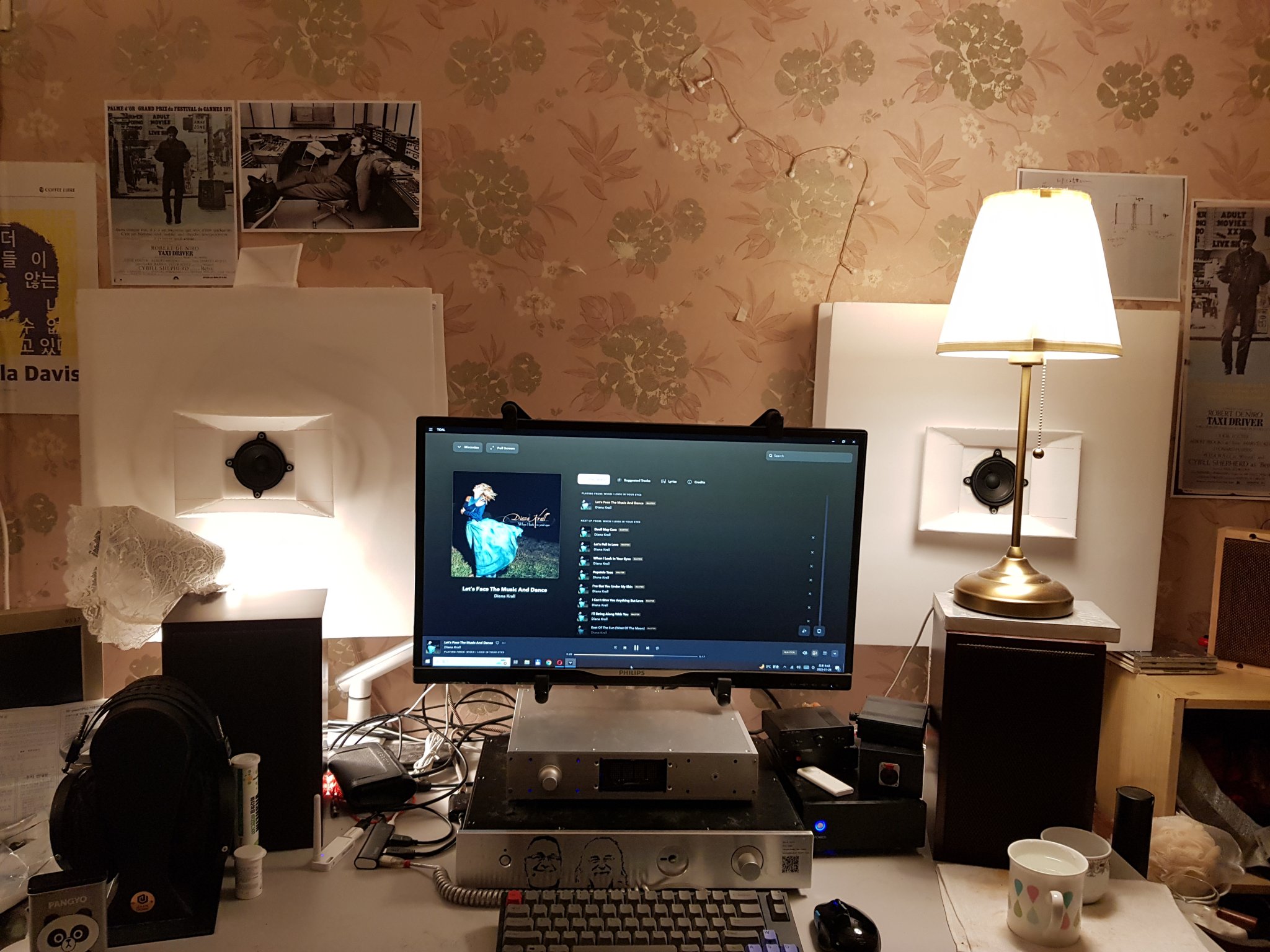

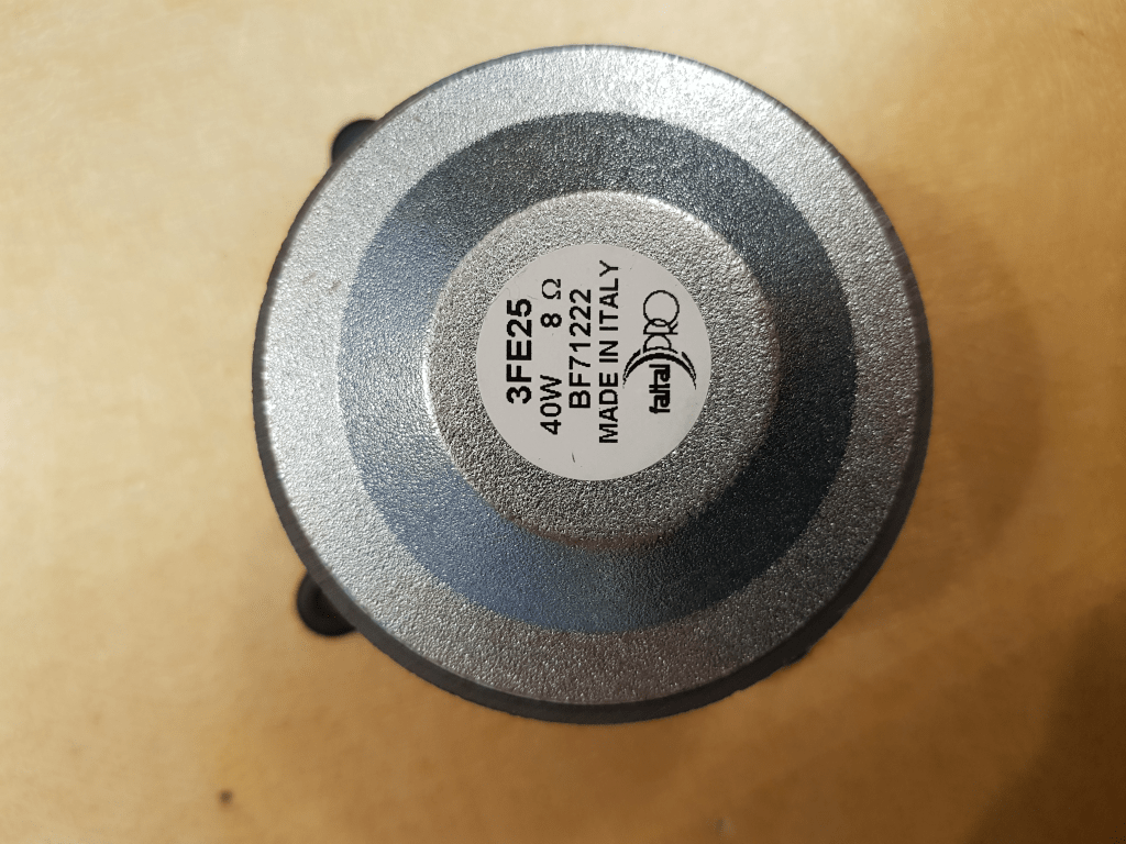

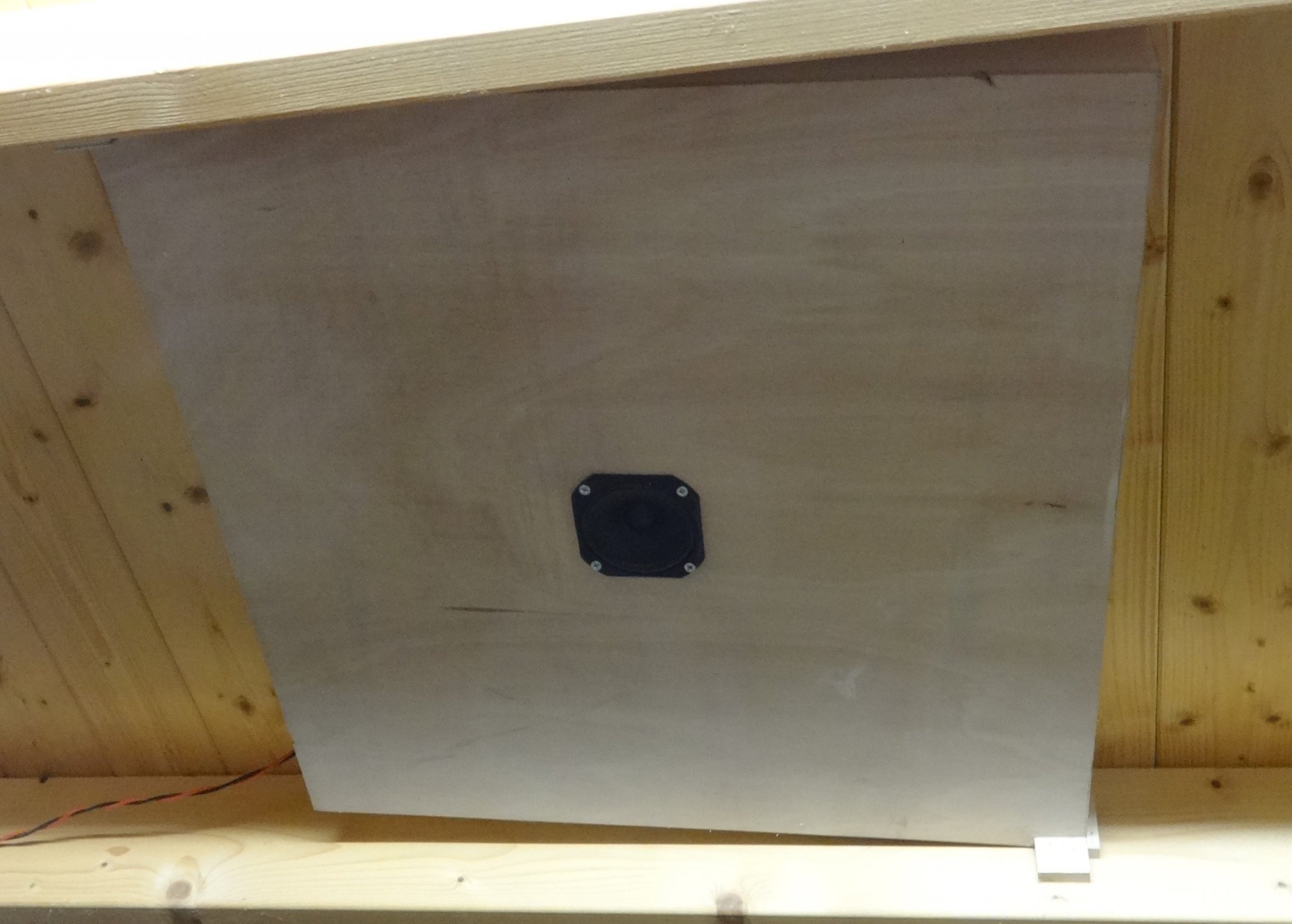

I've built this 56cm x 56cm cornu with FaitalPro 3FE25 a month ago.
It sounds good and comfort.
... more detail, more wide sound stage and obviously
more bass than my SoundArtist LS3/5A.
I can not come back to my LS3/5A.
Thany you for a great speaker.

Can I assume the 100hz dip is a half wave cancellation ?
The actual distance front to back ?
How long is the back horn/line ?
Or is that floor bounce cancellation ?
@norman bates
<- I don't have any analyzing tool.
<- 80mm guide-line height(depth)

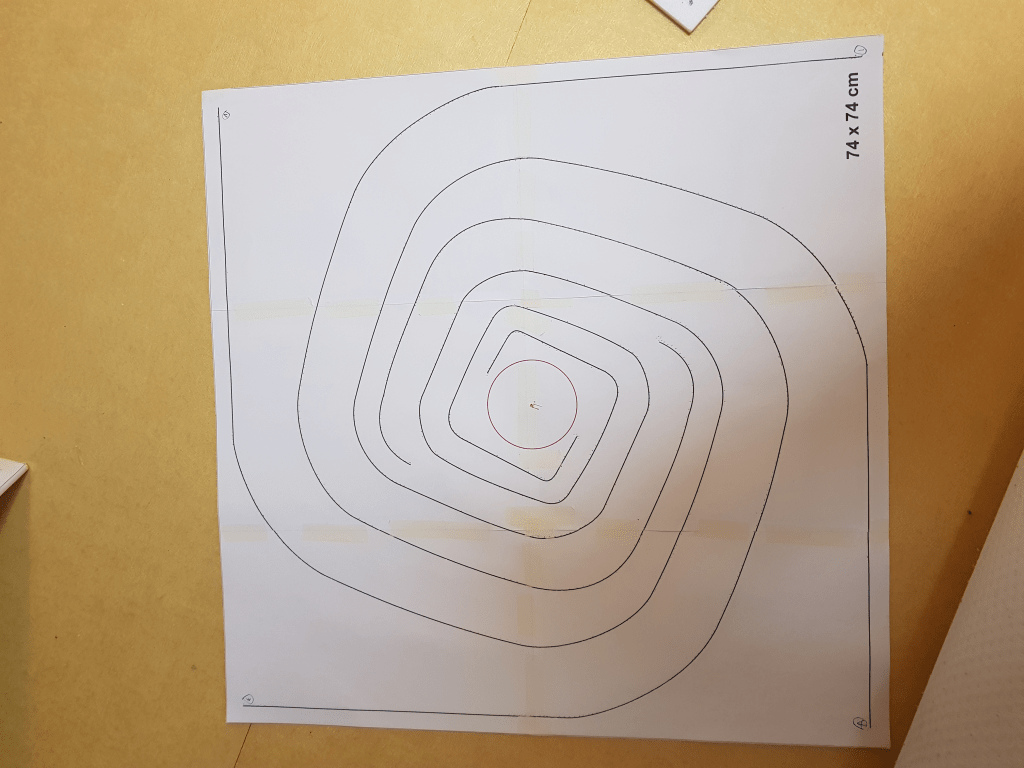

<- Check the attached image. I've scaled down the original cornu pdf document by Sebastian.
<- I don't know the meaning 'floor bounce cancellation', I'am sorry.
