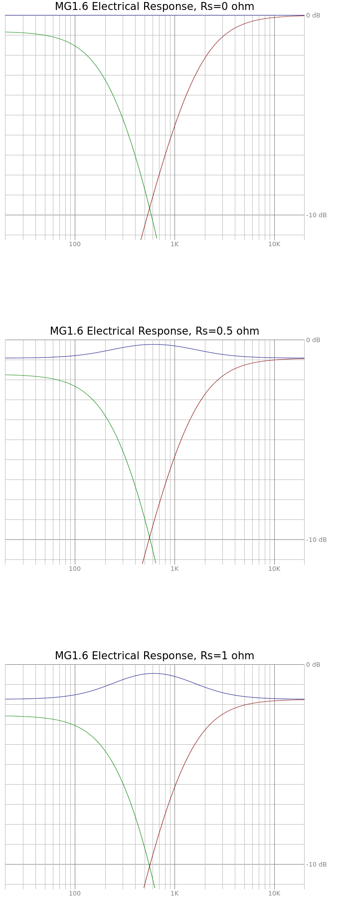

Attached is the response of the MG1.6 crossover with source resistances of 0, 0.5, and 1 ohm. Blue=speaker input, green=woofer section, red=tweeter section.OK, good to know because I don't know how to simulate it, and it would be a handy thing to do. Can you demonstrate the filter shift with changing amplier impedance? What software are you using?
I wrote the software that generated these plots. Spice can also do that.

OK, thanks. The increasing overlap is visible and the resulting bump at the crossover point even more obvious.I wrote the software that generated these plots
Were did you add the extra ohm and half ohm?
I added the resistors in series with the amplifier's output.
The MG1.6 was voiced with a slightly recessed midrange. I found that small series resistors improved the speaker's coherency. The sound became closer to a full-range driver. Too much resistance made the speaker sound like it was playing underwater.

OK, sure. That’s what I do in XSim but can’t get the transfer functions to change. I will investigate further and maybe ask Bill Waslo.I added the resistors in series with the amplifier's output.
