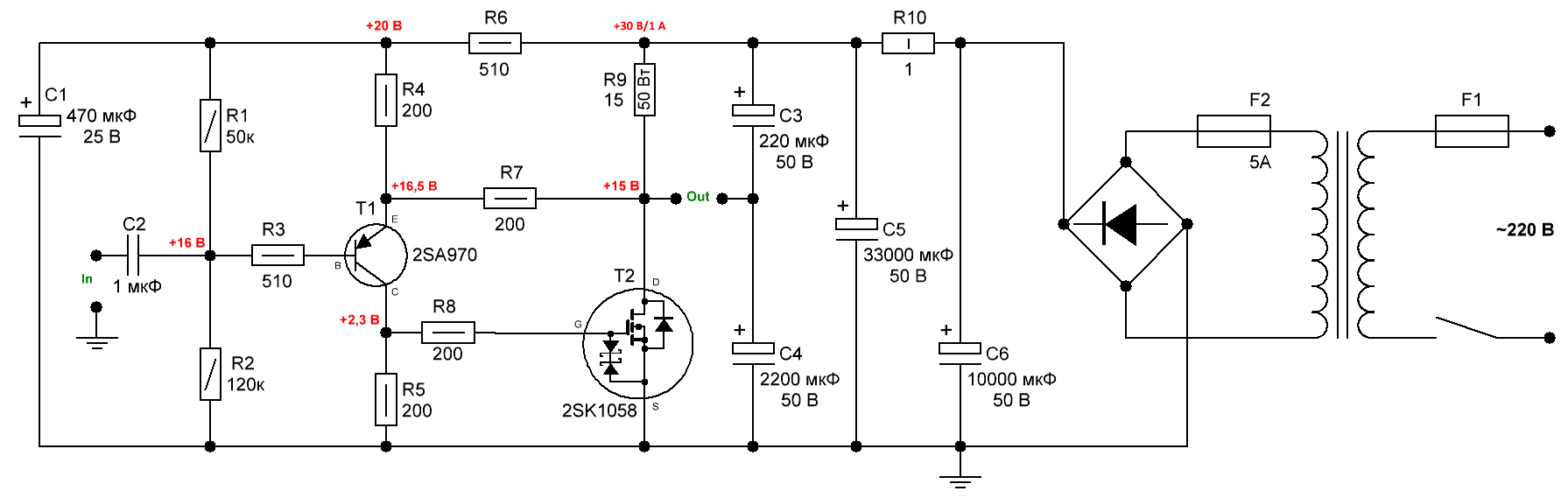

This simple & minimal AB1 two stage A-class power amp is known to many people as 2A3 SET killer , his efficiency is very low , produce just few Watts but sounds just OK in combination with high efficiency 16-Ohm LS , it is designed by Alexander Bokarev (Russia) ,the man with decades long great experience as electronics designer .

Cool design!
Could be, a single output-cap instead C3 and C4 would sound better)-;
Let's say, one created a servo that chased whatever DC voltage is at the drain of the above circuit. Maybe with a 1Hz bandwidth.
Followed by a power stage of some sort; class AB, Class D, whatever; it's effectively a regulated power supply output. Then connect the speaker from the drain to the output of that circuit, sitting at the same quiescent voltage as the drain.
Would the sound of the amp change, because C3 / C4 are no longer conducting AC current?
