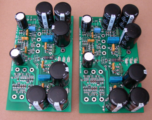

Some pictures🙂🙂

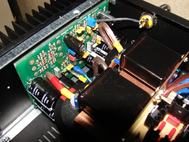

from sparkeey ,,i have looked at your amp pic`s very nice i must say ..on the otherhand i have been building the eti 477 amps mow for 27 years ..i can do it blindfolded... although i have made quite a few with exicons now and was wondering if the 470 pf by pas caps on the drain sorce need to be alterd in capacitance i also changed the gate resistors to 680 ohm and have made a few other mods with the help of ian ...regards brian ..sparkey@hotkey.net.au
