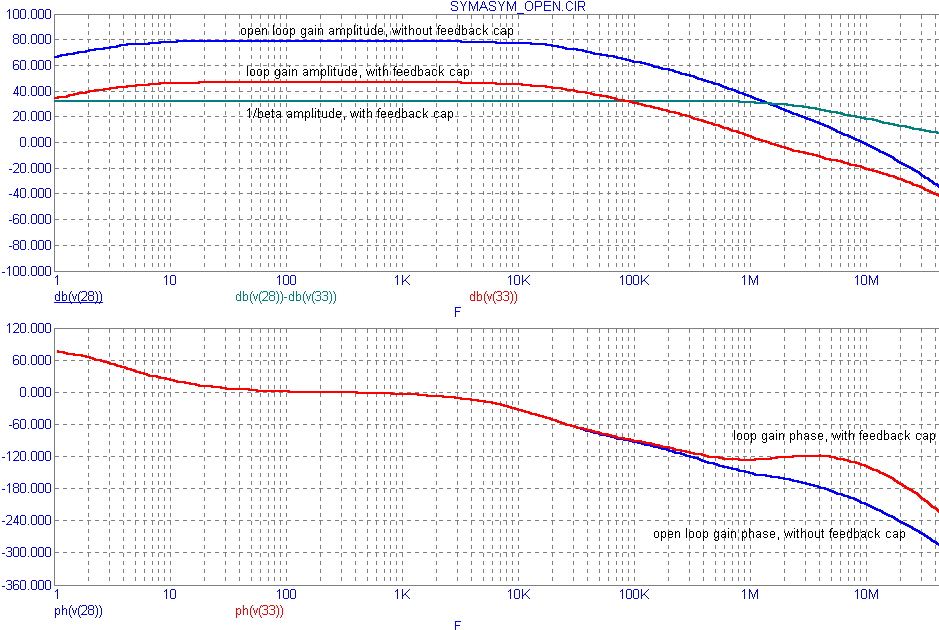

One last plot
So I guess there's some slew rate limiting going on after 1KHz, which makes sense. Below 100Hz I'm probably seeing DC blocking capacitor non-linearities.

Defensive response:
- Input is a JFET pair, so has no base. The gate resistors are within a few percent of one another. Simulation shows absolutely no difference when they're exactly balanced, so I didn't bother.
- A driver would have reduced the quiescent current requirement in the VAS. If I ever build one with half a dozen pairs of MOSFETs, I'll be sure to include one. Again, simulation with two pairs of MOSFETs showed no useful improvement by adding followers.
- Agreed. Compensation was a challenge. I could probably improve the THD at high frequencies by reducing the VAS miller caps and gate resistors (not to mention reducing emitter degeneration throughout), but I erred on the side of stability.

Yes but - in absolute terms the distortion is actually very low above 3KHz. The rise merely implies a diminishing feedback factor which is unavoidable if you want stability. Of more importance is the harmonic analysis of this residual. This also gives clues as to the origins of the distortion rise. With complementary outputs and diff inputs then it's usually 3rd harmonic with a little 2nd and 4th thrown in.
